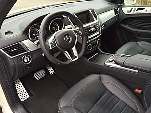

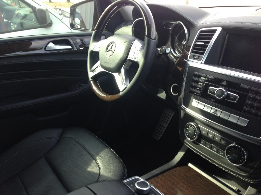

Recently retrofitted the sport Aluminium cover from Amg or sport steering wheel. Figured will post here so you guys know its possible! Everything is a direct swap, install takes about 20 minutes, you dont need to take out the steering wheel off, just disconnect the battery and remove the airbag.
Before:
Sport/AMG Steering Wheel Cover Retrofit-photo_zps95fb513d.jpg
After:
Sport/AMG Steering Wheel Cover Retrofit-ea638707-749a-4611-9b99-07b536c055ac_zpst28runir.jpg
Sport/AMG Steering Wheel Cover Retrofit-a23da033-957f-4008-a15a-485713d614fd_zpsqdsismq5.jpg
Later I will be retrofitting AMG Metal Paddle shifters, just need to take the steering wheel off and trim the hole a bit, the plug for the shifter paddles is the same on all W166 steering wheels

Looks good..interested to know how the a/b releases ?
there are 2 holes on the back of the steering wheel-very close to paddle shifters(not even holes looks more like rips-can barely notice them) basically you stick a screwdriver in there and release the spring, which pops the airbag out. If you search ebay for W166 airbag you will see two springs on the back of airbag.
