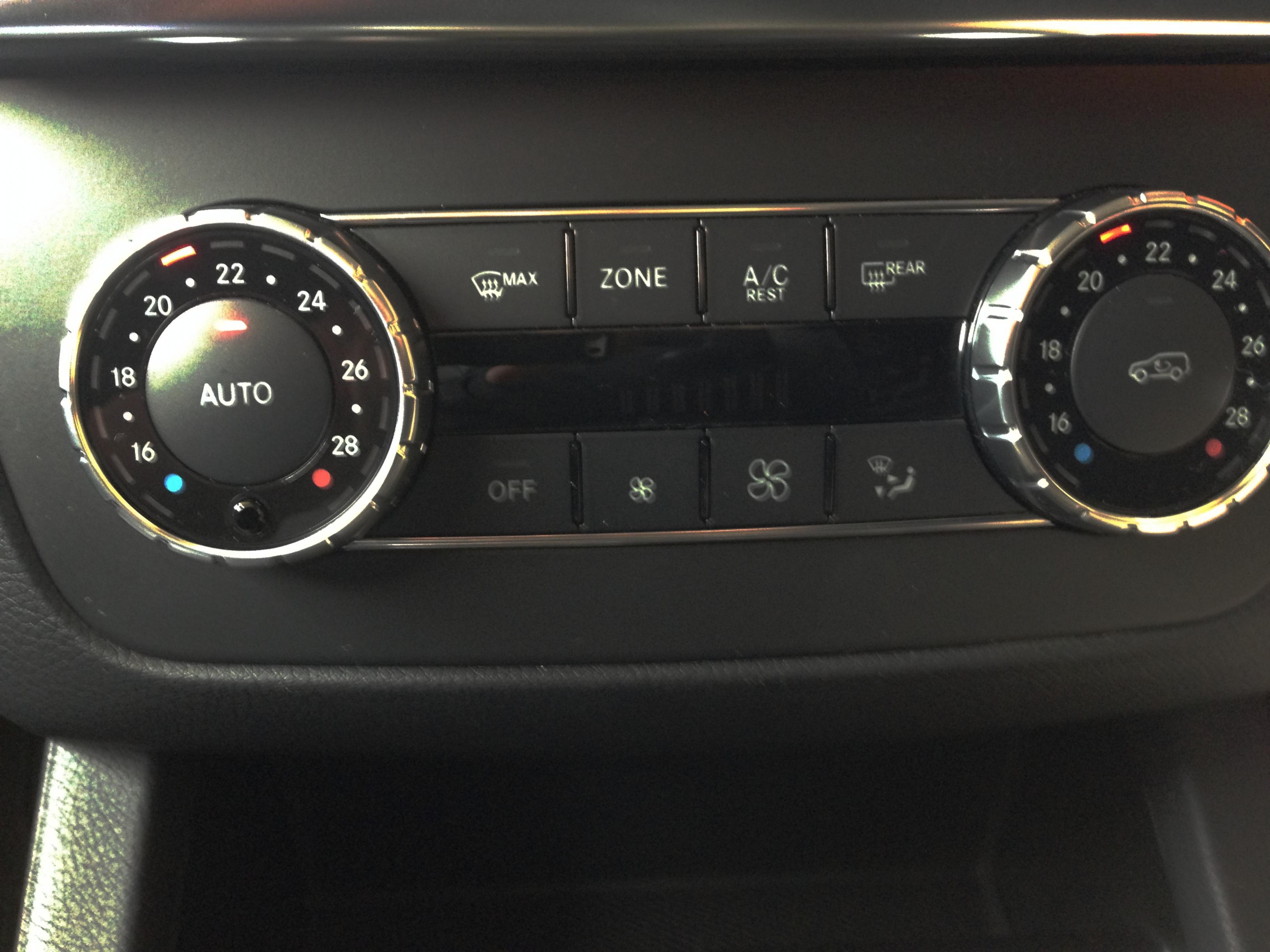

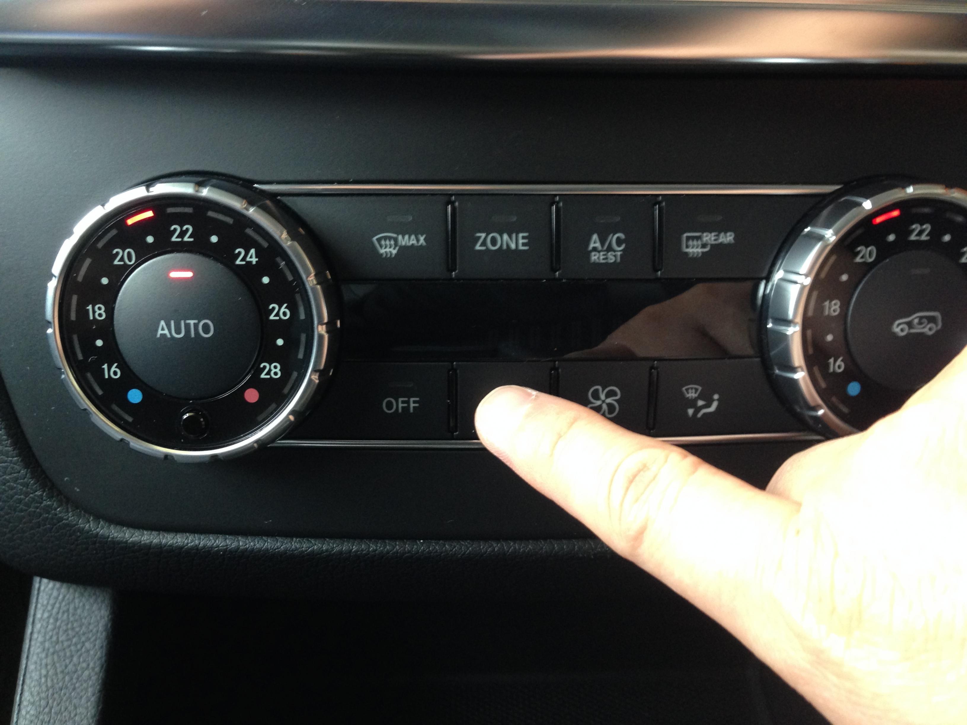

(1) Put your Thermatic into Auto mode with or without Air-Con. Let it run for 15mins or longer.
(2) Hit the 'Small Fan' button, and would you please report back how many vertical bars do you see? That is all I want to know if mine is normal or not. (I get 3; but if I hit the 'Big Fan' button, I get 5. i.e., Auto mode defaults to 4.)
(3) You can return your Thermatic back to any mode you want thereafter.
Thanks so much.
I attached photos of what I get below:

I did it. After 15 minutes in auto, ac on, settings to 18C and outside temp at 25C(I am back to Toronto), I hit the small fan button and came up with 5 bars, lowering a bit the fan speed. After I returned to auto, gave another 15 minutes and hit the button again. This time came to 3 bars and no change of speed on the fan, that was already in low speed.

Same problem here on a french 2014 GLK. The auto setting (ac on or off) defaults to 4 out of 7 vertical bars. If you shut the music down, the blowing is very audible and annoying. Pressing minus power goes to 3 and is far better and should be this way.
I'd like to find a solution to have auto on 3 or 2. I don't want to mess with it manually.
