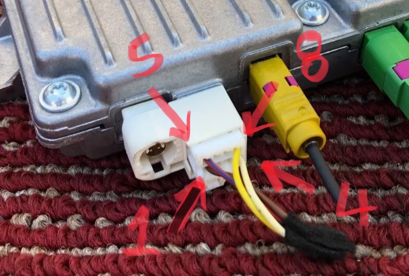

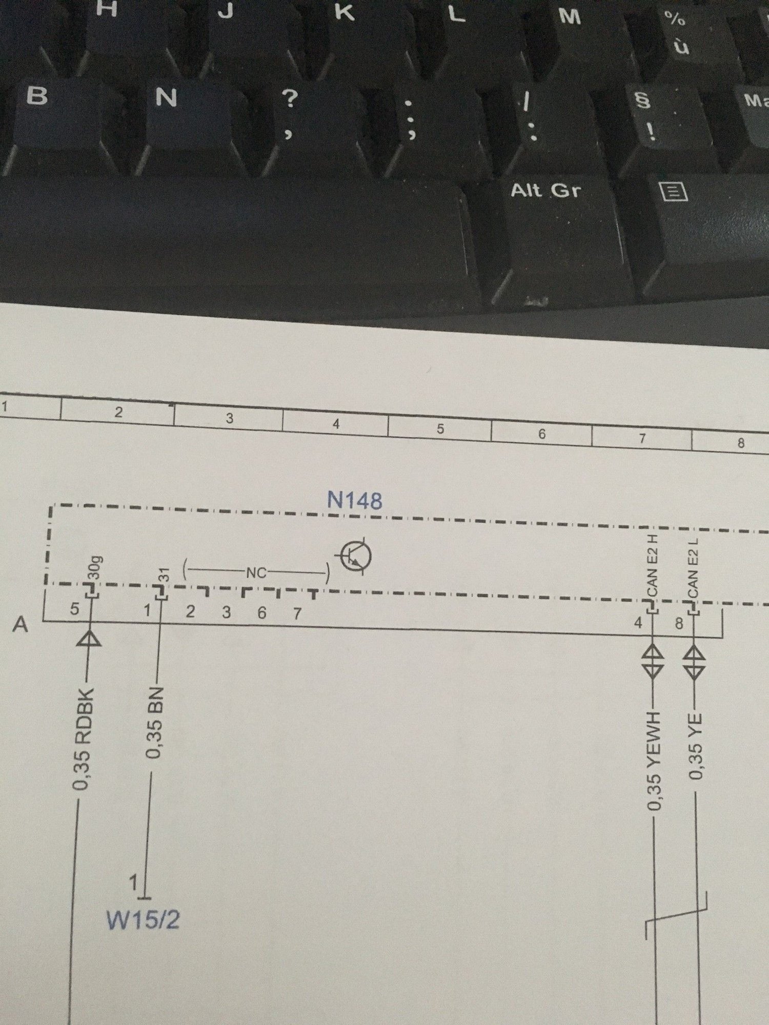

in the process of retrofitting my ml 350 w166 360° camera surround view.i have a concern about 360° control unit connector, want to know the name of such connector, where can i found it. and second question, the correspondance between schemas pin number and connector pin.
need the name of the white connector.
need to know the correspondance between the pin numbers in schema and physical pin in the last picture

Normally the pins are numbered inside the socket and on the plug. From your photo it looks like there are numbers in there. Have you used a flashlight and looked inside?

hmmm... interesting I know a few connectors that look they would fit, you need a total of three. I think it is easier to just get the wire harness.

I have the partial white connector; it is 001-545-11-73. This works with the 8 pins. Not sure about the 4 pins yet.

The other 4 pins not needed
i start too to retrifid w212 with same controller :-)
