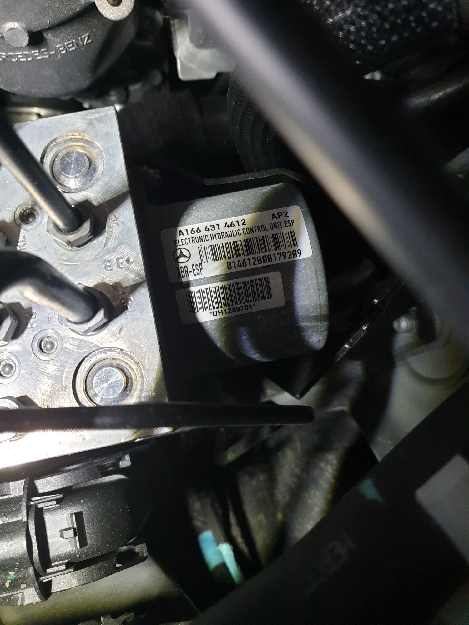

A1648880411
Brake pump not sure if it is compatible, if anyone knows how to tell me, please?
