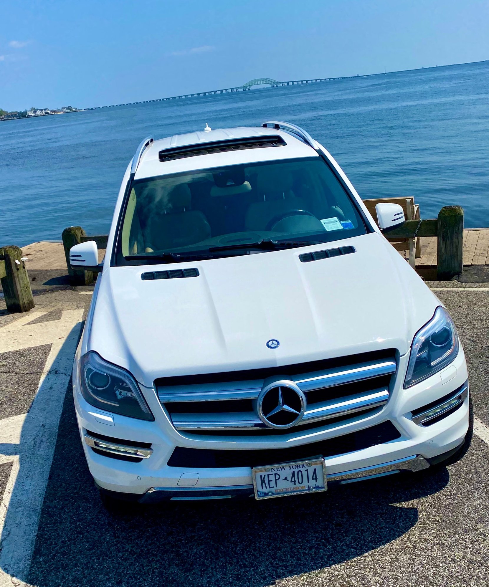

Originally Posted by Isawelvis
I have a 2015 ML 350 and switched to a Diamond grill. The Diamond grille came with the little round doofer under the star . But there is a problem in utilizing it ( it wasnt a problem for me since I don't have diatonic). The area for the gille on 2015 is shorter and the distronic doofer sits down and inside the cut out ie covered by body work where the grille fits. I think this is because the 2016 GLE a taller grille.
I basically, had to trim some of the tabs off the surround body work and just set the diamond grille down instead it.
Diamond grille in 2015 ML without distronic.
just looks great and is exactly what it is that I want to do can you reach out to me directly and maybe give me some further instruction on how to get it assembled I need to bring it to a shop so that they can install it properly I can’t believe how fantastic it looks on
