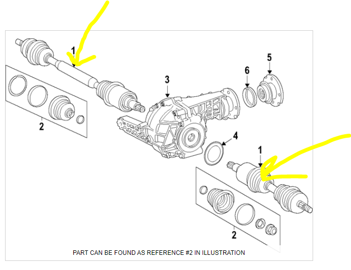

Cv axles?

what it means?
do you mean the transmission shaft?
Old May 24, 2023 | 03:14 PM

ok, but in this case when the car is moving, and I put the shaft in N, it should do nothing, instead also in N the machine continues to vibrate. Can be?
Careful here. You put it in N, neutral, and the car riding along the highway/street? If there is a problem with any of the axles: CV axles, or transmission shaft, they are still rotating --> Any unbalanced rotating component under load or not WILL vibrate.
Now if the car is in sitting on the street/driveway, and set to N, I would not expect any vibrations; however, there have been reported cases of vibrations on the W211 (several threads on that) in N after replacing CV axles for non-MB parts.
Many years ago, @1997, I had a subtle vibration on a Toyota Corolla (@30K miles), the dealer could not reproduce it and blamed it on the tires. Front tires were replaced, and the dealer insisted it was all good. It took me some talking back and forth (and several visits) until their master mechanic (the "boss") accepted to ride along with me (I was driving) to reproduce it in just 5 min. Summary: slightly bent front right CV axle. He could not understand what was wrong with it, but the new one never vibrated (finally went to the junkyard 15 years later)
