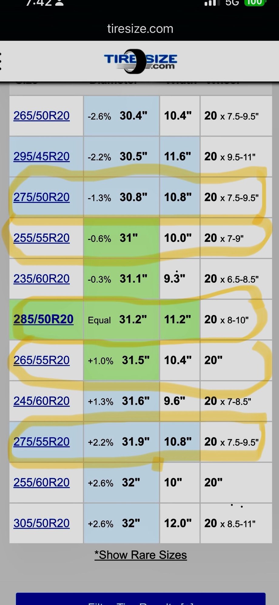

Hi everyone! I’ve been looking at several of these threads, but cannot seem to find the answer I’m looking for. I plan to install a set of 20 x 9 stock rims, and I’m looking for new tire ideas for my 2014 ML BT. I’m currently on the stock 255/55/19 and they’re 29’’ high.
The tires I’m interested in are at least 1.5 inch taller than stock. I also want to go wider but taller is priority because I like the look and prefer to have more meat on my tires for comfort.
So I’m thinking of getting 285/50/20 which are 31.5 inches. I saw another post where someone said they were using 255 5520 those are 31s, but I don’t know if they’d look too much pizza cutter-ish on my ride.
There seems to be more tire options for 265/55 and 275/55, but that’s going almost 3 inches higher than stock at almost 32 inches. I don’t think I should go more than 2 inches on stock suspension.
i’m aware that larger tires will cause a odometer reading issue. Anyone using hose tire sizes on W166 platform, especially on stock rims? Please share pictures. I’ve attached a screenshot showing a range of of the tire sizes I’m interested in. Please post pictures and suggestions. Thanks!
This chart shows tire sizes and what rim sizes will fit them.
This chart shows tire sizes and what rim sizes will fit them. Again, my room size is 20 x 9 stock with 57 offset.

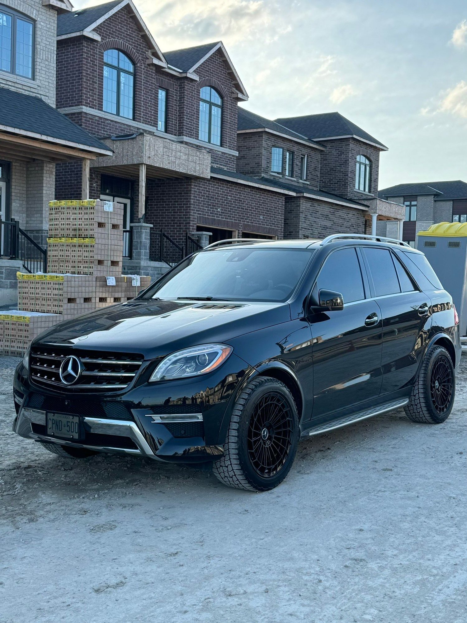

I had 315 45 21 on the back of my ML350.
275 55 21 on the front.
[img alt="ML 350
"]https://cimg6.ibsrv.net/gimg/www.mbworld.org-vbulletin/960x1280/ml3_8eb23790fb40dd3181264a9d9e70b88469fd9842.jpg[/img]
ML 350

Old Jul 24, 2025 | 07:47 PM
BazPol's Avatar
Joined: Jun 2025
Posts: 4
From: Florida
2014 ML 350 Bluetec
Thanks for sharing. I like the way they fill up the wheel well. I ended up with 275/ 50/20 squared. I like the extra 1.8 inch of height and .5 inch of sidewall. No rubbing no issue whatsoever.

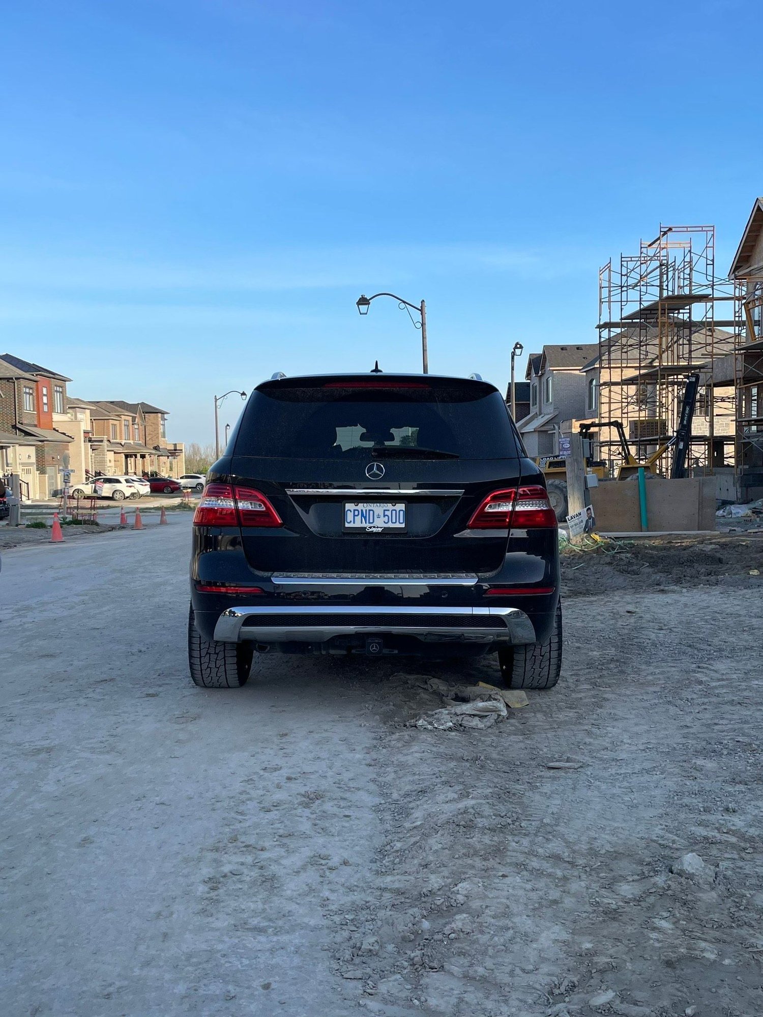

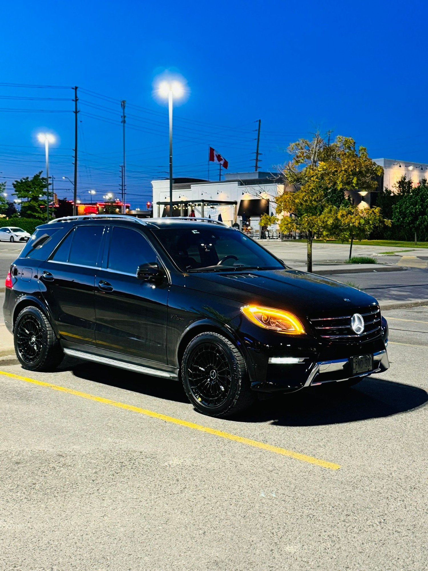

Falken Wildpeak A/T Trail - 275/45/20
Old Jul 28, 2025 | 02:20 PM
BazPol's Avatar
Joined: Jun 2025
Posts: 4
From: Florida
2014 ML 350 Bluetec
Nice! I like the stance. What offset are the wheels? I like the way they bulge out just enough, but not overly aggressive.
Old Jul 28, 2025 | 09:08 PM
mike919's Avatar
Joined: Mar 2014
Posts: 170
Likes: 61
From: Toronto, ON
86 190E 2.3, 2014 ML350 Bluetec
I don't remember the offset exactly, it might have been 44? Either way its enough to look a tad bit odd without fenders. Hence why I got the GLE style fenders.
