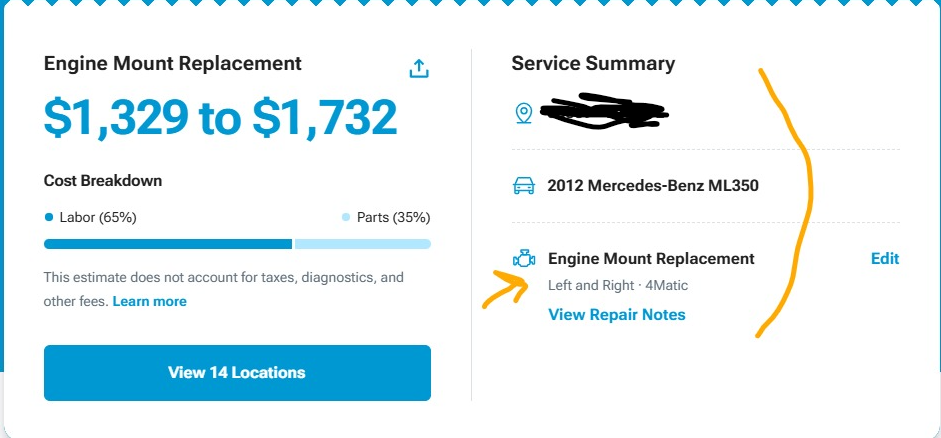

Had the same told by dealer in MA, for 2012, 141K miles for all 3 mounts. Parts labor quote came out at 3,208.74, called indy quote was provided around 1900. I did transmission mount already, it took me about 30-40 min and ~44 shipped from FCP. Bought passenger side, but did not have a chance to do it yet. There is a thread on this forum which has WIS pdfs attached how to do it, and torque specs.

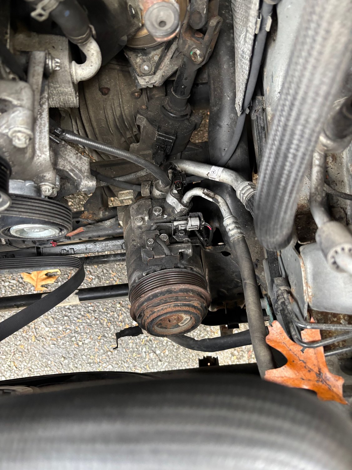

I just did both of mine on M276 engine– about 4 hours total with ramps on the driveway. It can be done one side at a time, but I wouldn't recommend it.
  • If only one side needs replacing, I'd suggest unscrewing the other side's engine mount from the frame to give the engine some room to lift.
  • Air filter housing probably needs to come off even for the left (driver's side) mount.
  • I used a 2x4 on the oil pan to lift the engine – not sure if that's the "proper" spot, but it worked for me.
  • Need 16 mm socket or tool that I had previous post
  • Need some good long extensions and other torx (10 and 12 I think) heads
Snapped some pictures from left (drivers side)
Dropped A/C compressor, removed ECU, and heat shield covering mount, did not remove oxygen sensor or heat shield for this side. Probably the hardest part was to reach screw on the back of the A/C and then screw it back....
