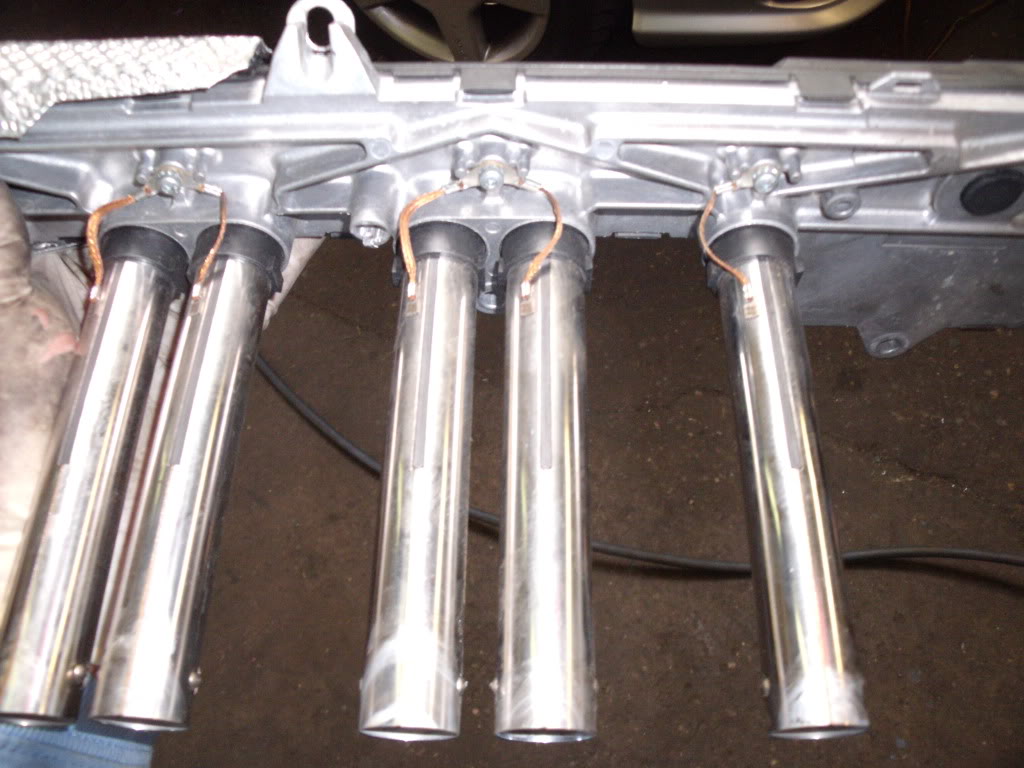

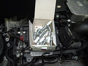

Not a tough job, just a little time consuming. Just unbolt the intercoolers and prop them up and out of the way. No need to remove them. Hope this helps some people.

AWESOME!
My car only has 20K miles on it, but it's a 2005 on the original plugs. Considering doing mine, but I've been told that it's a hella time consuming job.
How long did it take you and did the car feel any different with the new plugs?

It took me about 2 hours. There was no difference in power. I would not worry with only 20K. Plugs are expensive and there's 24 of them basterds.

The coil packs come out without touching shock towers.

Very close clearance but you do not have to lift the motor or anything like that. Thanks for a great DIY guide John!

Did mine yesterday, took just over 5 hours. 3 were a B**** to get loose, and had to replace 1 cracked red insulator; it was definitely time. Visited my dealer and paid $4.40 for one new insulator. Also cleaned the throttle body while everything was apart. My engine purrs at idle, and is running smoother than ever. Definitely worth the effort.
Thanks (also to Formula ZR) for posting the pics, they inspired me to take the plunge......and save $1,150 over what the dealer wanted on top of what the plugs cost.

The throttle body had 25K of lite coating of brown something or other, nothing bad but it was a little dirty. No need to remove it or dissassemble, just sprayed some "non coating abrasive" CRC Throttle Body Cleaner over both sides of the blade and the insides of the housing until everything was spic and span again.
The engine sputtered a little for about 10 seconds at initial startup as the cleaner was burned; which probably also cleaned up the intake manifold and combustion chambers a little.
Very happy with the outcome of new (OEM spec NGK) plugs and clean throttle body, my engine has never run better.
