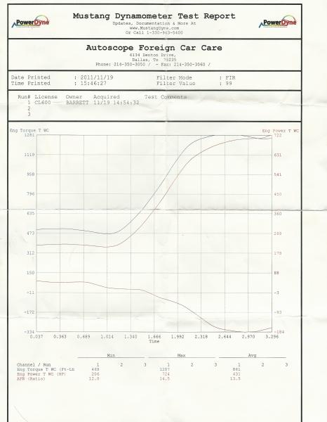

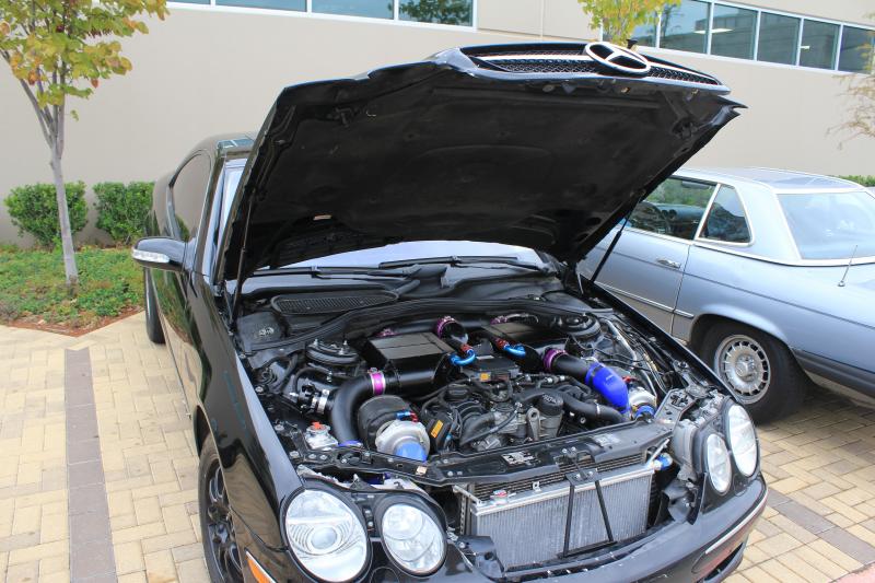

Old Nov 20, 2011 | 08:18 PM
Dynodaddy's Avatar
Joined: Jan 2011
Posts: 151
03 S600 11.7 @120, CL600
I have precision turbo billet compressor wheels in my S600 and it will hold 20psi until the rev limiter. The issue with these cars is not the turbo's it is the tiny exhaust manifolds that are creating an insane amount of backpressure.
I started from scratch and just finished the first tuning session with Jerry @ Eurocharged this weekend @ Autoscope in Dallas. I have a bad coilpack and we didn't get too far with the tuning but @ 17psi the car made 808rwhp and 1327ftlbs of torque on 93 octane only pulling to 4600rpm's. I will push the car as far as the injectors will allow during the next dyno session, and I have a feeling we will not need race fuel to max the injectors out. I believe I will make 900+ rwhp and almost 1500ft lbs of torque if the dyno can hold the power.
This car has the power to easily accomplish my goal of running 9 second 1/4 mile times and with any luck will perhaps break the 9.5 second barrier.
Attached Thumbnails Data Logging Boost Pressure and Others results.-tuning.jpg   Data Logging Boost Pressure and Others results.-scan0021.jpg

Old Nov 20, 2011 | 10:35 PM
Dynodaddy's Avatar
Joined: Jan 2011
Posts: 151
I did 95% of the work including all TIG welding and my brother did the other 5%. I am running a pair of Precision 58mm turbo's.
