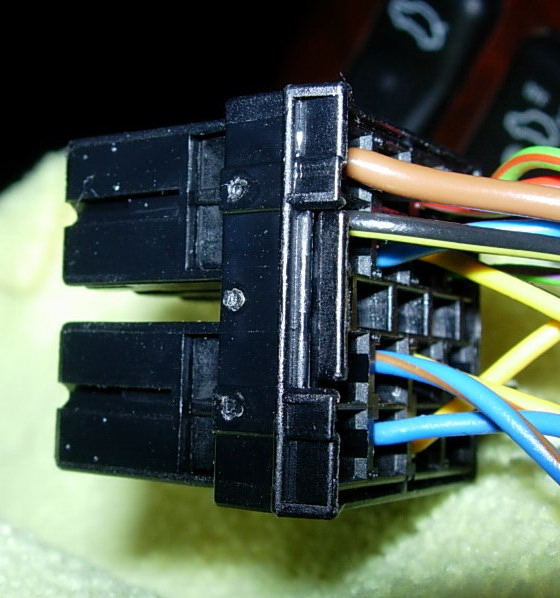

Please post pictures of the connector, up close. Please show each side and end.

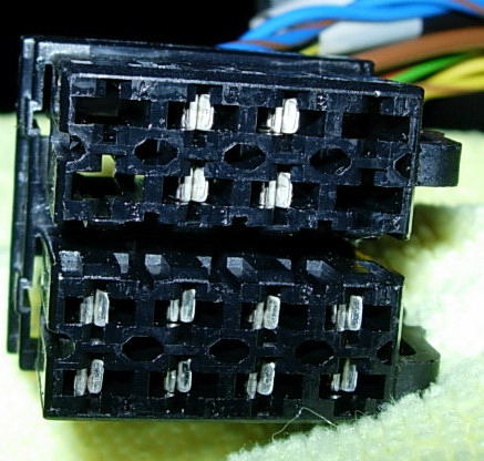

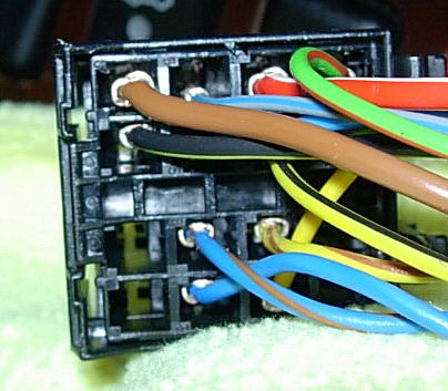

pics of connector
here you go. I appreciate your help.
Attached Thumbnails electrical contact extractor-dscn0016.jpg   electrical contact extractor-dscn0018.jpg   electrical contact extractor-dscn0019_2.jpg

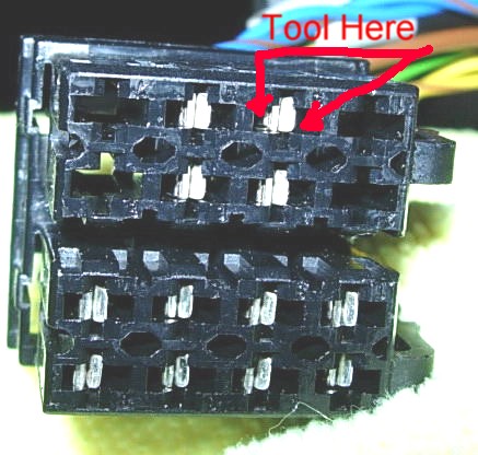

extracting that contact requires a special 2 prong tool from the dealer. about 40 bucks. or if you can rig something yourself, it would be cheaper. you need to insert a prong on each side of the contact from the front and pull the wire back.

The attached image shows the openings that need to have a tool inserted. I usually use a very small jeweler's screwdriver, but any small probe may be inserted.
That releases the contact tangs, so the contact may be pulled out.

Highly recommend the correct tool... it is $18 for the blade and $9 for the handle. You don't really NEED the handle... but $27 isn't too bad especially if you will use the tool in the future. It takes like one second with the tool... whereas I had a tough time getting connectors out using makeshift devices (precision screwdrivers, etc.).
Of course, pricing depends on your dealer... prices posted are list.
