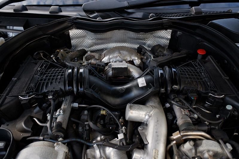

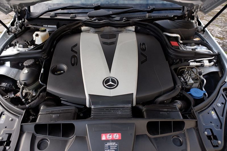

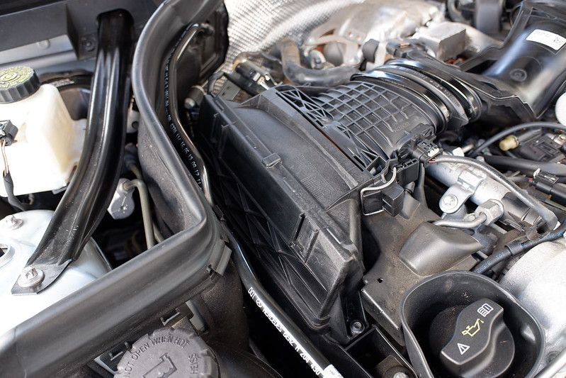

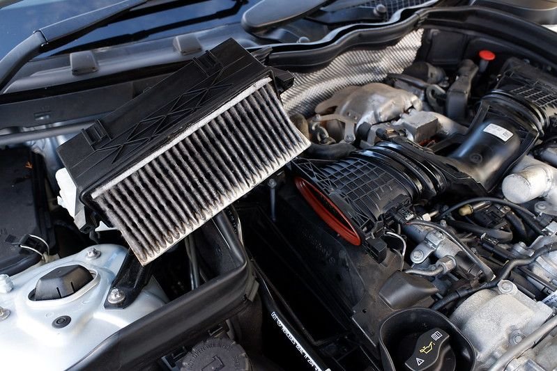

Unfortunately there was a mod done to this unit only small , the sensors were changed to 5 pin connection , mine is four so wouldn't fit and I've sent it back but here are the photos :
Engine with cover :
MAF Manifold :
Right hand filter box :
Left hand filter box which also has a sensor attached , the sensor to the left is the faulty Air Intake Sensor and the reason for replacing the whole unit , ridiculous !
An air filter :
The manifold removed , large turbo seal and small engine breather seal :
Engine with cover :
MAF Manifold :
An air filter :
Thank You
The parts in the photo look like a much better redesign than the previous / latest version that was used / sold the US. The US version looks different..
The engine cover has a front center cooler added, air intake for the air box is set up what looks like a ram-air intake.
The connection's, air box filters to the air intake duct pipe with air mass flow sensor's look much better.
