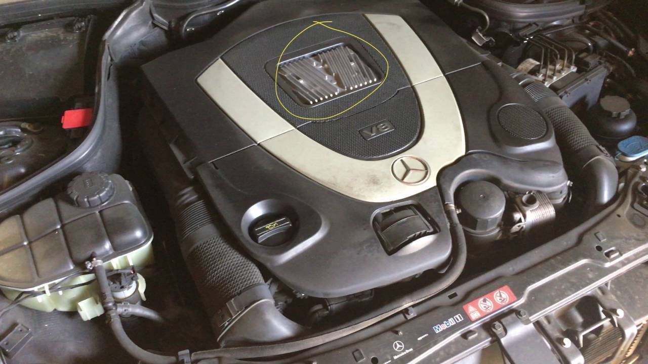

My complete experience
I actually have a m273 engine 07' S550 with a ME9.7 ECU. Since they place it on top the motor, after a 190k miles it was cooked !!!!
In addition, these ME 9.7 units are known to have this issue, although when looking at buyers guides or anything kind of similar info before buying the car, it is nowhere to be found??! Odd
I learnt a bit from this post from this other website *******.com. I'll link it at the end, they have pics of opened ECUs and trying to repair it on your own, which is beyond my skill level and frankly I would never have the time.
From my research what happens is inside the ECU some capacitors start leaking fluid onto the PCB, at this point it is repairable by replacing said leaking capacitors and cleaning it up.
Unfortunately, the PCB has holes in it and what happens quite often is that the fluid gets into the deeper layers through the holes. Further, separating the layers to clean it up well, is just not an option.
With my luck, even after realizing the issue almost immediately after it began and sent it off for repair to this Canadian company called XemodeX I had no luck.
Moreover, XemodeX then told me that they had no ME 9.7 units in stock to clone it onto and that to source it would take a month or more (((
That would not work because my mom's birthday was in a week and I had a whole cabin for my entire family and wanted to go in comfort because my mom had back surgery recently.
Finally, luck smiled on me, I found this Mercedes tuner based in Georgia called PRESSERTECH.
They have ECUs in stock and unbelievably they do testing for free!! I could not find another place that would do testing for free. I wish I sent it to them to start with and saved a 100$.
Anyways, they cloned it within a day and saved the day, they're the true heroes
Two months later, and about 2k miles later, I have no issues whatsoever, it was a great plug n play option.
Even their cloning price was the most reasonable I could find 1k$ plus warranty for a year or two, not sure.
Other places were like 1.5k$ + and would take like 3-4 weeks because they were back logged or some other bs. Plus, they would charge like 150$ for just testing, then 500$ if it is repairable and finally 1,600$+ for the cloning but they would take previous payments towards that.
If your ECU is going bad and you have these codes call PRESSERTECH and they will help you out.
XemodeX, were quite professional and very helpful they went out of their way to send it to PRESSERTECH directly and did so late after hours, instead of the next day because they understood the urgency. What I realized is that they have more Volvo experience and not so much with Benz.
Lastly, in my opinion the only foolproof long term solution would be to relocate the ECU, if you look at the S63 M156 engine bay, they ECU is a bit more isolated from the rest.
Damn long post, but hope this helps.
