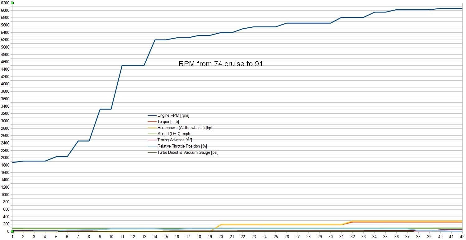

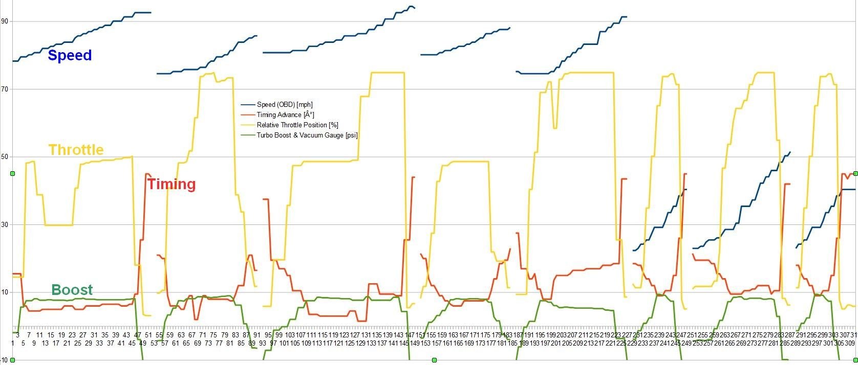

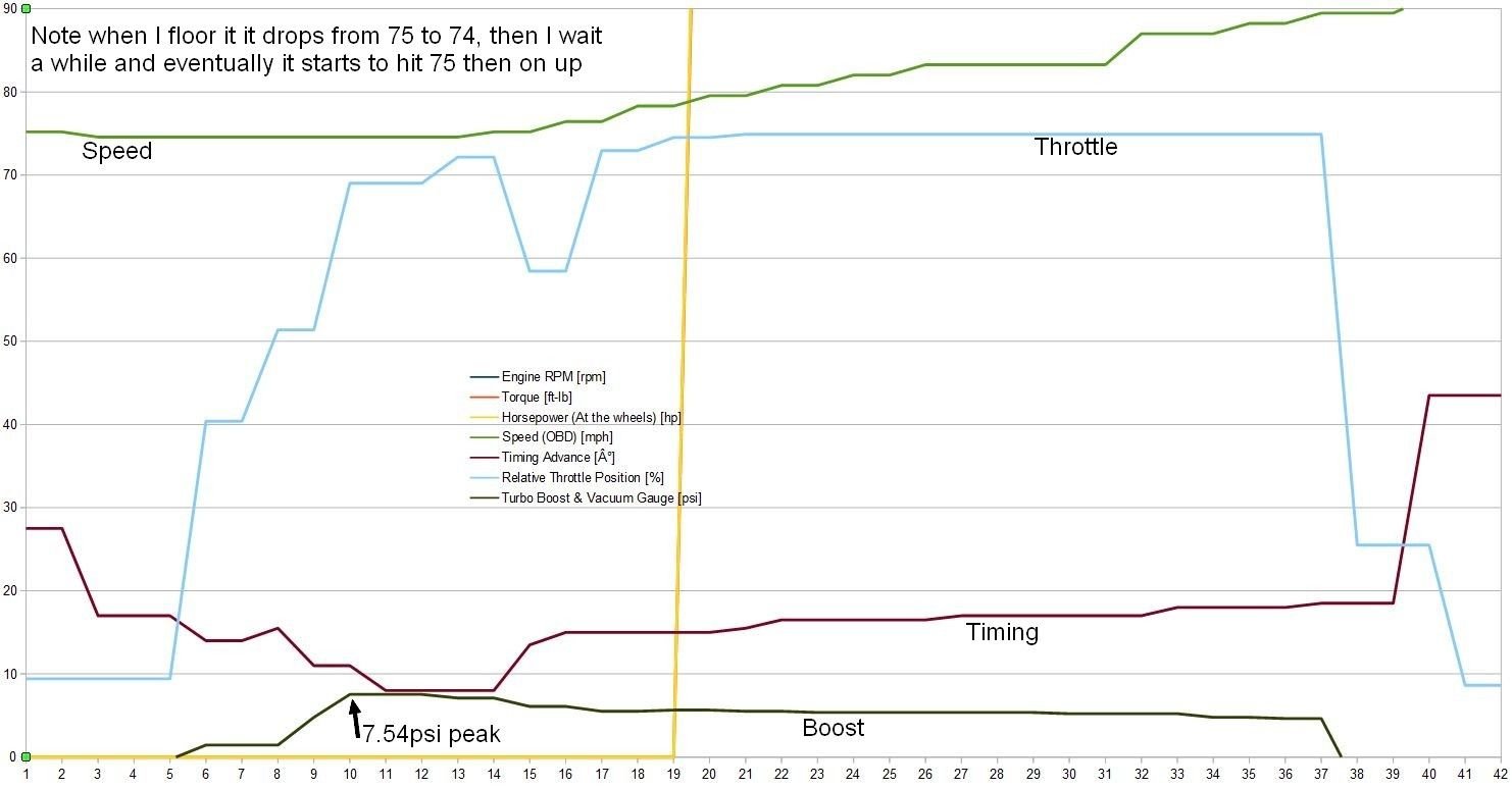

Temps are good meaning they are normal. So I put the few charts I have together here.
Water temps is normally ~190 if I recall correctly, but I rarely check it because again I called it "good"

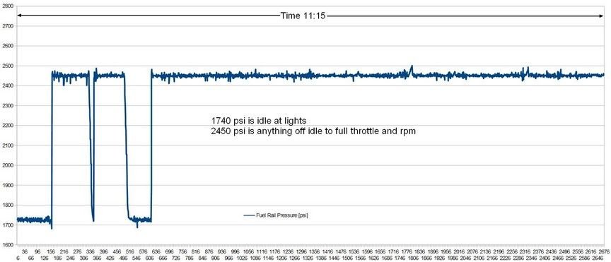

All these tests here were done ~1130am, weekday, because it's the best time traffic wise. In this case it was 30 July. One is scaled 0-6200 so you can see RPM, then 0-290 for Power, then 0-90 for the other stuff.
Last chart is a bunch of throttle blips put together on one very lucky day.
I can do tests at lower speeds off the freeway, and if I do it right boost will flash much higher for a split sec, but I can't hold the gas down long enough for a good read. Generally 2 sec is about it and I have to hit the brakes. 3am is different but cops are everywhere. Since the data lags so bad, in those 2 secs you'll see boost but something stupid like 50HP because it missed most of it. I think all data collection here 1/10th sec but data comes through when it feels like it.
Misfires: per Xentry, zero ever apparently, until my battery went low a month or so ago and caused massive issues including tons of misfires. Which is another gripe because the batt should not cause that any issues. It happens to others too, so obviously it's programmed to create problems. My guess is so to you take it in for repairs in exchange for your cash.
I charted O2 sensors last year, and while I forget what they were exactly, they were fine and I blew that off like the temps. Same with knock sensors, which activate for a brief moment when first floored, but apparently that's normal. I assume that is how the system tests your octane, because how else could it know?
Mpg is like ~21, which is good considering the traffic. On the freeway it's ~25, 30 if I drive the speed limit (per the untrustworthy reading the car provides). The 21 is based on actual miles per tank fills.

I actually got bluetooth to work for 11 minutes today, but unfortunately all it recorded was fuel psi. Lower psi is idle, the rest is everything off idle to full throttle and rpm and everything in between. The internet says it varies from 1740 to 2900. I checked psi last year too but I can't find that old data. Not sure what to make of it being <2900. I'm guessing this is of no use but Torque/Charts apparently won't do fuel trim.
I did find an old Autel report that says long term fuel trim is -2.3 on banks 1 & 2. Not sure how long long term is, but fyi. I assume that means its shortening the injection duration by 2.3% compared to the fuel map. If so then it would also be safe to assume clogged injectors or low fuel psi would go into the + side. With the low mileage I don't believe inj, cats or anything else is hosed. Electronics I believe...
Meanwhile I'll work on Xentry screen recording of fuel trim and O2. Thanks for input btw. I'm super annoyed at all this but appreciate the input/help. And yes I'd bring it to you if you weren't 3k miles away.
