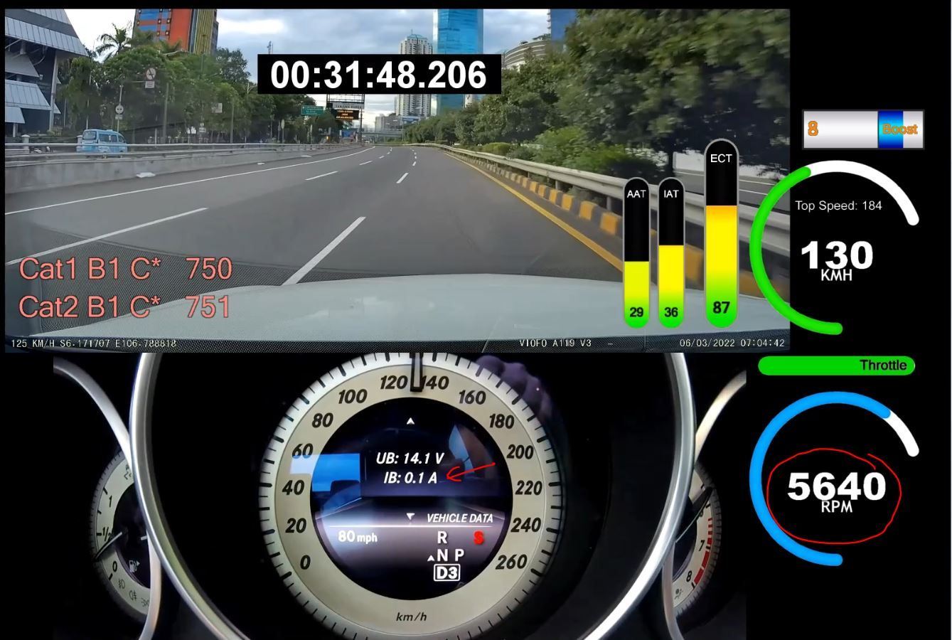

Originally Posted by Sargy
For ALT-LIN enabled Is there a list of conditions where it would charge at 14v+ example, headlights.
@S-Prihadi
Trying to replicate the scenario where it would do the typical 12v during driving but so far just 1 driving cycle did that.

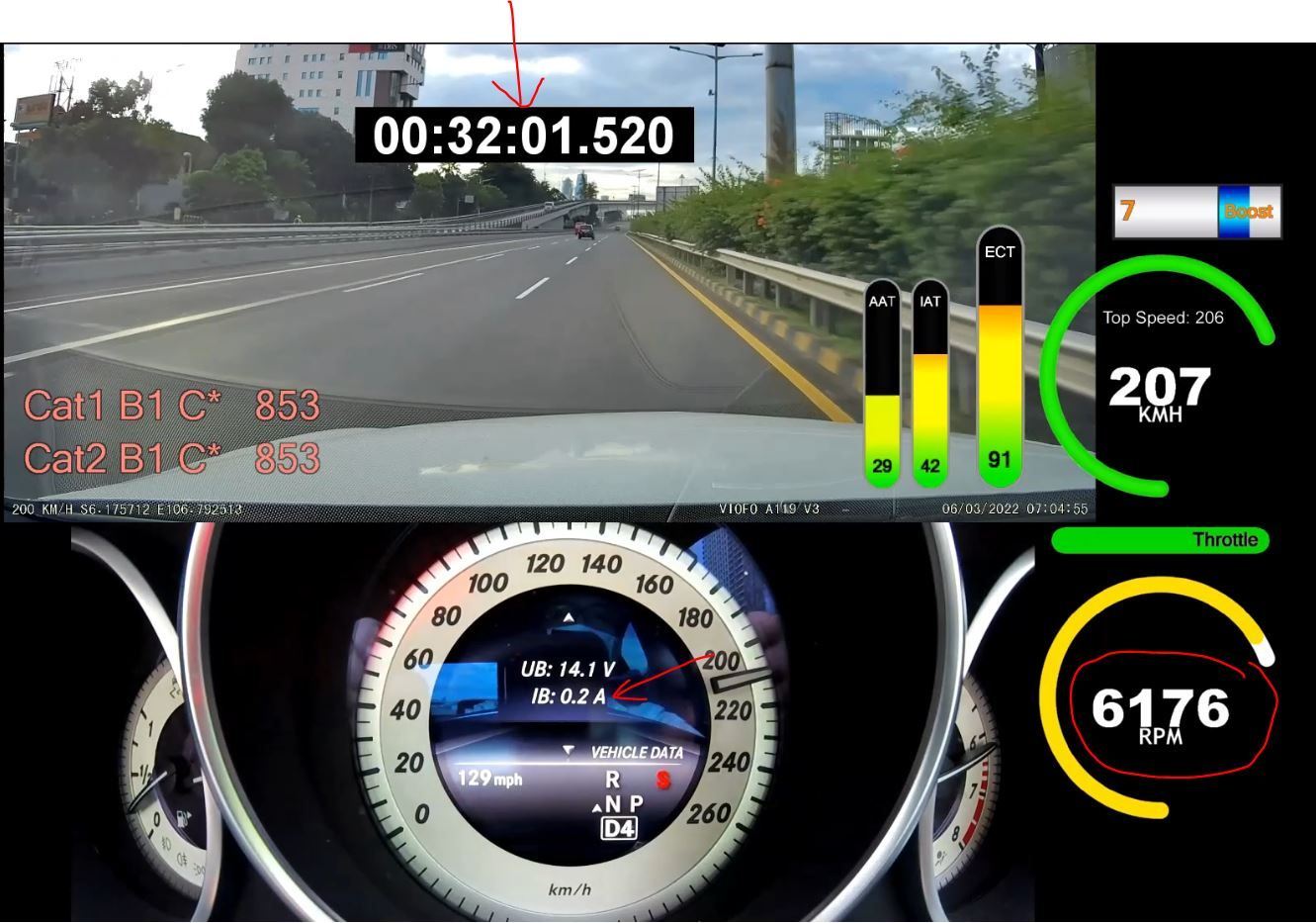

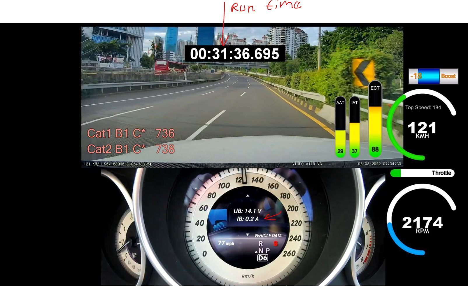

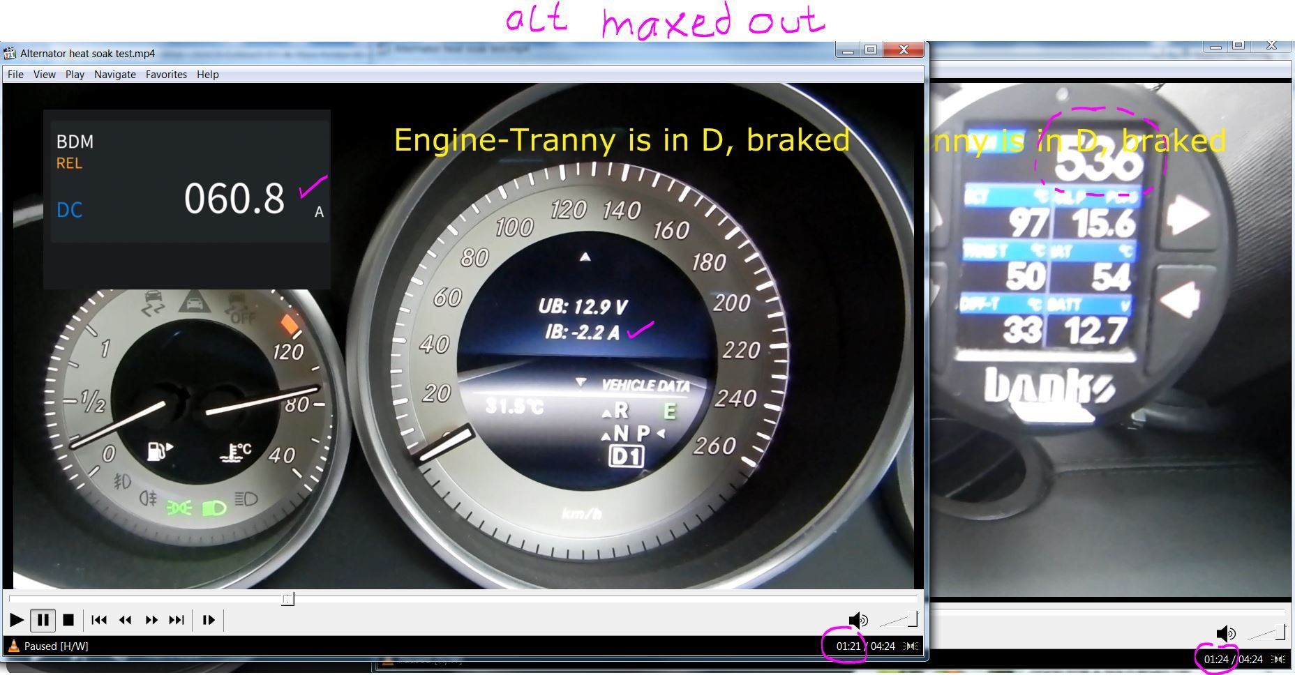

Sorry, I missed this question.
For my 200A Valeo alternator, the voltage will be 13.9 to 14.1V at all times, with amperage the one being managed by the alternator.
However, voltage dip will always happen when alternator is hot soaked already, while I am in D mode for tranny and brake HOLD, which is the lowest RPM of 550.....
and then I do rapid and high degree of change on the steering.
Electric power steering is a super big sucker, can be up to 80 amps.
If above condition is at night, that 550 RPM added with headlight load, my alternator can easily be in mild deficit because 550 RPM engine is too low for alternator when already heat soaked
and loaded at 60 amps. Deficit is when the voltage will drop below 13.4V and can be below 12.8V, depending on how much deficit.
At 650 RPM or more, there will be no deficit whatsoever even when heat soaked.
I dont know if I ever post my alternator heat soak test here, but here it is : https://mbworld.org/forums/e-class-w...soak-test.html

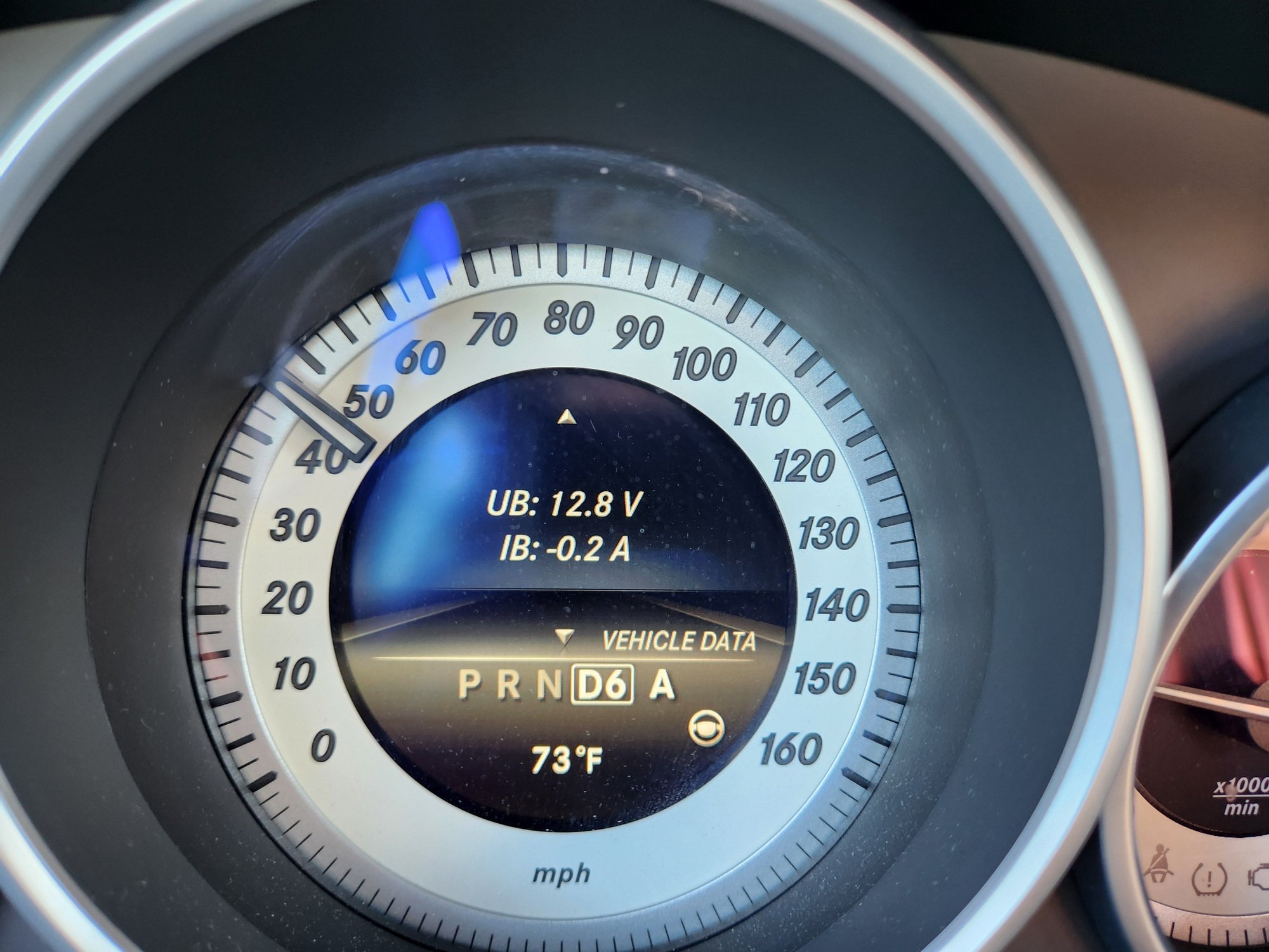

this is okay!
12.8 to 14.9V is NORMAL charge cycle.
12.8V is not 12.6V but it will do just fine to take care of your batteries.
YOYO Territory...
What happens below 12.3V is battery "drain by driving": Periods of deep drain laced with 14.9V bulk 90A high current, short battery life.

14.1V while at only 100 to 200 milliamps or 0.1 to 0.2 amp is what a good disconnected ALT-LIN alternator will produce when battery already full.
Its like a float voltage of a smart charger.
March, year 2022 archive.
