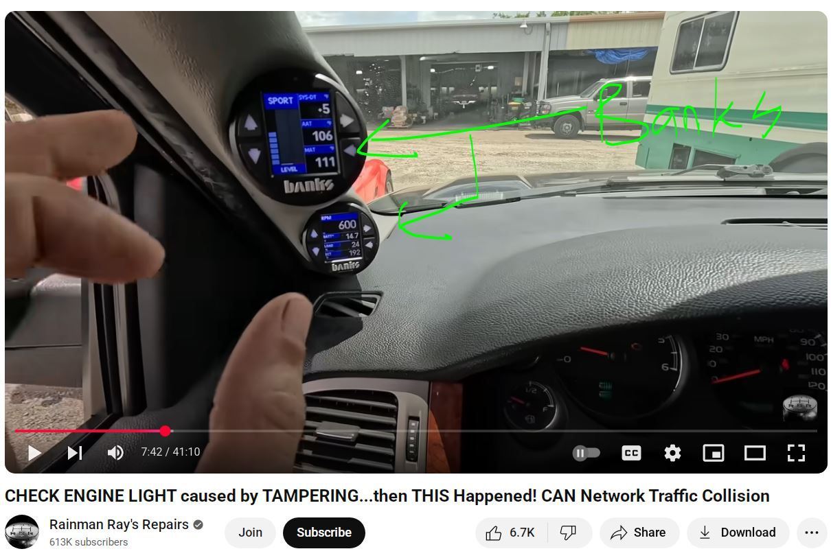

Originally Posted by JettaRed
Than you JR for this brilliant selection - This is advanced knowledge about CAN chaos!
This is extremely interesting because the master tech is really knowledgeable about this topic.
He is getting engine timing codes generated by overloaded CAN-Bus.
To most ppl this makes absolutely no sense what soever.
To me it's prime evidence that ECU does not have enough bandwidth abailable to publish live data while doing real time computations.
Tech directly noted that new Alpine OBD radio caused engine to run rough... crappy TIMINGS!
This serves as evidence that bandwith is limited.
Not only Banks and Alpine are bad news, I personally evidenced that stock CAN-bus is precisely built to suck buckets with carefully chosen solderless modules.
--- let me watch 2nd half of video ---
++++ Tech guesses firmware tune jacked up 2009 ECU.
For me it's weird there is Cam sensor without VVT gear !!!
+++ Alpine is a brand of Mitsubishi that makes MB NTG
+++ Tech clears ECU faults with engine idling
+++ Tech evidence CAN congestion with 2x Banks + 1x Alpine.
My testing showed me stock CAN is already bottlenecked without extra Modules.: courtesy of solderless retransmits. Reboot helps momentarily.

Originally Posted by S-Prihadi
You can not use another OBD2 device ( The Alpine new screen ) when Banks Gauge is in use.
They both will clash, when asking the same OBD2 message request.
One has to be a purely listerner and not both being a data request maker.
I already tried such test
Banks Gauge manual stated this fact..... No secondary OBD2 bi-etch when Banks Gauge installed. No polygamy only monogamy
IC Display is already pulling ECU data I believe through CGW not directly CAN-C.
Stock bandwidth is purposely derated by a few solderless modules.
Remember I asked about fish-bites misfires when scanning....
Disrupted timing is what delays Xfer between ECU--TCU = banging shifts out of time. (no code!!)
I've heard my own ECU stumble just by scanning chassis (not clearing any modules) at engine idle.
Its becoming pretty clear what's causing incremental performance loss.
At the very root it's variations of precise spark timing.

I do not know about that Alpine display on that US truck tapping which CAN BUS, but it will be like any other OBD2 gauge method.
The Banks Tuner kit https://bankspower.com/collections/c...uners-monitors on that truck is not only using the Banks Display as OBD2 gauge, but also for the tuner module thus it does not
want any other alien OBD2 device being nosy.
Don't worry about our ECM being slowed down by OBD2 gauge, it wont happen if the gauge is a good one, where it stay within proper protocol.
Also the ECM data request has higher priority than any OBD2 gauge data request.
I am logging at 5Hz..... for years now already, no issue, no such thing as fish bite misfire on my car ever or tranny being dumb.

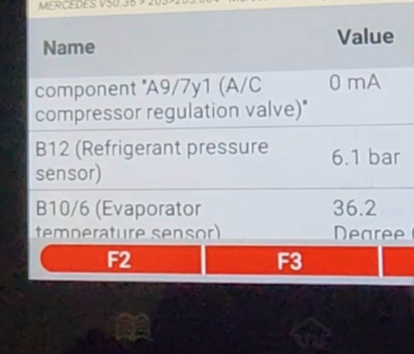

I don't think it has anything to do with unplugging the ALT-LIN but first summer since unplug and um, no A/C : ( it wasn't too bad but still pretty warm, 25-27.5C today with no a/c : (
Can you hook up your scanner and read your solderless AAC module: pressure reads how much?
There's a chance you have a wet connection around A/C compressor (clutch/PWM Valve) or pressure sensor on condenser coil or minimal pressure that's keeping system off.
Leak will show PAG oily mess.
Thanks forum member CaliBenzDriver
Don't see any leak, first thing I checked but the pressures aren't good:
bad pressures without leak is rare: bad compressor but these are variable on-demand: harder to gauge refrigerant load!!
  1. What's the scanner saying?
  2. clutch actuated ?
  3. pwm valve changing?
  4. pressure around 80/100psi at rest engine warm.
Favorite leak spot: the A/C shredder valves!!
It is nowhere close to 80, take like half of that and half of that and another half of that and then you will end up with the number I have.
it was working last summer

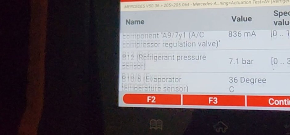

6Bar is near 90psi !!!
So no leak more like stuck proportional valve issue.
It is using 800mA current: that means connection is ok.
That valve is stuck!
