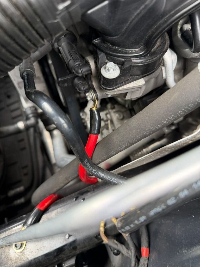

> ROOT CAUSE: PREFUSE drop!
One thing is clear the root cause is OXIDIZED PREFUSE main path from ALT.
The floated battery is able to smooth out current ripples dropping voltage.
Practically the chassis main power from ALT gradually oxidize tinned connections to significantly drop voltage inside PreFuse.
After years this unstable power impact whole chassis performance.
Current ripples could be evidenced with a fancy scope... easiest way is with simple float test (or best with "bypass strap") helping or not.

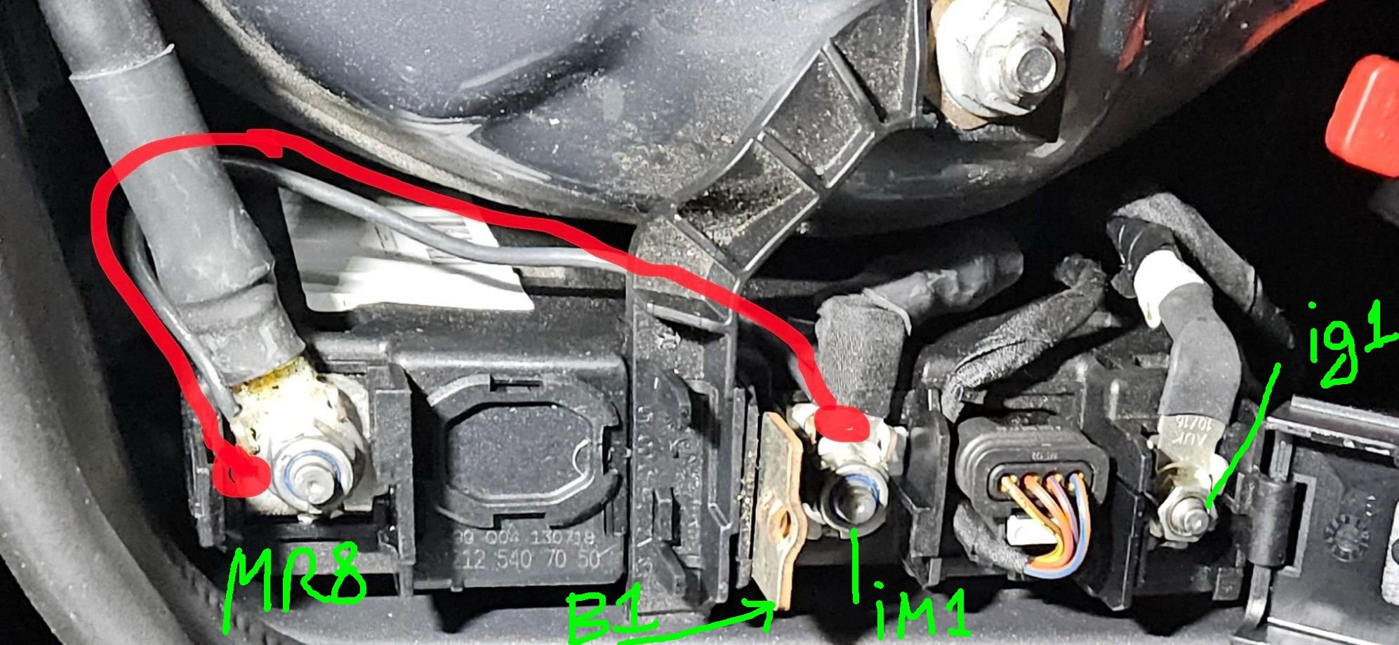

> NEXT STEP...
Clean & protect prefuse oxidized connections to see if "bypass strap" still useful to provide self-float condition.
If No... strap will come off else strap will stay.
-A: from ALT input -B: to AUX in Trunk
-A: input from ALT -B: to AUX in Trunk
A+B directly connected to prefuse distribution main bar through 350+250 Amp links.
Bypass strap delivers power to main bar with less drop than existing single oxidized 350A connections.

> NEXT STEP...
https://cimg4.ibsrv.net/gimg/www.mbw...0321d9c0a4.jpg
https://cimg3.ibsrv.net/gimg/www.mbw...c704b5ca75.jpg
W212 prefuse OXIDIZED opportunities

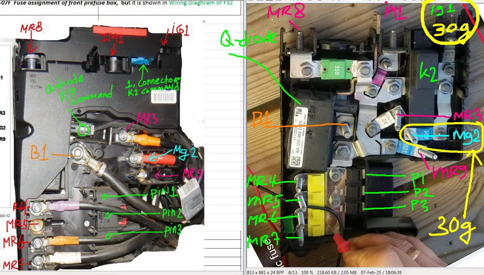

I'm positively satisfied by the improvements related to the Prefuse "strap bypass".
Chassis responding to cleaner voltage highlights it is sensitive to riples (~500mV): duh!
I'm curious to further discover what happens with cleaned up smaller RIPPLES.
Bean-counters assess DC current need a small gauge IGNORING the conductors need to be sized to supply the Max current of spikes. That is 30A peak transient vs. 5Amps DC.
Need for bigger gauge to pass current:
Some if us know that coils are inductive loads charged by current, not by voltage like capacitive loads.
Coils responded significantly to strap, that is a call for more fixing in that direction....

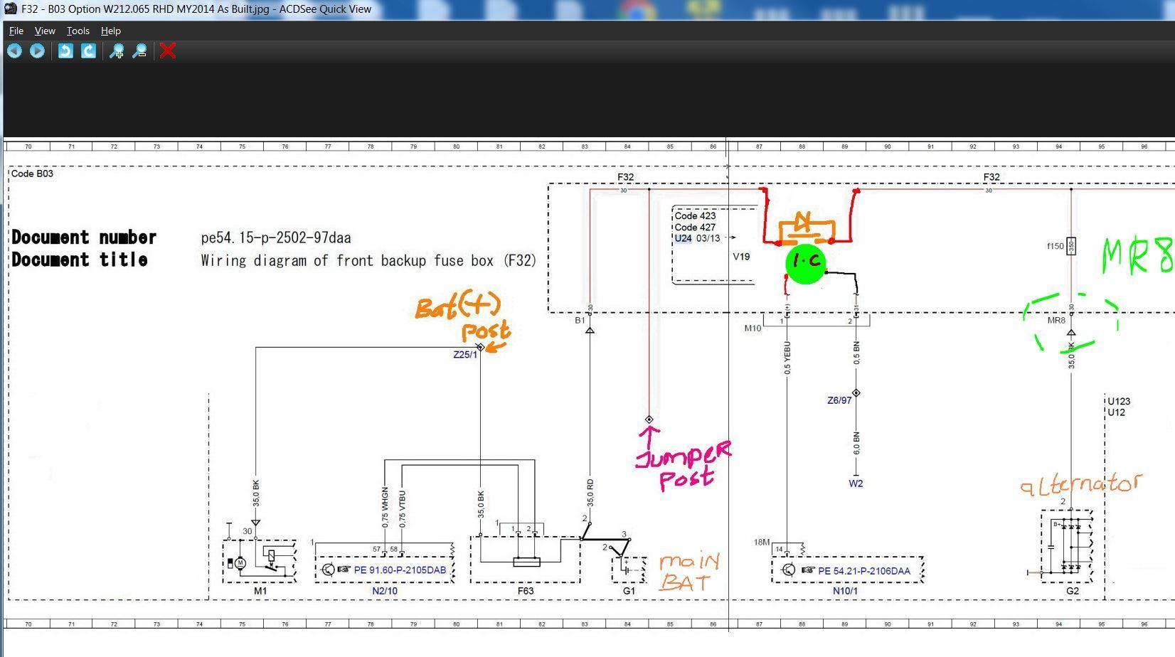

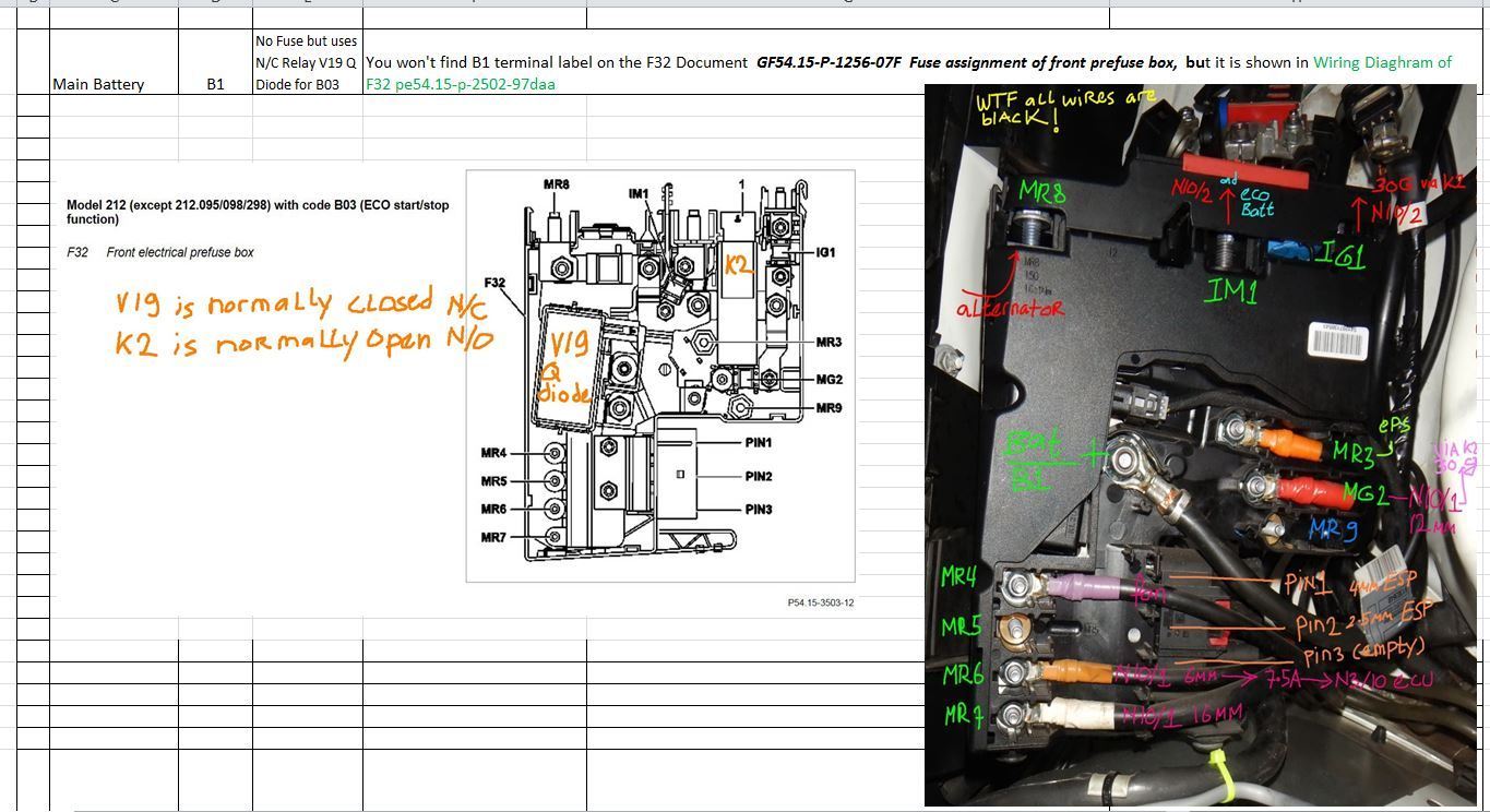

Prefuse built-in cleanup capacitor 👍
My schematic provider shows a cleanup Cap built inside my prefuse. This is outdated!! It is no longer in use despite being necessary.
The cap was supplying the current surge necessary to charge up magnetic coils.
All of this hair spliting is really practical.

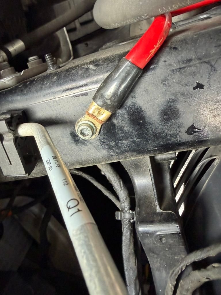

bypass strap around the 350A link
> Float vs. Strap....
If floating the main battery delivers a transformed engine/tranny...
then it likely means the experimental prefuse "strap bypass" will provide the same longer lasting effect 24x7.
This is the most stable chassis response I have tested so far.
Minimal change with strap + float combination means strapping around "350A main fuse" is the keystone ie. nasty drop!

Use EPC/WIS, dont use 3rd party wiring . Many are wrong/garbage. Come on man.
I never seen inteference capacitor in my F32 wiring schematic nor its physical presence.
What is your VIN, let me find you the proper F32 wiring for your variant.

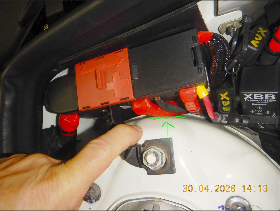

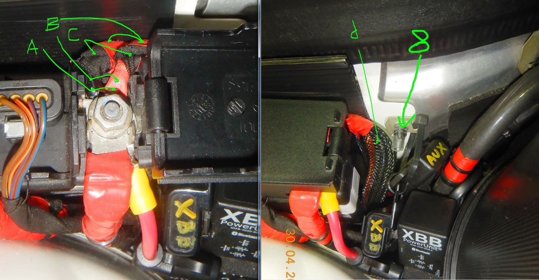

BTW
Your grey parallel baby wire is a fire risk, I am sure you know that.
Its like a second fuse, in wire form but its PCV jacket is close to suspension tower, which is metal, albeit painted.
Becareful with it. I do take positive power from Circuit 30g at F32 too for my extra AUX lights, thus I am very careful about it.

parallel bypass strap

Most pleasant is of course ALT LIN disconnected.
BTW
Yes, your caution is correct to never short-circuit positive DC power to chassis ground.
You think this strap is an overloaded fire risk, my experiment does not show that.
The bypass strap itself...
You know about electric current, flow of electrons right?
strap bypass connections
bypass strap connections
How much current flows through the strap shown above ?
internal path in parallel with strap
what's the resistance of this path?
(2x fuses + 4x connections) = ?
How much DC voltage is dropped ?
How much DC ripples voltage are present ?
Is the strap sized well with 12 or 10 AWG. ?
> Equivalent diagram...
Let's consider the path from Prefuse ALT input post.
Stock goes through 350A link to distribution bar
Strap goes through both 350A + 200A links to bar
The two fuses are now in parallel.
Its not a 50% split current because fuses have different resistance based on current rating.
This give a more direct connection to where battery voltage lands through SSR relay.
Exactly what I wanted to test as a float level supply.
min batt charge current
> Amp clamp & Scope...
I did not bother to throw my Amp meter clamp over these cables because the riples are not DC and not AC:60Hz = false measurements numbers.
This Amp measurement requires a calibrated load resistor and a scope but life is short before next Asia tour.
> Fasteners Upgrades...
I find the NUTS fasteners solution a bit substandard:
  • Single nut
  • zero washer
  • no plastic insert stopper
  • no Loctite
  • no counter nut
  • plenty of vibrations
  • no redundant path
What is MB expecting with this setup??
Stainless steel nut conduction does not seems as good as brass conduction.
Currently we have oxidated tinned nuts.
Prefuse cap is as described: a much needed legacy gone missing.
Next steps to include:
Bypass harness between SAM to ECU splice.
Prefuse pimp: oxide + nuts
Old Apr 30, 2026 | 04:07 AM
  #1162
S-Prihadi's Avatar
Joined: May 2018
Posts: 6,637
Likes: 6,582
From: Jakarta-Indonesia
What I am saying is, the baby gray wire of yours is dangerous not because of the amperage load it will carry during engine operation or alternator powering up the
MAIN BUS BAR of the F32, but because of the fuse size between MR8 ( aternator - 350 amps fuse ) and IM1 ( to K114 relay Aux battery - 200 amps fuse ) at F32.
MR8 and IM1 is Circuit 30, always hot, always have power.
That is why I do not use it for my AUX lighs power source, I choose Circuit 30g IG1 which can sleep and of lower fuse rating of 150 amps. Still 150 amps is scarry when 4mm wire is what I use.
200 Amps alone will burn that baby gray wire if and when its jacket get wounded and short to ground.
But there is also 350 amps fuse of the alternator which is via Q-Diode and to B1 terminal which is battery positive. Double danger, twin power source.
F32 wiring diag attached.
Looking at your F32 external, your F32 is 100% identical to mine in terms of function and components, because surely you have B03 Start Stop option and
your pyrofuse is at the battery positive terminal.
Anyway resistance goes up with heat and load/amperage.
You cleaning your F32 like I did will be best move Cali.
Your baby grey wire add-on is just you being lazy and placebo effect is what made you feel positive here and there.
BTW.... if you still remember...
I have even beefed up my positive power supply to all my six COPs.
https://mbworld.org/forums/e-class-w...ml#post8830623
I gain 0.3 volts less voltage drop at peak load. Not the greatest , for the effort. But I do now have more copper conductor for the COP and long term it would be good to assist the aging MB original wires.
Anyhow, becareful of short circuit risk, that is all I can say.
To show you how I respect ( fear is a better word ) prevention of short circuit on my car ..........................
Below is my added protection for my F32, because I use battery maintainer a lot , I do not like my crocodile clip copper teeth to touch the painted body by accident. Item 1.
I also added extra insulation to MB cables end, more so where it is resting on painted surface. 3M electrical tape. Item 2 to 4.
Item 5 is fuse as close as possible to most upstream power source.
Many extra layer of 3M electrical tape where the wires are touching the painted surface.
Tripple layer.
A = Heat shrink and B = 3M tape and C = TESA tape , where potential problem may arise
and D - plastic mesh for the wire itself.
Thanks to this discussion, I added simple clear vinyl hose Item 8 , to reduce any possibility of that heat shield steel screw from hurting any wires and/or my fingers.
Usually I use blue silicone hose as protection, for such protruding sharp surface, but in this case for shape of the screw thread ....clear vinyl hose is better.
Since I am on a RHD car, the battery positive post is a dangerous orientation. I mean it can touch the car body, if say the clamp is loose or whatever Uncle Murphy wanna do.
The pyrofuse metal cage is not carrying current, I mean it is not +12V , a good thing.
I keep older Varta battery protection cap and use thick plastic protection sticker, you can see the hazzy color.
File Type: pdf

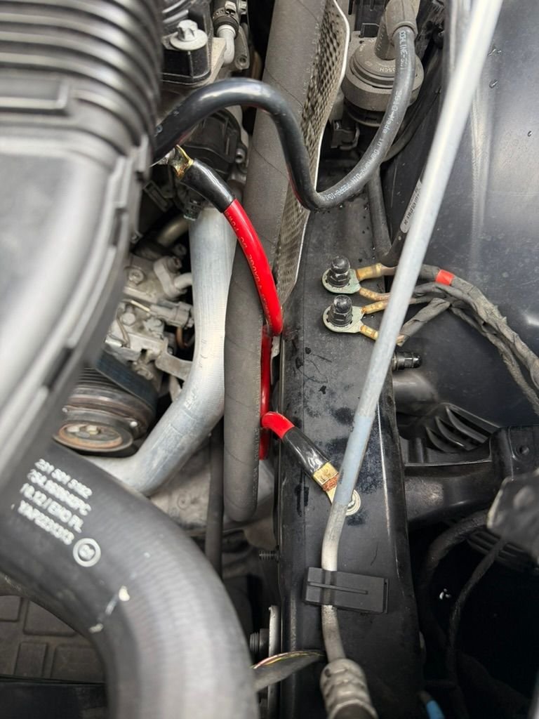

Here you go…
My redundant ground strap between the chassis and the engine.
Old May 2, 2026 | 10:00 PM
  #1166
CaliBenzDriver's Avatar
Joined: Apr 2019
Posts: 12,058
Likes: 6,848
From: Silicon Valley
W212 MY'14 M276-3.5NA @75kMi
DUAL GND PATH
Originally Posted by PotatoHeadII
Here you go…
That's a perfectly good looking short return GND setup you have now.
This is better than mine that's longer... I did not think of taping the under side beam.
Plenty of peace without glitches on tap.
Here you go…
Good job, did you noticed any diff after the GND strap? i see you're with 276 TT
This secondary GND strap devides the return current in half for starter crank and Alternator powering chassis + batteries charge if primary strap is still remains ok.
Interesting, I might give a try too with the guy above how he did
