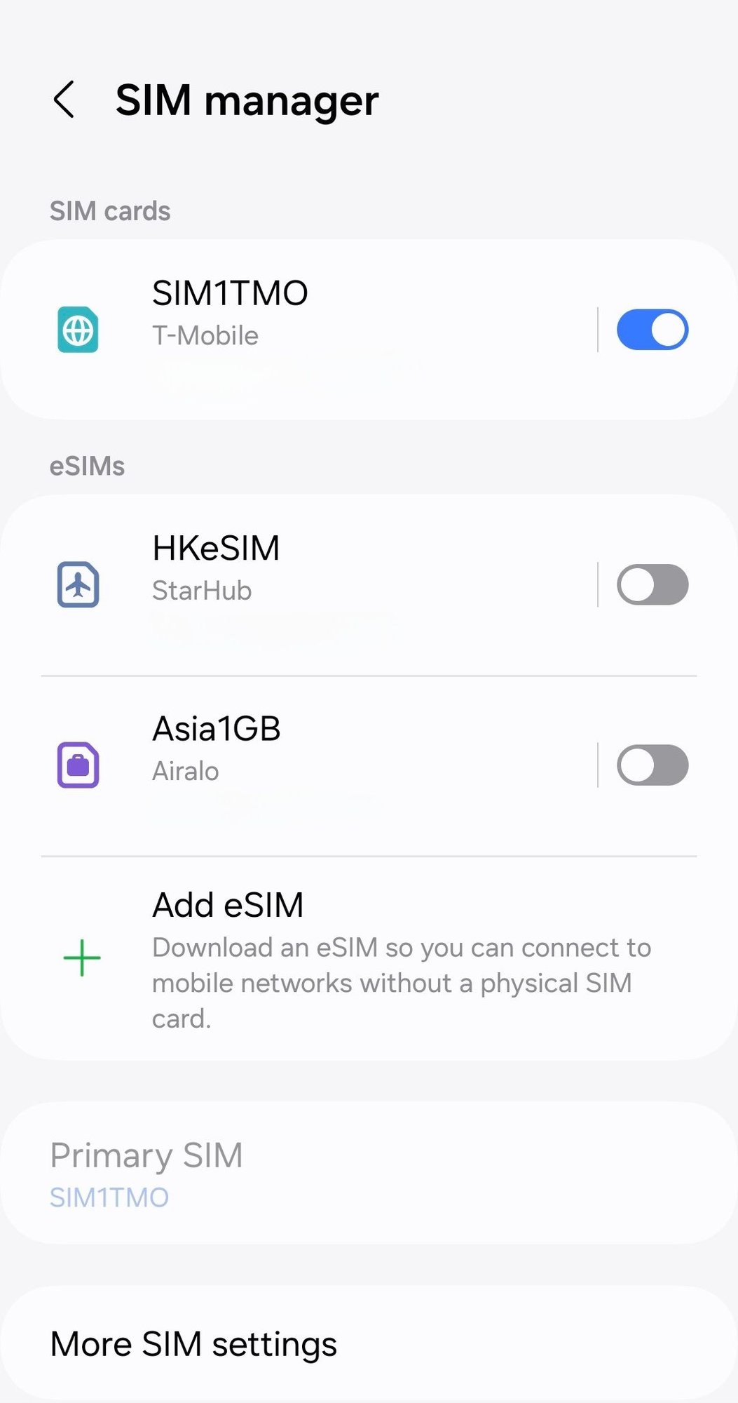

1--> HOW IS YOUR APN:
The APN is the software that deals with managing the 5G network connection.
When this connection is managed with less overhead, the WHOLE phone becomes snapier, not only the networking speed.

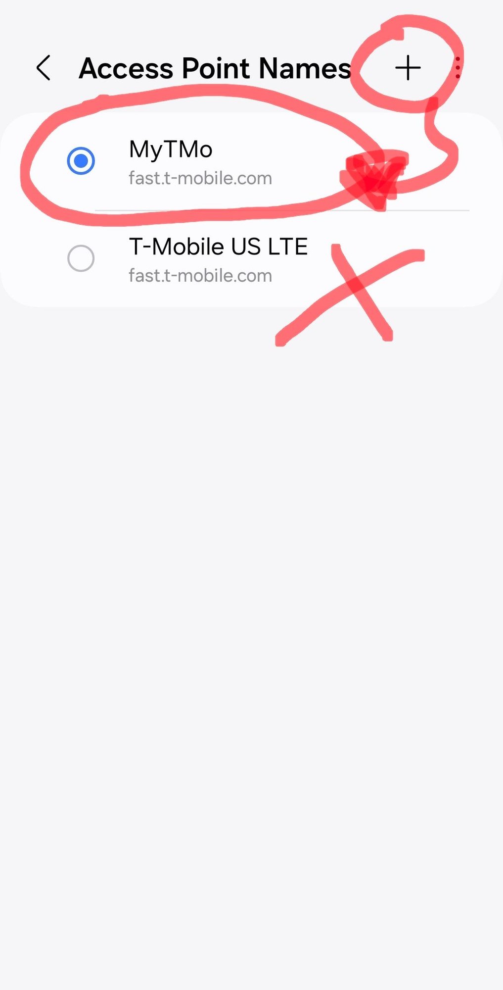

Enhanced 5G/LTE network setting:
We want faster downliad speed
lighter processing with less overhead
more compatible seemless tower hopping
Add a new APN connection
compare these settings to yours

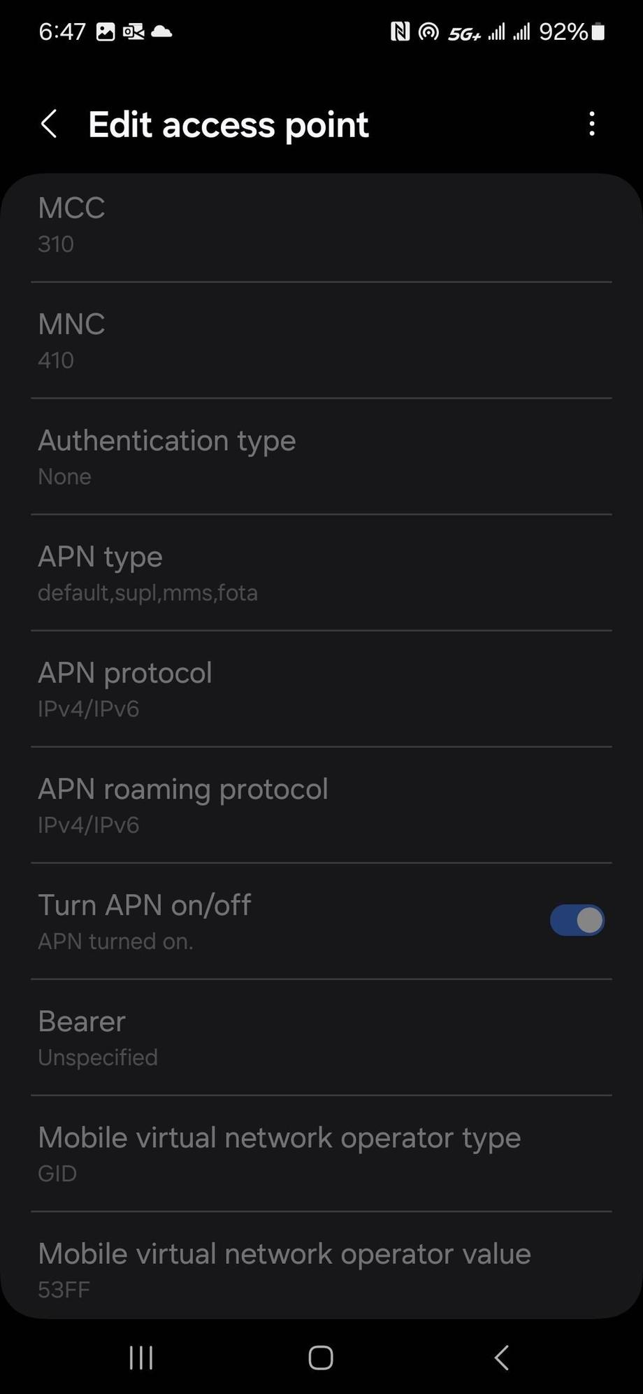

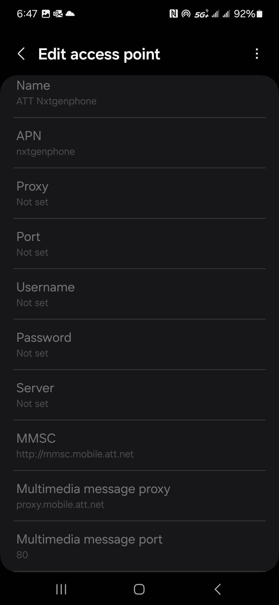

Thank you for the software and battery performance tips! I just completed those changes and will test the bluetooth response on my drive later today. Willing to try more developer tweaks if you have any.
I have a Galaxy S22 (SM-S901U) Dual-SIM, AT&T
Android 14, One UI Ver 6.1
See defaults below:
SIM CARD 1 (physical)-----------------Default name: ATT Enhancedphone
eSIM #2-----------Default name: ATT Nxtgenphone
Implementing new APNs with your settings have varying results. More testing needed perhaps.

Thank you for the software and battery performance tips! I just completed those changes and will test bluetooth response on my drive later today. Willing to try more developer tweaks if you have any.
See defaults below:
-Setting APN local protocol to only IPV6 present problems with apps not recognizing the internet despite having full signal from both SIMs. Chrome can view certain sites only. SpeedTest no longer can recognize/locate a network for testing so I can't compare speeds. Airplane mode and restarting phone multiple times give the same result. Switching that back to IPV4/IPV6 resolves that issue across the board. I will see if IPV6 improves outside more rather inside of a building
^^Apart from the above network issue, everything else appears to be working fine with the additional APN Type and Bearer settings. Again, I will need to have a more fixed test outside to see if there are any changes between the APN settings and speed test.

you have 2x distinct ATT accounts/numbers connected at once: SIM + eSIM.
I am familiar with their "nextgen" APN... I used to have ATT before I discovered unlimited 5G roaming data. ATT had the "roaming passports" data bundles.
Let's deal with the Internet data connection...
your's is setup from the eSIM side, right
Add an identical APN connection
Save the new cloned settings
Select the new APN to activate it
then edit the clone
change the APN BEARER definition
change the APN TYPE definition
save it!
Airplane... in/out
(leave IP:V4+V6 for both entries as long as it NOT limited to IPV4 only)
such as this:
match:  TYPE + BEARER for 5G+4G+3G

this is interesting to see all the various ATT APN definitions.
Each service tier is associated to a particular SIM that's enabled by account billing.
Meaning you don't get to successfully run the best APN of your choice unless it's enabled on the account.
Practically I think the "APN" field must be identical match (ex:"nxtgenphone") - You can try playing around as the very last step once you have all other best parameters. (SIM mismatched to a better APN is unlikely to connect).
> Disappearing Custom APN Definitions:
multiple eSIM....
multiple eSIM on-board....
When you switch SIM's the APN gets refreshed back to mint default. As a result, our custom APN definition gets erased clean.
I just came back from traveling in Asia using multiple eSIM'S... every time I toggled to a different eSIM, APN was cleared - As a result I became really good at writing fresh APN definitions and tweaking them in populated areas.
Once you're satified with yours.... take a screen capture before your best APN disappear one day.
Restarting the phone does not remove anything for our purpose.
