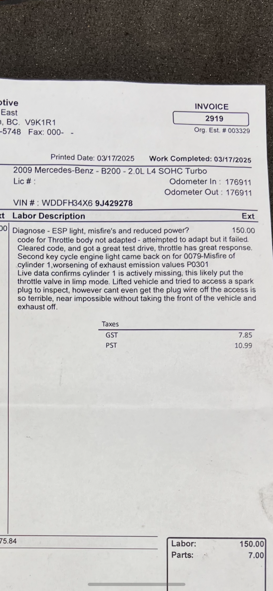

Old Apr 11, 2025 | 06:56 PM
Leviathan888's Avatar
Joined: Apr 2025
Posts: 13
From: Vancouver island BC
Work order from when the previous owner took it in
Old Apr 11, 2025 | 07:17 PM
CaliBenzDriver's Avatar
Joined: Apr 2019
Posts: 11,958
Likes: 6,802
From: Silicon Valley
W212 MY'14 M276-3.5NA @75kMi
This is weird one!!
Even the tech got confused:
misfire causing LM without code
what scanner are you using to help yourself?
The positive is cylinders are tested ok.
Only one little detail is causing this.
