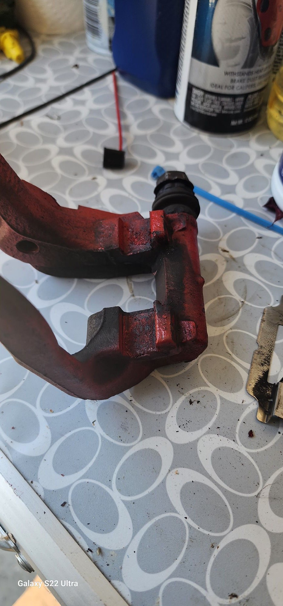

Okay went back over the entire braking system step by step removed paint from caliper brackets that hold shims cleaned and regressed with silicone brake grease, worked better for a while decided to drive it to doctors office and while on the interstate brakes gradually got worse until I pulled over then got a error message esc inoppertive, wheel speed sensor error flat tire monotor light, and triangle. I will now look Into wheel speed sensors / abs sensors. I will test them but probably just replace all four as they are not that expensive, does that seem like a logical next step. I have a autel scan tablet bio directional and a Mercedes specific scan tool will see if they recognize the error since it is now in the dash fingers crossed again.

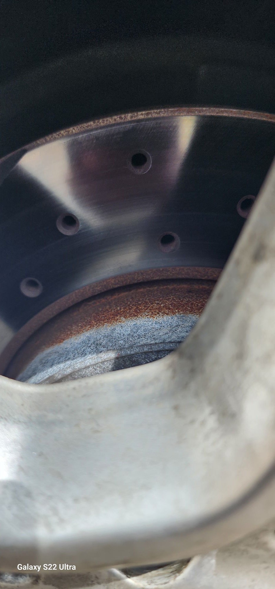

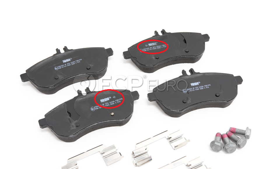

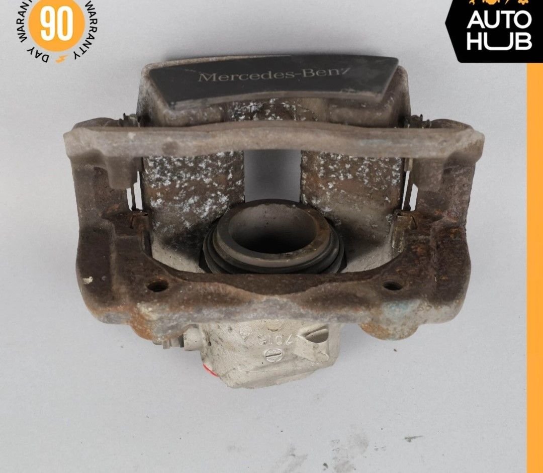

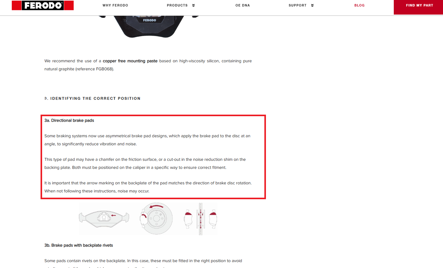

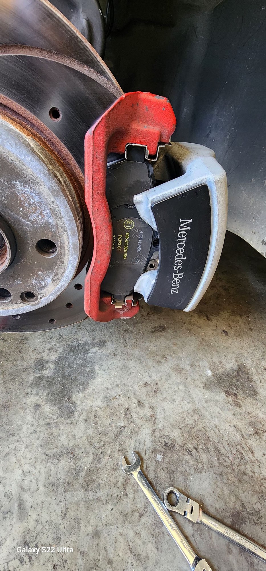

NEARLY GOOD BRAKES
Originally Posted by buddiec
Okay, problem almost solved:
Good news the disks and pads look fine.

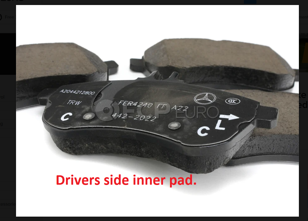

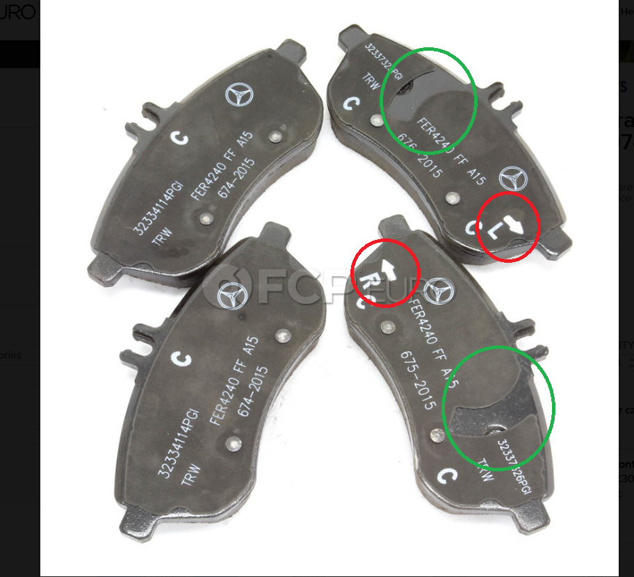

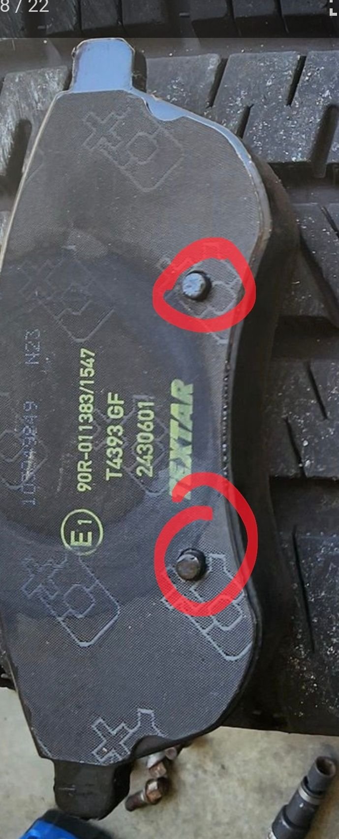

-1- Your inner and outer PADS ARE SWITCHED around.
The pads with niples is outer position
The pads with cutout noise-pad is piston side
Right now your caliper can't squeeze anything.
this is piston-side pad (NOT OUTER!)
NIPLES denote the OUTER pad (without piston)
NIPLES denote the OUTER pad side without piston
This pad shows piston marks, mismatched

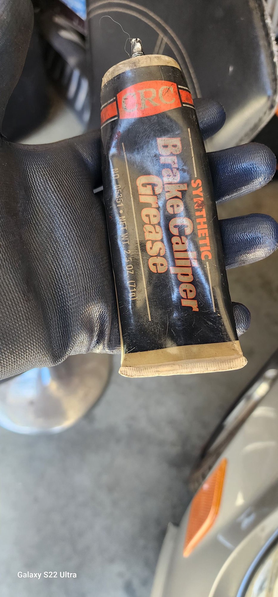

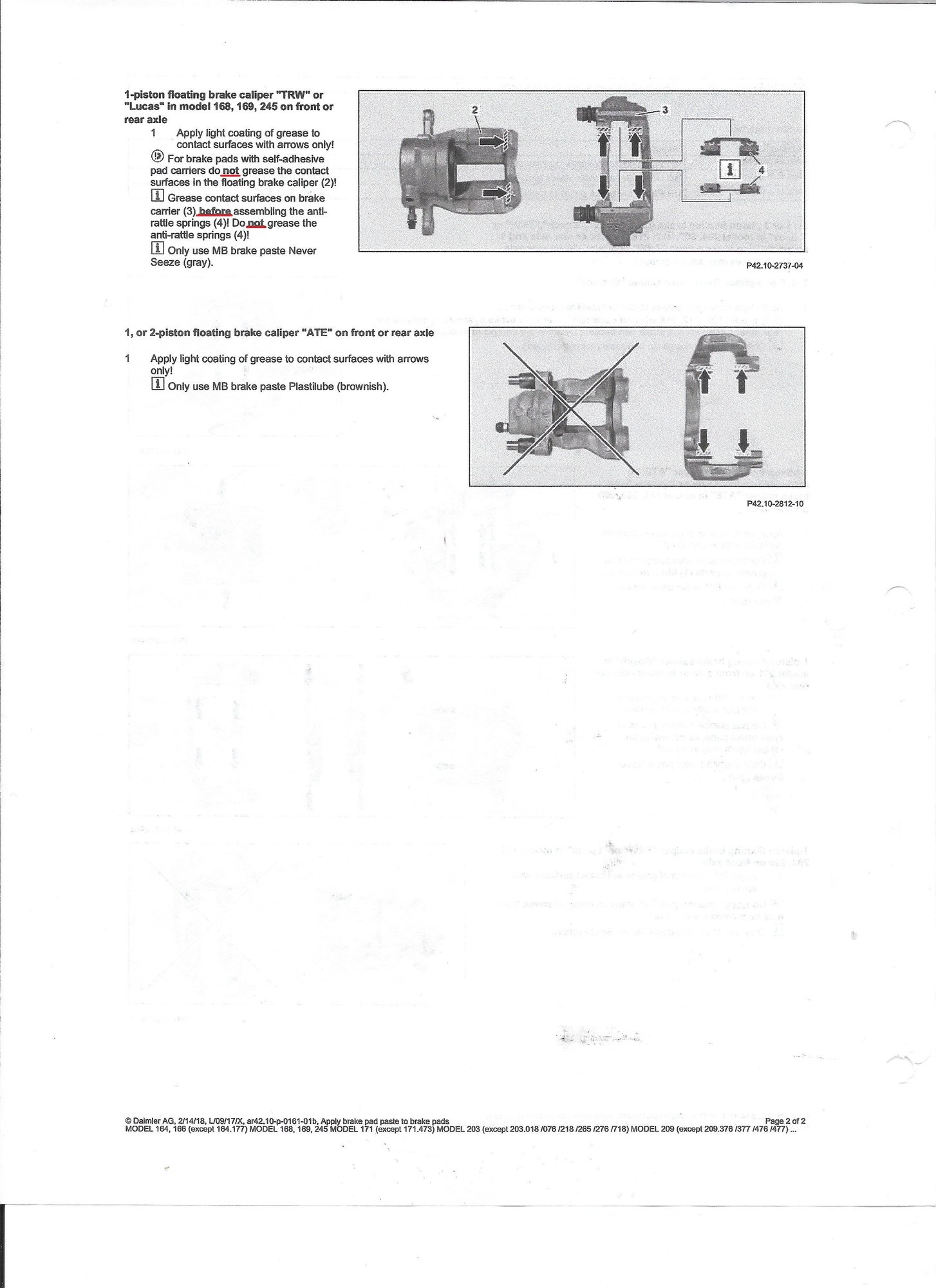

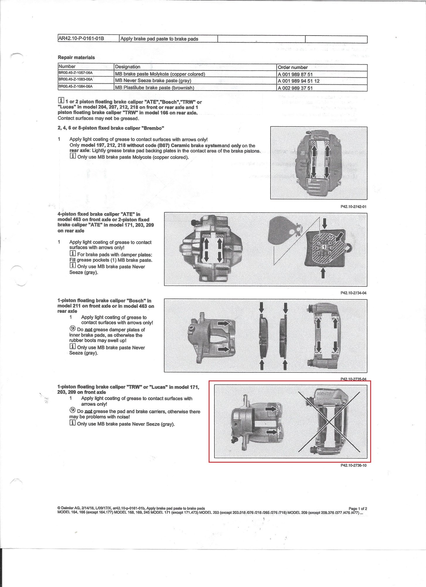

-2- that grease tube is an anti-squeak glue.
Do not use that on the slider pins. Clean the cavity with brake cleaner and use silicon brake lubricant.
use this or better
use this silicone lube or better. (don't pack the hole full)
I dont know what exactly is causing ESC fault.
Let's start with a working brake pedal. ESC should notice better working pressure.... if not it maybe loaded with air from MC + calipers replaced.
Needless to remind you to pump pedal after dealing with calipers else pedal to the floor without stop.
Next deal with pad wear sensor, usually one wheel.
Next deal with noisy pads rattling... use the cheap brake grease to glue the back of outer pad to caliper!
Enjoy safer MB
okay will swap the pads i also have that other brake grease which is what i used initially when I replaced the brakes initially funny because when I took them apart I wondard why the grease was clear and not black like this grease also the pads were installed by the indy shop in that order i reinstalled based on the whitness markings on the pads will redo again and test thanks for the info
Old May 24, 2025 | 06:29 PM
CaliBenzDriver's Avatar
Joined: Apr 2019
Posts: 11,922
Likes: 6,775
From: Silicon Valley
W212 MY'14 M276-3.5NA @75kMi
BRAKE PADS NIPPLES
I bet your new pads are sandwiched tight in between caliper jaws.
outer pad mounted on puston/inner side
outer pad mounted on piston/inner side
> 'SPLANATIONS:
-- To accommodate new pads + new disk
the piston has to be retracted all the way back in.
-- Now the caliper is forced to rest over niples that should fit in caliper holes on opposite side.
+++ EDIT: niples on all 4x front pads !?!?
So they nearly fit inner/outer besides cut on backing anti-noise material.
Strange to have niples on the piston pad. Caliper must have cavities for these niples.

Old May 24, 2025 | 09:27 PM
Joined: Apr 2019
Posts: 11,922
Likes: 6,775
THE PLOT THICKENS
Tim's 4x brake pads show us a clear view of nipples on both inner/outer pads.
4x nipple pads + piston backing cutout
> DETAILS MATTER:
Piston pads are differentiated by a cut-up backing.
Passenger vs. driver piston-pads are different.
specifically piston side pad
specific piston-side pad
I don't see nipples on thus piston-side pads (makes me believe nipples are outer side only!)
Make sure part numbers match what is necessary - Whatever caliper (genuine/upgraded) must accommodate the pads niples if present!!
Old May 25, 2025 | 04:49 PM
TimC300's Avatar
Joined: Aug 2023
Posts: 3,689
Likes: 1,110
From: MA Coast
I looked at photos of the genuine Mercedes pads and they are labeled left and right. So you can compare them to your pads for proper orientation. I'm assuming the pads with the half-circle cutouts go against the pistons, maybe designed so the pad is angled towards the leading edge.
I also noticed it appears the MB pads are stamped TRW and also FER4240 which im assuming is Ferodo. I found photos of Ferodo pads with the same markings. I just found that interesting.
Those center caps look a bit beat. Im always replacing center caps on mine either they break or they fade. Last set I got off Amazon because I wanted it quickly.
Old May 25, 2025 | 04:55 PM
Joined: Apr 2019
Posts: 11,922
Likes: 6,775
NIPLES GONE FLAT
the MB Pads have flat rivets instead of nipples.
Who knows how well OP calipers accommodate niples or flat rivets.... INSPECT brake ASSEMBLY for clearance space with pads

Old May 25, 2025 | 05:37 PM
TimC300's Avatar
Joined: Aug 2023
Posts: 3,689
Likes: 1,110
From: MA Coast

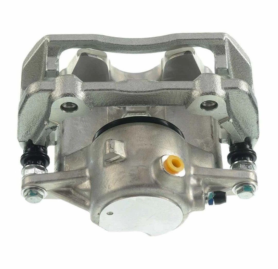

I looked around for photos of the calipers to see if I can see if those rivets or nubs line up with the calipers. On the piston side they wouldnt hit anything due to the piston, on the other side it looks like the rivets/nubs just miss the caliper.
Photos of used calipers are 4matic. The new caliper seems to be a RWD caliper, has a smooth surface no spots to accept rivets/nubs on the pads.
