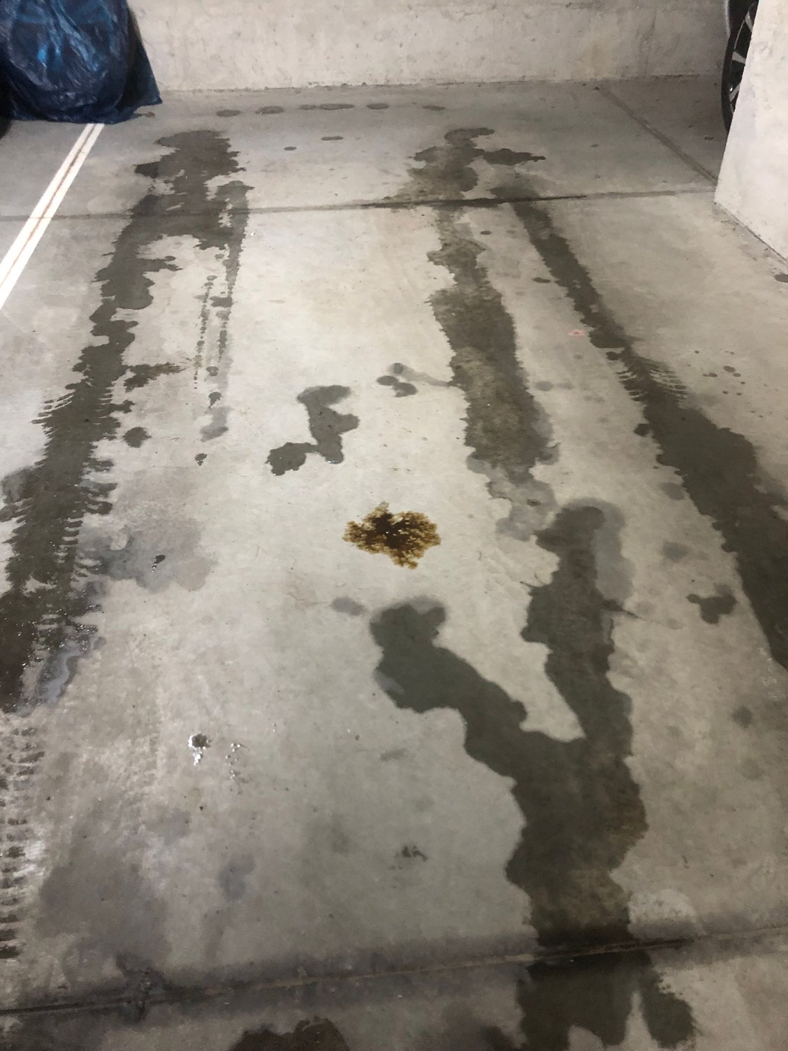

Here's an odd one. Got my car back from the shop last week. They found nothing wrong with my transmission. Still need to get a scanner. However, until today it was driving just fine.
Super heavy rain this afternoon. Not quite flooding, but puddles in road 2 to 4 inches deep I presume. I am driving locally, never got over 25 mph if that high. It's all hills and local streets between my son's school and home. Distance is less than 2 miles but mostly single lane streets with bumper to bumper traffic in this weather.
When I was in bumper to bumper and doing the stop and go, my tach went to 2,000 before the car started moving. I didn't hear the wheel spinning. I had just left it in D and C setting like always. I tried turning off ESP because I thought I once read that's where the turn off switch might help, and I think it helped a little.
When I finally got in my garage the car would not shift from D to Reverse. It just went to neutral. But I then put it in Park, and then reverse and reverse worked just fine. This was repeated several times since I have a tight spot I back into.
Anyone have this experience? Heavy rain screwing up reverse?
Thank you,
Sixcarbs

seems like a classic sign of low fluid level, but if serviced it should be good? id check anyway

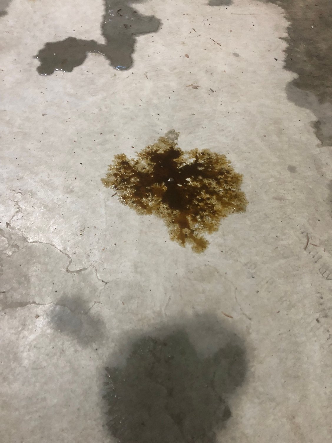

Just saw this when I moved car out. Never had this before.

PRND high water
this oil on garage floor doesn't look like it's been blue or red before...
it looks more like fresh engine oil.
The "PRND shifter" on the other hand has its connector all the way at the bottom.
It may have scooped puddling rain you reported.
Hook up your MB scanner to read the chassis fault.
ISM shares bus connection with :
  • engine
  • tranny
  • brakes
  • tank pump
Let see what evidence scanner reports.
  • engine
  • tranny
  • brakes
  • tank pump

The weird thing is the ATF color on the floor.... what kind of oil went in your gearbox ???

The ordinary engine oil says:
Ujle Mobil 3000 4/1
If what is on the floor came from the transmission something is very amiss because it does not look like ATF. Or it could be an uncorrelated separate matter??

The oil on the floor is engine oil, so no relation. Yes there is a rear main seal on the eng, but when it leaks it drops on the ground, it does not go into the trans. So your oil on the ground is a different issue altogether. Could also be from an oil change, since mechs often spill oil and may not bother to clean it. You just have to keep out for leaks and watch your oil level.

They are not evil, they are careless.
Having you drive around a drained out tranny is a disservice.
As far as ATF oil color you want to match what you have with what tranny calls for.
The picture of what was on the floor did not look like red oil.
I am sure their "compatible oil is the best".... "they always use the same..." "it's all the same..."
When you complain of rough shifts they won't volunteer a free ATF replacement ($800) but a rebuild job ($8000).
All normal.
