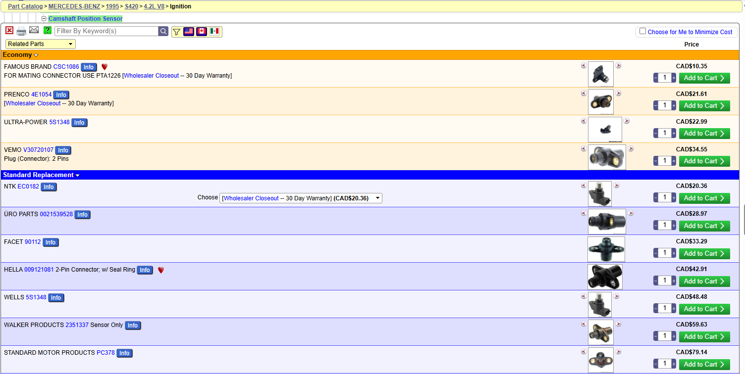

Failed Crankshaft Position Sensor
There seem to be a variety of them.
This is a reasonably priced part. How complicated it is to replace?
Will add it to my potential list of causes when I contact the garage.
