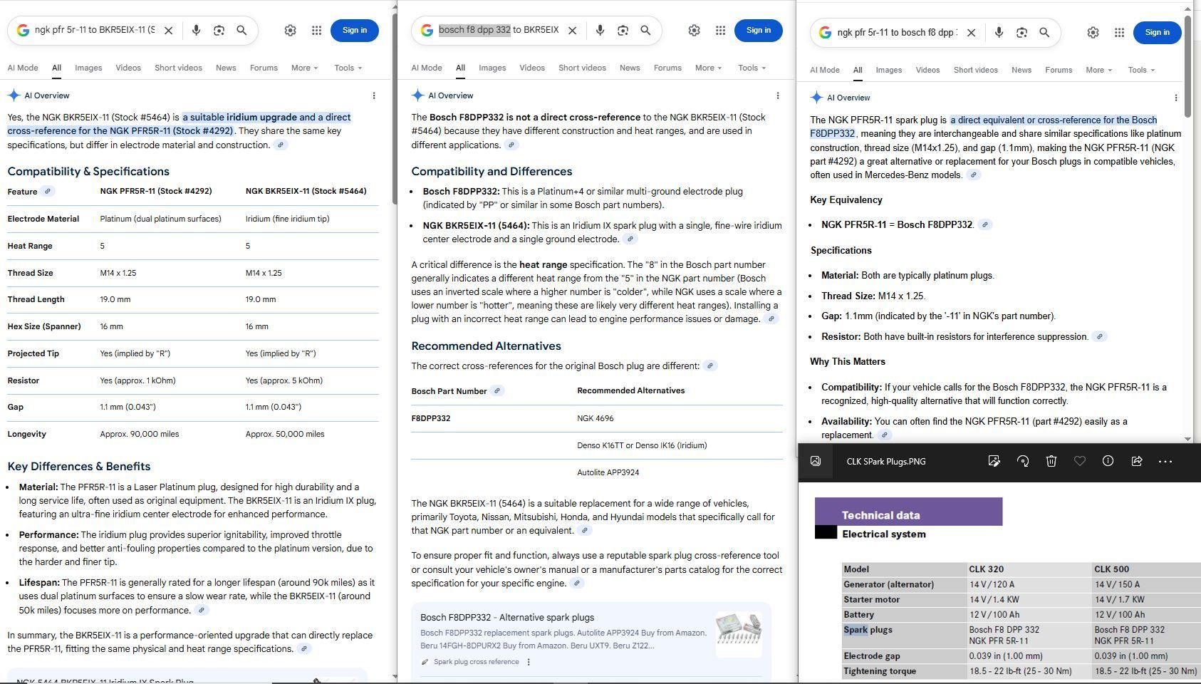

Old Jan 3, 2026 | 03:36 PM
Sixcarbs's Avatar
Joined: Oct 2024
Posts: 166
Likes: 29
From: Eastern Europe
2003 CLK 320 Cabriolet (W209)
Well this combination of searches is confusing.
The bottom right is the owner's manual. You can see the two different OEM spark plugs.
Column 1 shows the comparison between the NGK (OEM) and the NGK BKR5EIX-11 (That I have purchased)- Says Suitable
Column 2 shows the comparison between the Bosch (OEM) and the NGK BKR5EIX-11- Says NOT Suitable
Column 3 shows the comparison between the NGK (OEM) and the Bosch (OEM)- Says Suitable
How can A=B, A=X, and B ≠ X ?
Also interesting is the owner's manual says the Gap is 1.00 mm and Google says the Gap for all of them is 1.10 mm.
Old Jan 3, 2026 | 05:14 PM
CaliBenzDriver's Avatar
Joined: Apr 2019
Posts: 11,958
Likes: 6,802
From: Silicon Valley
W212 MY'14 M276-3.5NA @75kMi
Ignition Spark Plugs
AI tool is amazing how it can quickly be misleading. It does not think... wider gap is not longer spark.
The many attributes of spark plugs may be confusing: resistor, temperature, material, gap profile, brand, size...
