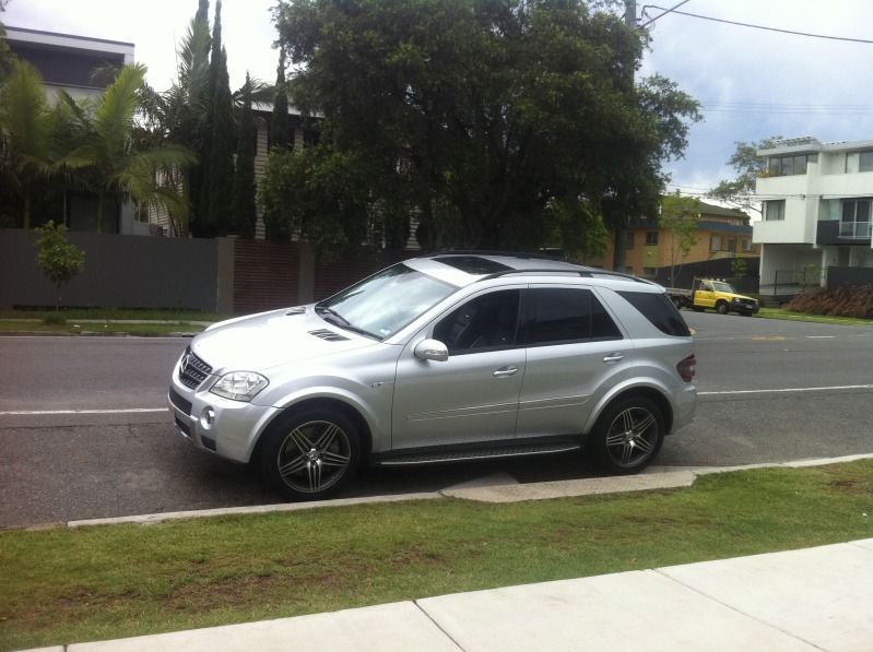

You guys get much better warranty options than we do here.
A CPO only gets 2 yrs and if you buy from a non MB Dealer, usually the warranty isnt worth the paper its written on. Covers things that usually never break or has a limit per fault (e.g. Max of $500 to fix a diff)
As for the car not being special, I reckon mine looks ok!
You should swap out those 19's for some 20's or 22's.
Those people driving their ML350 would sure wish they had your car when you go by
Yes, the US is the land of cheap cars compared to the rest of the world. I just came back from a trip to Thailand, where ML350s cost well over $100,000 USD.
My wheels are 20's, I think they were standard with 20's in the US. I've been thinking of replacing the wheels with the new style replica AMGs.
