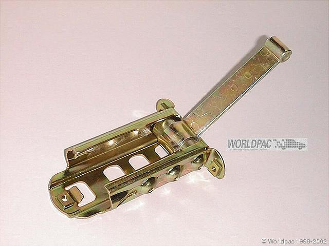

I have a '96 S320, when the drivers door is opened it makes a snapping or clicking type noise. Looking at a parts diagram it looks like there is some sort of Plate or something in the door panal that may have something to do with it. My quess just worn out catch or something. Before digging into it do you think this is the problem or is it something else? Thanks

This sounds like the door check strap to me, about $34 at buymbparts.com. This will require door panel removal but is otherwise quite easy.

Thanks Again
D _ Thanks thats the part I saw in a catalog. You are as usual a great help

OmeyHomey
OmeyHomey , On mine someone told me to try tightening the two bolts that attach the Door check strap. I thightened them and the noise went away. Give it a try I was glad I did.

excellent, do i just have to take the door panel off or what? any basic instructions? thanks again

OmeyHomey
OmeyHomey, check out the photo above in post. See the two nuts welded on the mid point of the door strap? the two bolt that are on the door where the strap goes into door are the ones you tighten. No removal of the door panel is needed, unless you end up needing to replace the door strap. Good luck.
