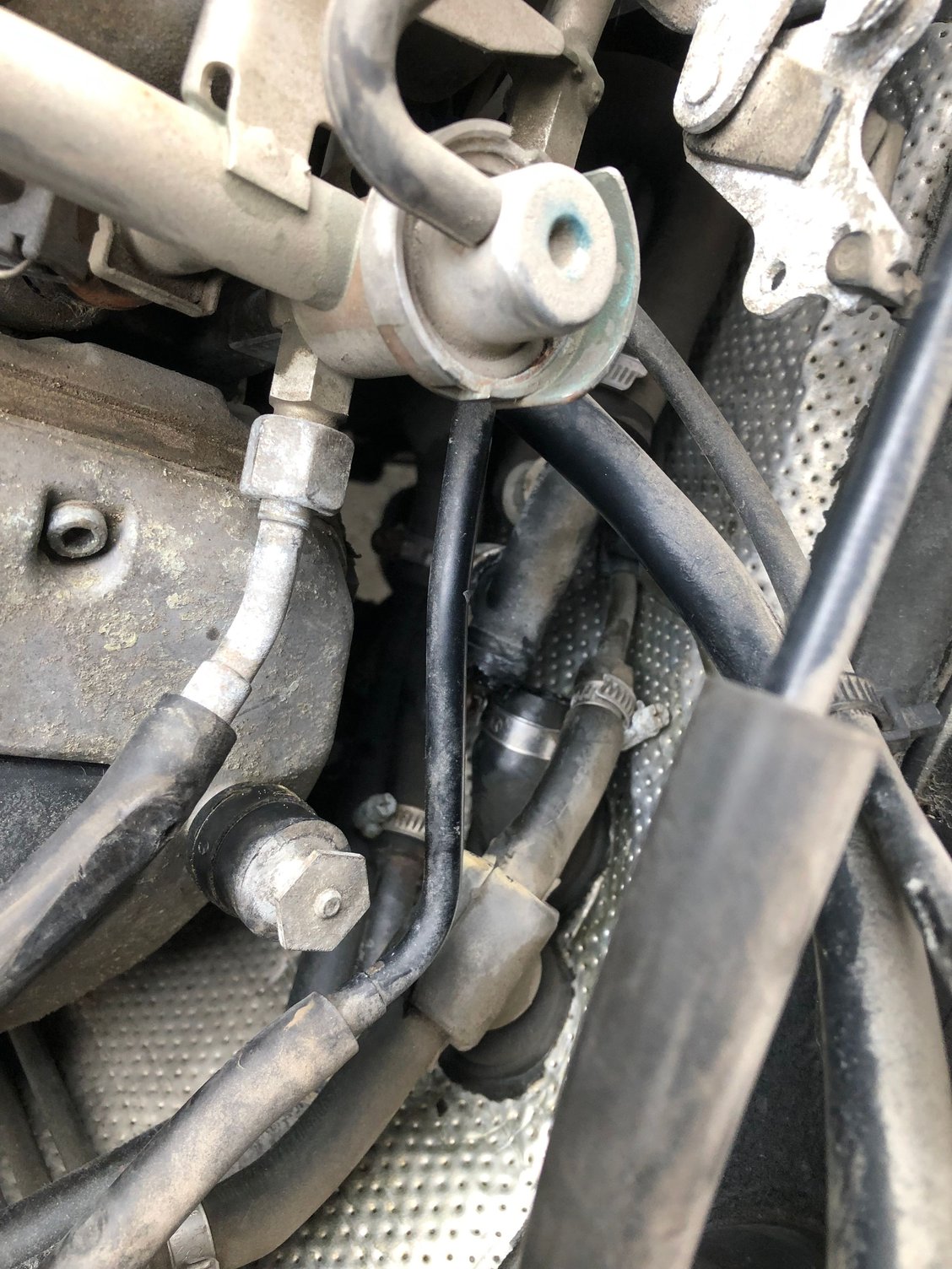

I found where the leak happened. (picture related)
Hard to get at so will leave for the professionals. Might require taking off some other hoses.
Blown hose/connector
The connector might be too damaged to reattach. Guess I will need one of these. Will order with the thermostat.
Thanks for the diagnostics/input.

wow its funny how across every Mercedes decades apart they always have some complicated nightmare coolant hose at the firewall that goes out before any of the main ones
