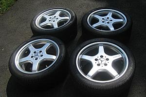

I have these original OEM AMG wheels from my 2004 SL55, if the style matches I would be willing to sell you a front and rear. send me an email and we can discuss rwlehm@aol.com
Attached Thumbnails Searching for wheels/rims for my s55 amg...04-4-wheels.jpg
