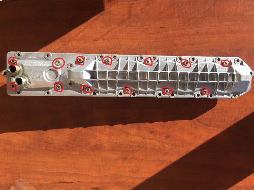

the Torx srews are the ones that come loose after you install the cooler and bolt it down.
retorque them

Originally Posted by kraut56
FYI:
retorque them
You're talking about the ones circled below correct?
yes!
yes!
Would you know exactly how many #'s it should be torqued at? I heard that torquing those might damage the gasket inside it. Also is that bit mentioned on the repair manual? Regardless, I'd like to do it, but if you remember how much you torqued it to, that would be great info. Thanks.

It's not in the WIS - I just snugged the screws up with a screwdriver. The gasket inside the cooler halves fails because it gets brittle from heat. It is a moulded O-ring type gasket, and is compressed by the hold-down bolts of the cooler. the screws just hold the halves together as an assembly.
Ok thanks alot kraut. That's good enough info for me.
