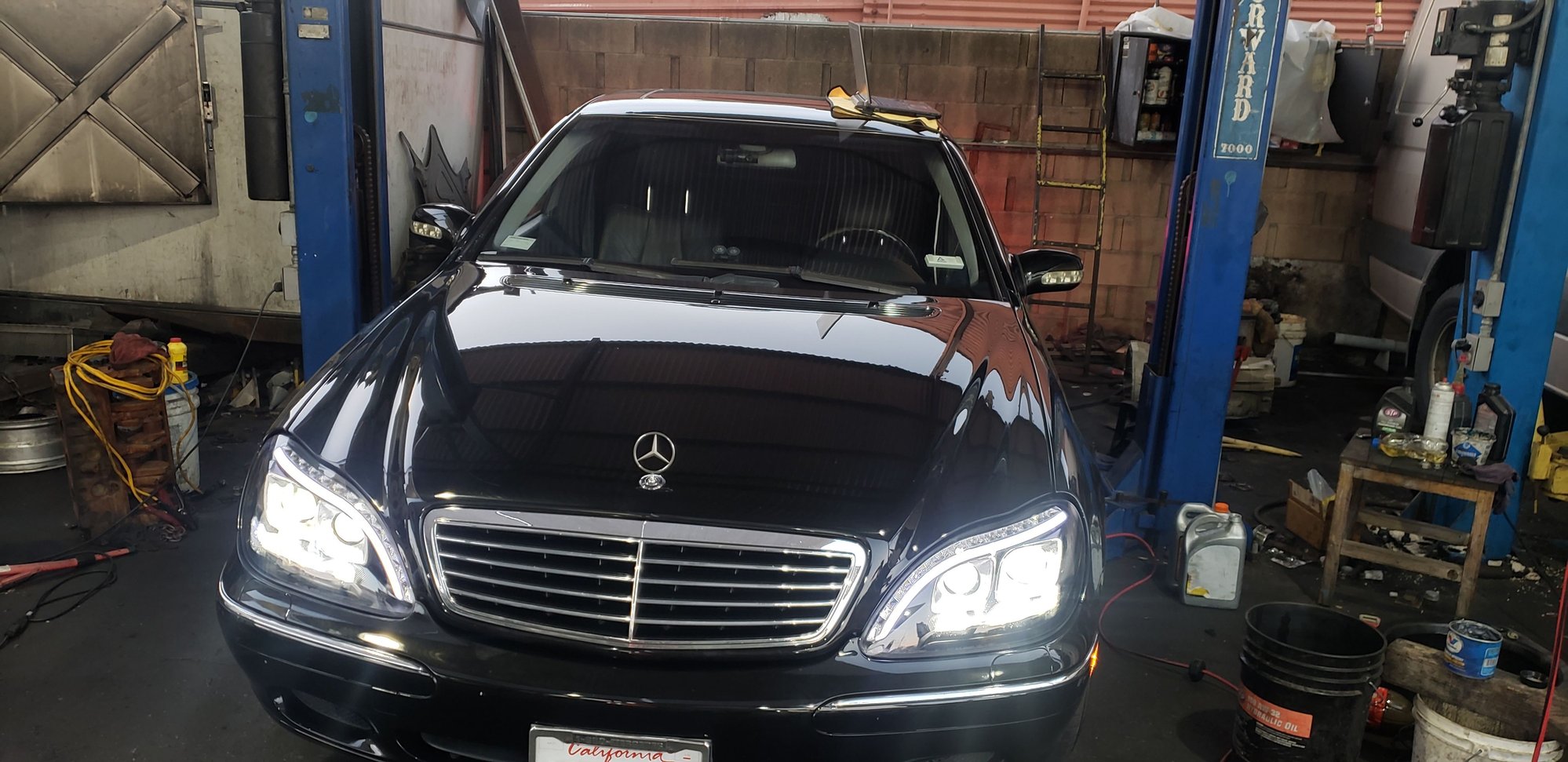

I'm going by mine. Where I replaced the same strut 3 times and it did the same thing. Car was even, but 1 strut had more pressure than the other. This is how i fixed mine. You can do it without this, but i was a bit nervous with releasing air out of the front struts while under the pressure of the car (And you have to be careful of the threads. So one needs to turn very slowly and let the air seep out. - Can be done after releasing as much air with SDS). Once all air was out a lowered car on ground. Then started filling them up evenly with SDS. Once there were close to normal height I started the leaving process making sure I was between 2.0V to 3.0V. Then took it for a test drive. And man oh man, was the right back to normal! Car drove straight and went up evenly over bumps and dips.
This may or may not be what you have to do, but it was the only way I was able to get mine back to right. And no more level error when on the freeway doing 80+
