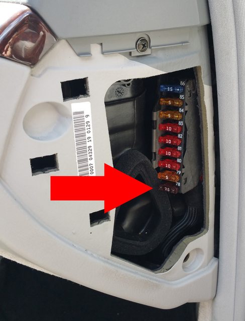

Problem resolved!
Fuse #78 in the passenger dash side was blown. Apparently in addition to driving the EIS module, it also powers the alarm.
The fuse blew immediately after replacing, and disconnecting the alarm horn causes the fuse to not blow, and allows the car to start and run and do all the things that it is supposed to do.
Speculation is that when the car was moved from Body Shop #1 to Body Shop #2 the alarm may have gone off, maybe overheated and shorted or otherwise failed in some interesting way; but who knows? The battery had failed and wouldn't even take a charge by the time Body Shop #2 got working on the car, so . . .the things that restored function:
1: New Mercedes AGM battery
2: Replace fuse #78, discovered there is a short in that circuit, isolated short to alarm system, disconnected alarm system, and replaced fuse #78 again.
In case this helps anyone else. Thanks for the tips and advice here, especially user WallyP.
