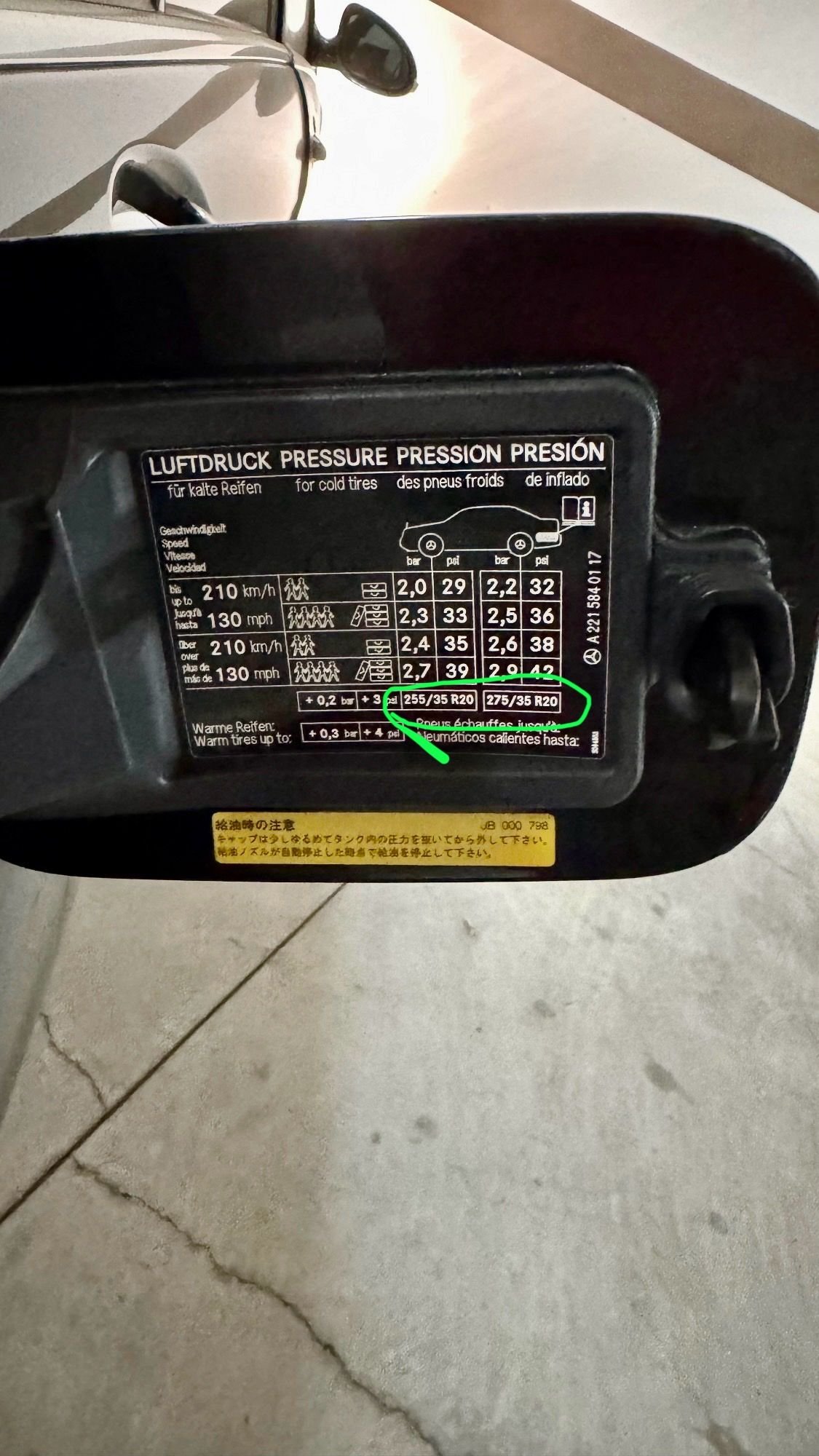

Old Nov 11, 2024 | 08:27 AM
Bimota1974's Avatar
Joined: Oct 2024
Posts: 9
From: Kuwait
WDD2211711A090086 Engine M273 5.5 L W221 Model 2007
tyer size
Originally Posted by E36c_AMG
I bought this type of rims:
Specifications:
Size: 20x8.5 Front / 20x9.5 Rear
Bolt Pattern: 5x112
Finish:Forged gun powder Face
Offset: 35 Front / 35 Rear
Hubcentric: 66.6
Original AMG says that these tyres must go front 255/35R20 rear 275/30R20 but i want to know can i put wider tyres without any rubbing or speedo/ESP problems?
good day :-
regarding the tyres width you have to check the mercedes Wheels and tires charters to be safe Also you can check the Fuel tank door the will mention to you if you can go for wider specially AMG car are different in the wheels and types size because the measurement is big issue that why you have to check the wheels and tires charters, the same thing i went through the every show the same but the car out of safety … check tire and wheels charters
https://www.alloywheelsdirect.net/in.../mercedes-benz
