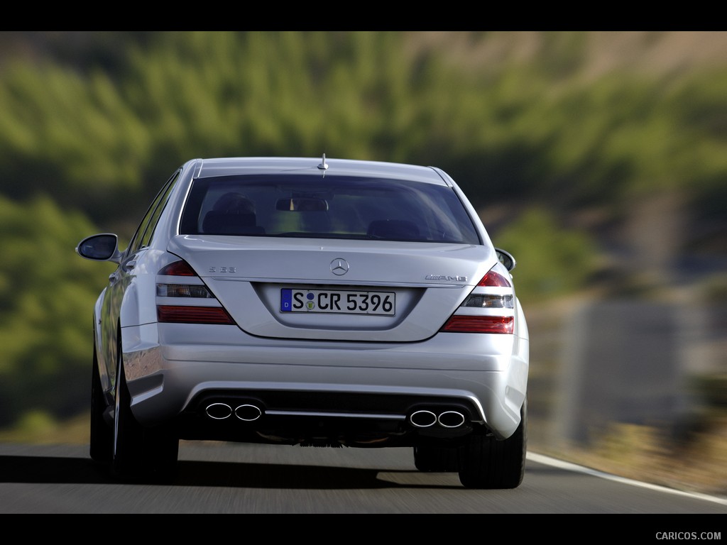

The exhaust tips look nothing like from an S-Class, never mind an AMG. The exhaust tips are part of the muffler and are chrome, the S65 having the tips connected while the S63 had separate exhaust tips, but were lined up.
Pre-facelift S65: http://img.netcarshow.com/Mercedes-B...llpaper_14.jpg
Pre-facelift S63: http://images.caricos.com/m/mercedes...7_1024x768.jpg
Facelift S65: http://www.netcarshow.com/mercedes-b...llpaper_09.htm
Facelift S63 2011+: http://www.carshowp.com/wp-content/u...Angle-View.jpg
Facelift S63 2010: http://600.mywallpapers.org/wallpape...escreen-10.jpg

Had S65 mufflers prior to S63 mufflers. Neither had vacuum operated valve and both outlets were separated by approx. 1.5 to 2 inches.
Both sets of mufflers bodies looked the same other than the tips. Almost looked like the S65 tips could slide onto the S63 mufflers.
You can tell if for S63 or S65 if inlet diameter is approx. 2-5/8" to 2-3/4" in. All others approx. 2-1/4" to 2-3/8" inlet diameter.
Weird how that part number does not come up on EPC.
I suspect those are for the facelifted S550 due to the inlets on the tips are somewhat oval.
