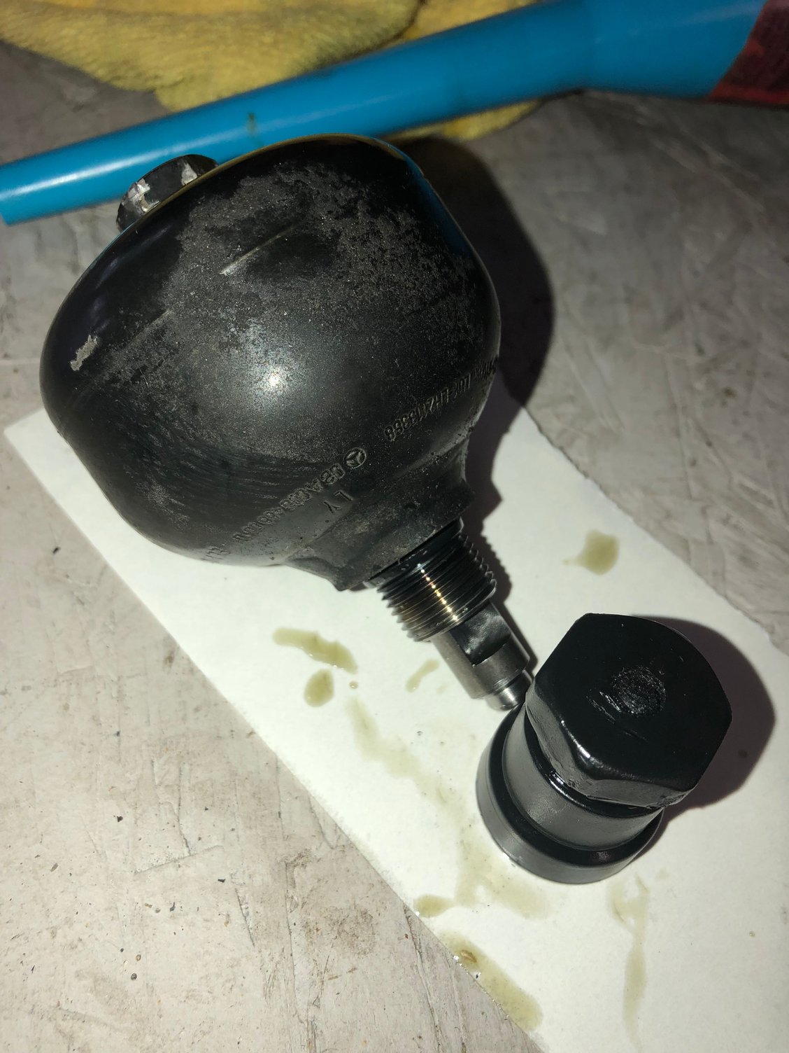

I got my new steering dampener "sphere". Is it normal for the opening to be "sealed"? I assume that is how the pressure is held until you screw it into place and that seal is punctured somehow?

I don’t remember mine being “sealed”, just capped. I just removed the cap covering the threads and screwed it on. I almost thought the cap was part of it because it’s black.

Here is mine. That highlighted area with the arrow is almost spongy in feel...
Old Jun 3, 2018 | 12:29 PM
Jtsnyder's Avatar
Joined: Jan 2018
Posts: 72
Likes: 16
From: Pasadena, California
S600
See that’s why I was confused at first. If I remember correctly, that whole end with the hex head is the cap. You remove that whole thing and then the spongy part comes off with it. I didn’t realize it until I removed the old one and noticed they didn’t match until you remove that cap.

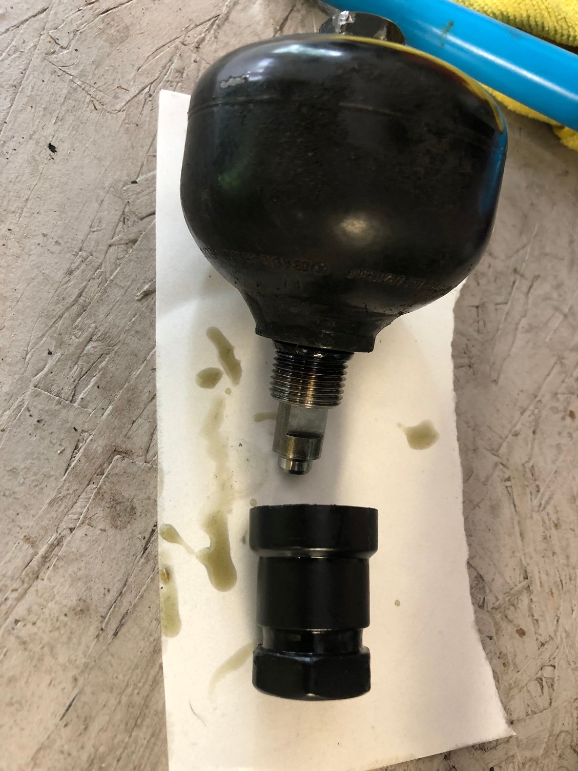

Yes! I was JUST going to post this. I was about to start trying to dig out that foam but thought, "no, pull the old one out first". I panicked that I got the wrong part for a second, then it hit me. Duh. For everyone else, here is the old one, along with the world's most overbuilt cap

Only part I had to remove was the "snorkel" that attaches (poorly) to the front of the car. I got some scraped up knuckles, but the whole job took 5 min. I shudder to think what a dealer would charge.. It seems to have addressed one of my problems (a knocking sound from up in that area upon start up and backing out of the garage). I'll get it warmed up and see if the other issues also clear up. Fingers crossed!
