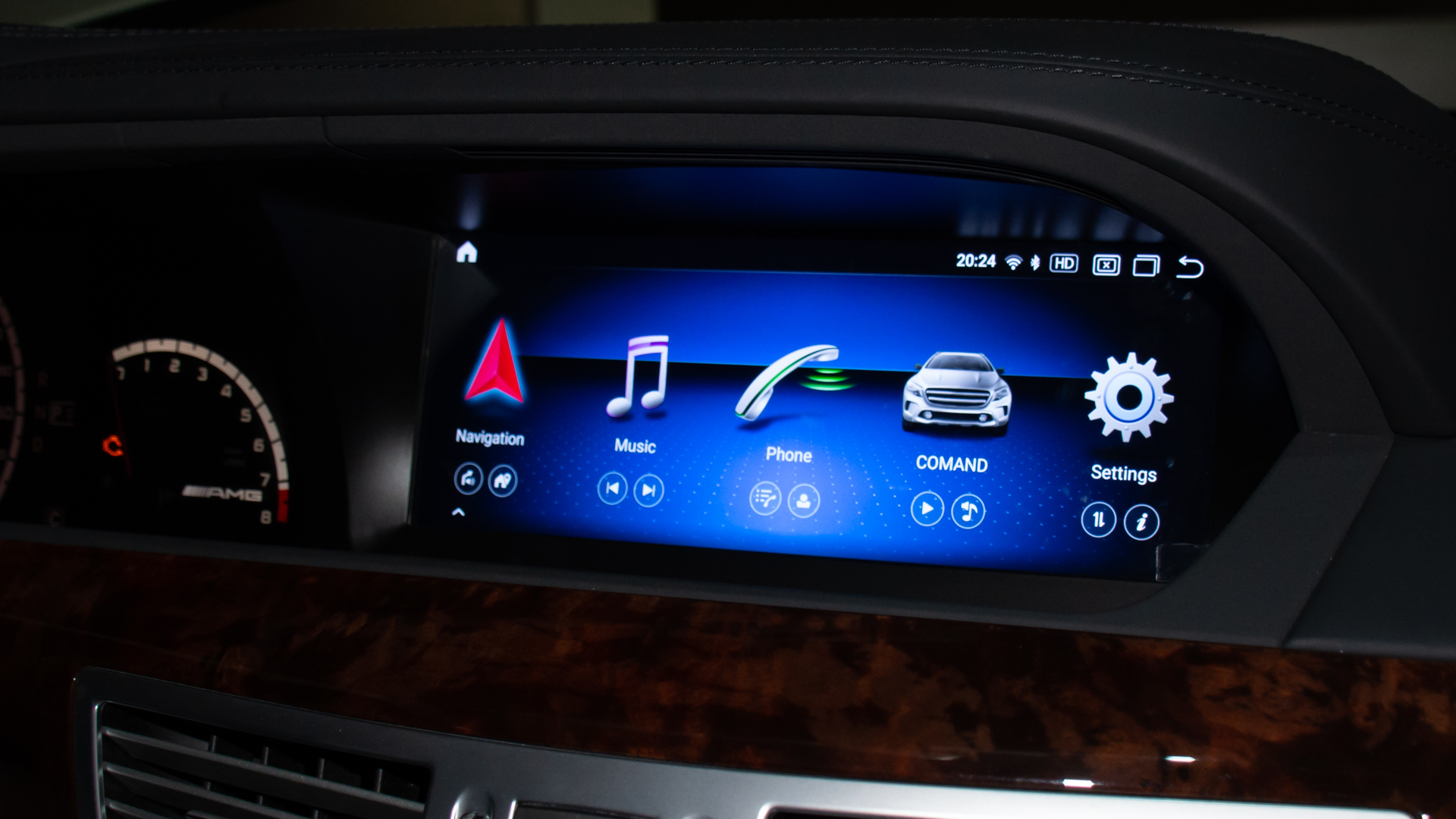

BTW. thanks to the support on discord channel #benz-specific, I managed today to compile and install my first launcher... I AM SO HYPED Now ! The possibilities this thing brings are just crazy... I can't understand why beemer community had this sorted out long time ago and even created a small business model around it and here nobody does these things Is anybody else seeing a niche here too?
My before and after pics:

Originally Posted by amgs63dxb
You retain all OEM features (although I am still struggling to get the seat controls online when using Android - it does not want to get there directly when pressing the button, I have to first jump into NTG mode, which is not the best, but I'm harassing my seller to address this ). The new display basically takes over your OE Comand display and provides an overlay. When you need to go back to your OE setup, simply choose the NTG from the menu (or hold "back" button for 3 secs) - it will fall back to the original "Comand" layout. When you are in NTG mode, tap the screen to go back into Android mode (or hold the back button again).
Hi, your screen looks very nice! Also thanks for the input!
I have few more questions:
1) Which seller or device is the most stable? I see you mentioned "your seller". Before I though this topic is dedicated to a specific device.
2) Can seller really fix things or they just resell stuff and ship it straight from China while providing little to none support?
3) Please could you send me a link for the head unit on your pics?
4) I don't understand what the difference between Before and After pics? I see different shortcuts/icons on the screen while the UI looks the same. Ok, the car icon looks different too.
Thank you.

@Sergey84 , there are several types of Android units out there. What you want to get is the latest and greatest unit based on snapdragon 625 with 4GB of memory (amount of flash storage - 32 or 64GB is a secondary thing here). Although they say it is possible to install Android Q (10) on earlier devices - you don't want to do it. Have a look at this thread on bimmers forum. When talking about 10.25" units - they appear to be identical from the what's-in-a-box perspective. Installation is also plug and play but varies based on what input type does your car model have. Scroll up this thread to see how different users solved different problems.
The operating system on this unit can be updated in 5 minutes using the OTA updates (over the air?) - you just download the zip and drop it on a USB, plug and play - works like a charm. Couple of days ago the latest Android 10 update was numbered 2.3.6. The second part of the device is the micro controller (MCU) which is responsible for all I/Os and communication with the car via CAN. This is the place where it is important to match the mcu you currently have with the one available online. This is also the thing you ask your vendor to help with if there are any issues with the unit.
When researching your seller, simply ask them question to send you MCU information (version installed) and OS version (which Android is it). Later on you will be able to source updates from the community.
As for your questions:
1/ I did not buy from aliexpress, but from a local shop, so the box is totally unbranded and the only contact I have with the factory is via local reseller... MCU version dFY suggests Cardesign / Wincago as a MCU vendor.
2/ Either your seller... or the community - this is where things happen really fast -> Discord.
3/ As explained - can't do that.
4/ Launcher app got updated using KSWOverlay project (also Bimmers...). With this you can pretty much edit anything in the menu. Or pay $10 for an entirely new theme (as long as these are available). And I mean everything - background, icons, sizes, layout... e.g. plenty of folks reconfigure the whole thing to display only three icons there. I was so excited because it worked so nice - I managed to put a fairly good looking car icon and replace navigation with Google Maps icon + put Android Auto where Music used to be (I don't use anything beyond Android Auto in the car, so I'm actually now considering rebuilding the whole launcher to look like something entirely different).

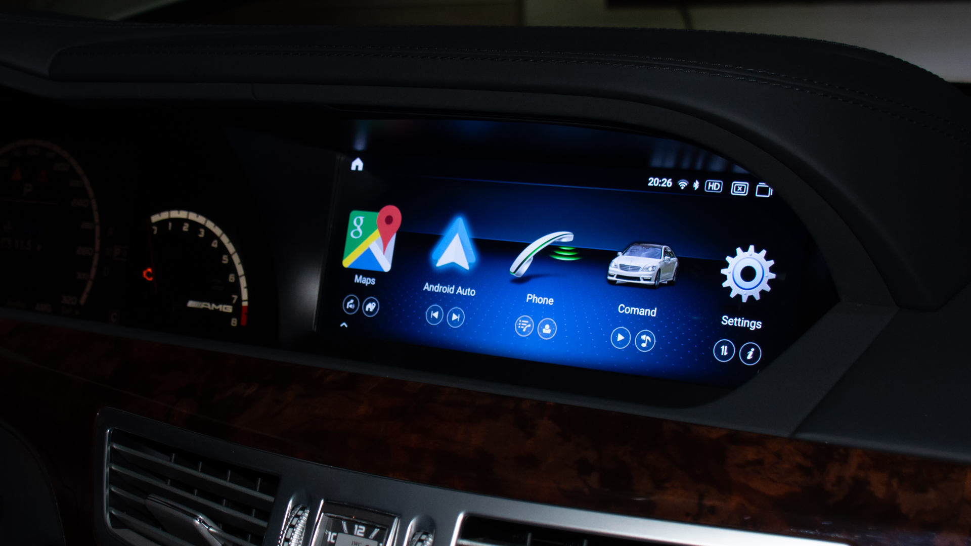

another small iteration of the theme... this time a bit more time spent on icons and background... I don't know what is more fun - using it or customizing the way it looks
another small iteration of the theme... this time a bit more time spent on icons and background... I don't know what is 0more fun - using it or customizing the way it looks
Please remind if it's a 10" screen or different? What is the resolution? And the last one - your hardware specs are the ones you mentioned above? Thank you!
Old Nov 3, 2020 | 10:32 AM
  #445
amgs63dxb's Avatar
Joined: Jan 2020
Posts: 262
Likes: 106
W222, W221, W218, W211
Correct... 10.25", 1920x720 with 8 core snapdragon 625 + 4GB memory + 64GB flash.
where you got the icons?
