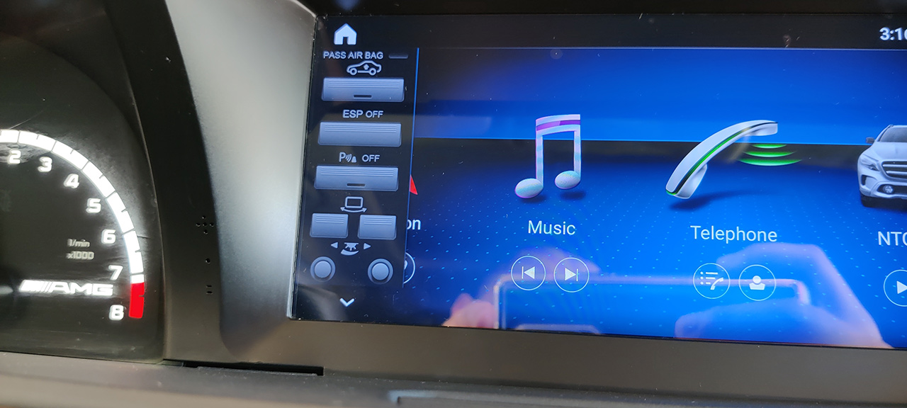

Esp buttons
Originally Posted by amgs63dxb
Hey guys, I am new to this.
I have this same exact screen, how do I get that little arrow to appear? On my bottom left there is no arrow at all
Did you select the correct version? What do you have NTG 3.0 or 3.5?
Old Mar 8, 2023 | 07:33 PM
  #694
Rringer327's Avatar
Joined: Mar 2023
Posts: 35
Likes: 12
2010 Mercedes S550
Esp buttons
It says protocol type 3.5. if that helps

did you plug in the single lin wire?
Which one does your car have?
​​​​​​NTG 3.5. With the 4 pin. I used to have the arrow at the bottom of the screen there. To show the esp buttons, But now it's not there anymore

Originally Posted by johnksss
Ummm, no. the single lin wire that is for your controls to work.
Unlabeled (1 Pin) like in the picture. That has to be plugged into the factory 3 pin cable coming from the car.
If all that is plugged in correctly then it's something to do with the software settings.
Yes everything is hooked up. I just can't see that little arrow anymore

Can you take a picture of your screen and post it right now?
And a picture of your default screen showing the original factory screen.
Thanks.
