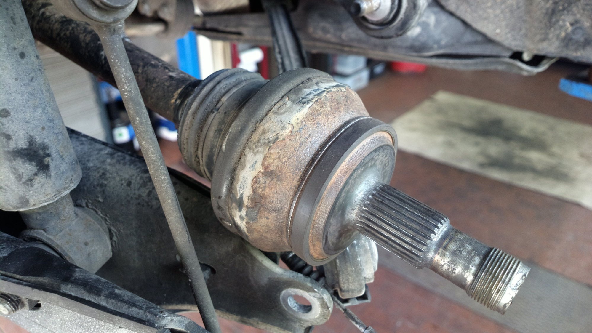

Abs Reluctant Ring W221 Rear Axle

I replaced Abs Reluctant Rings on both sides and wheel speed sensors. So far very good.
