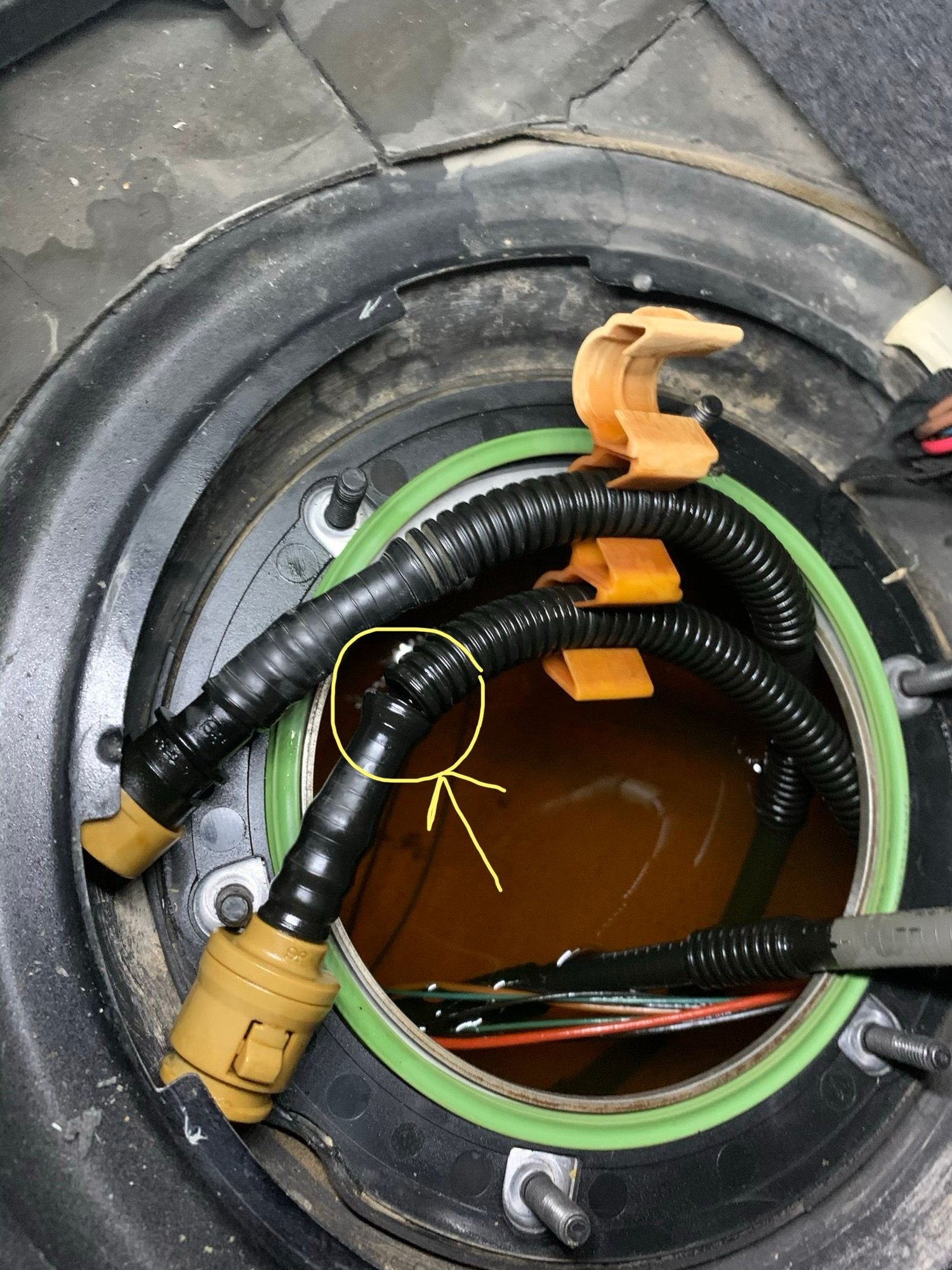

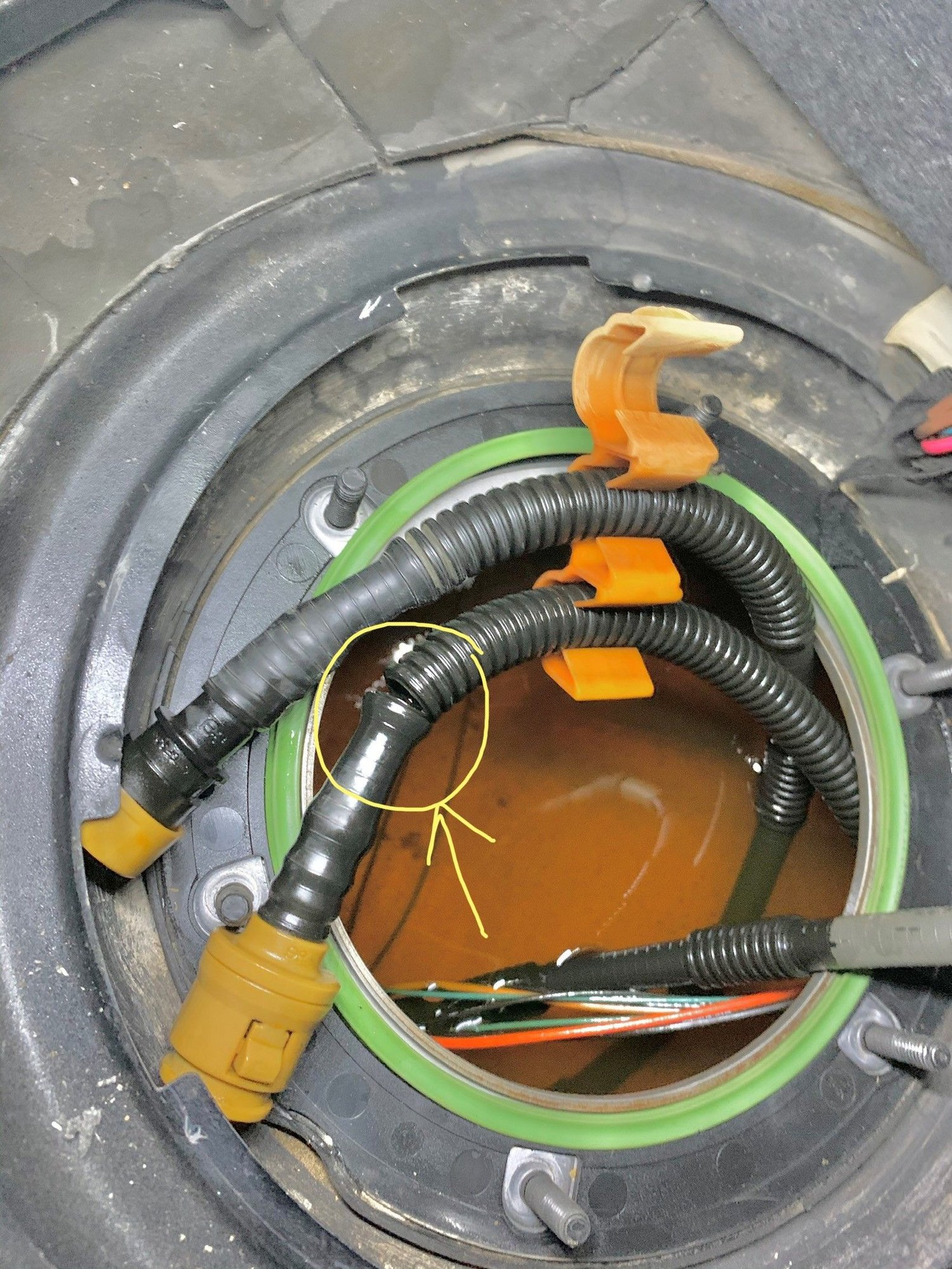

It was a cracked fuel line inside the fuel tank.
The corrugated nylon fuel line coming from the fuel pump to the sending / filter unit.

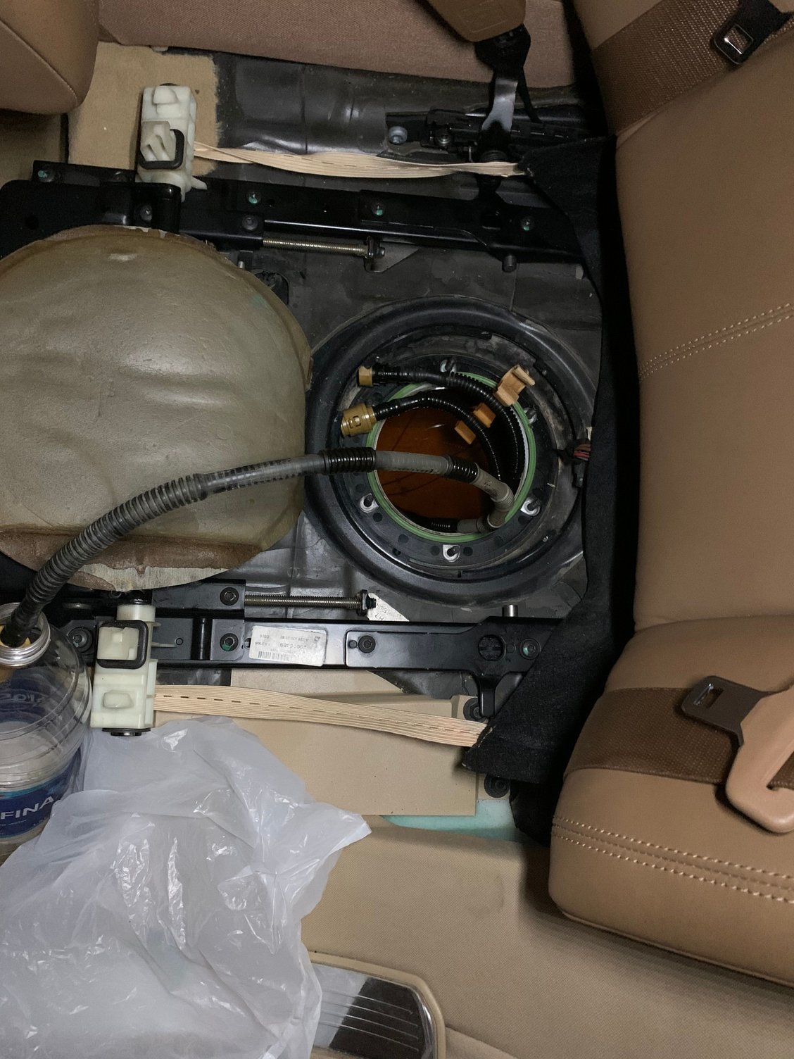

The line coming from the right part of the fuel tank where the pump is under the back seat going inside the tank to the left part of the fuel tank "to the filter".
The crack place is described in the attached photo.
I was shocked and still do not believe this:
I must replace the complete fuel tank.
I cannot replace the cracked nylon fuel line.
I could not find any information about these three nylon lines going to the filter / sending unit. "Photo attached".

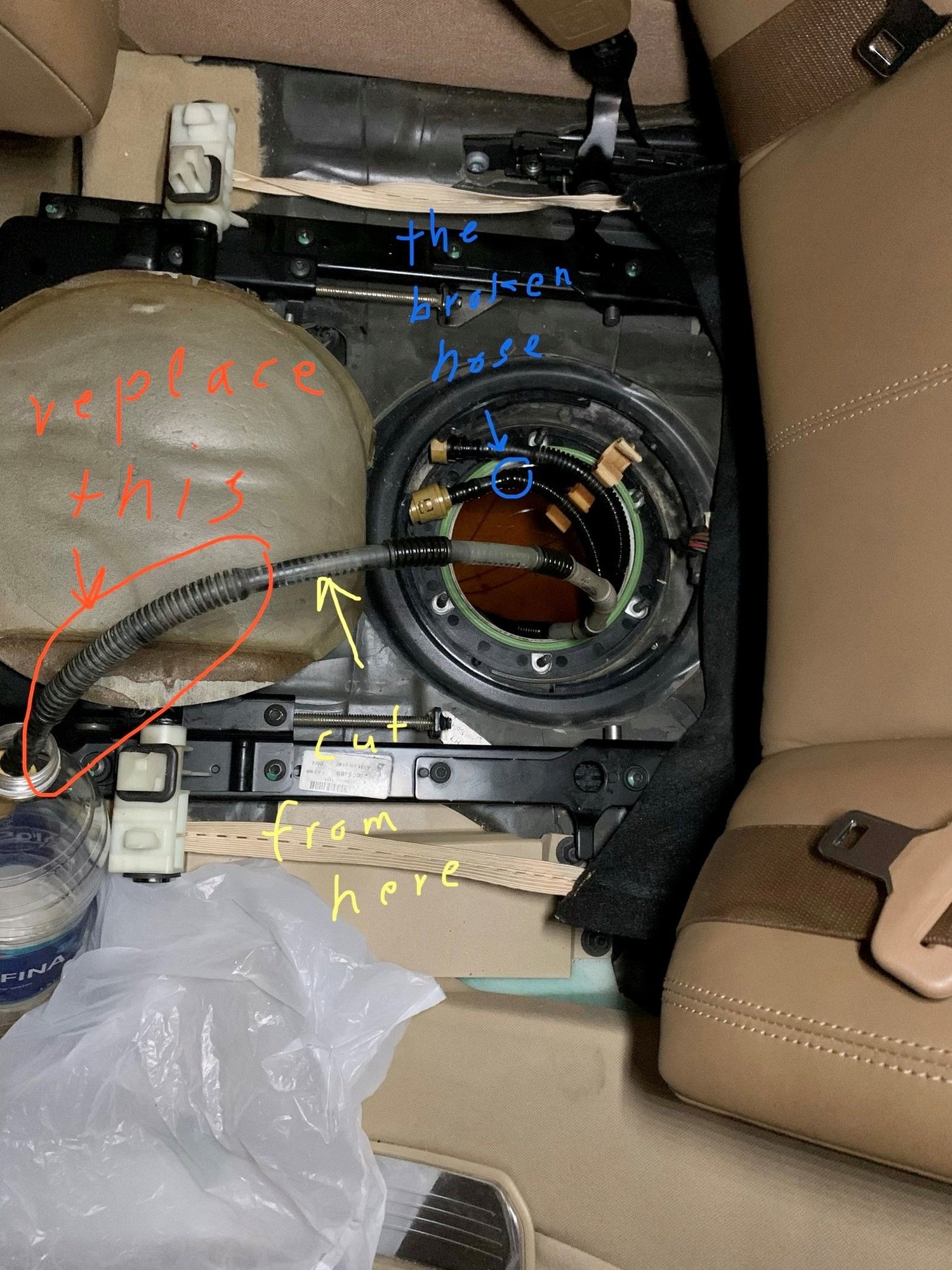

Check with mirror where this line going. If it’s going from filter to pump then you can replace the broken line relatively easy.

This is really make me happy, because I think it is hose coming from the pump.
I'll check these after emptying the fuel tank.

It is the line coming from pump to fuel filter.
Can you help me in getting this plastic hose or if you have any information about it .
Or if you can advise me in this regard,
And appreciate your help.

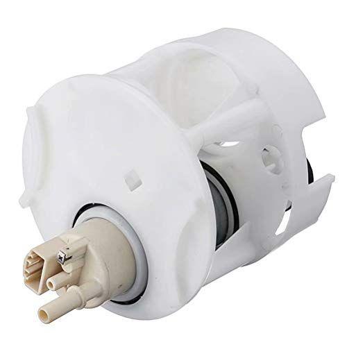

You have to be creative on this one. You can purchase fuel line hose in your autoparts store or purchase MB fuel pump like this one: 2114706094 with hose attached and reuse only the hose.
Take the broken hose out first so you know the length and diameter so you can find hose with same length and diameter.

yesterday i have rechecked the fuel lines.
and it was theline going from fuel filter to the engine. it is cracked.
not the line coming from fuel pump to the fuel filter.
Any help please..

As shown in this photo, there is one line coming from fuel pump to the fuel filter (the one i have take out side).
this broken line is coming from fuel filter and assume going to the engine.
I'm thinking to cut this line and attached a small line with suitable fitting to attach it to the old line and then connect it to the fitting to the fuel filter, as illustrated in the photo.

I just installed a new S550 pump in my car today, I used the :
Delphi Fuel Pump CFE0727 I needed it quick and ordered it from AUTOZONE, $315 and they had it same day. If I wanted to wait I could have had it for about $225. If you suspect a fuel supply issue just connect a fuel pressure gauge with a long hose so you can locate the gauge near your windshield so you can see it while starting and driving. The pressure gauge will show exactly what your pump is doing and if that is the problem. A 10 minute test can eliminate the unknowns as far as your fuel supply. They are good cars, it deserves to be reliable for you. Good Luck.
