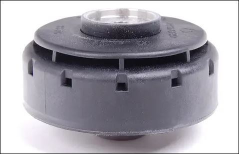

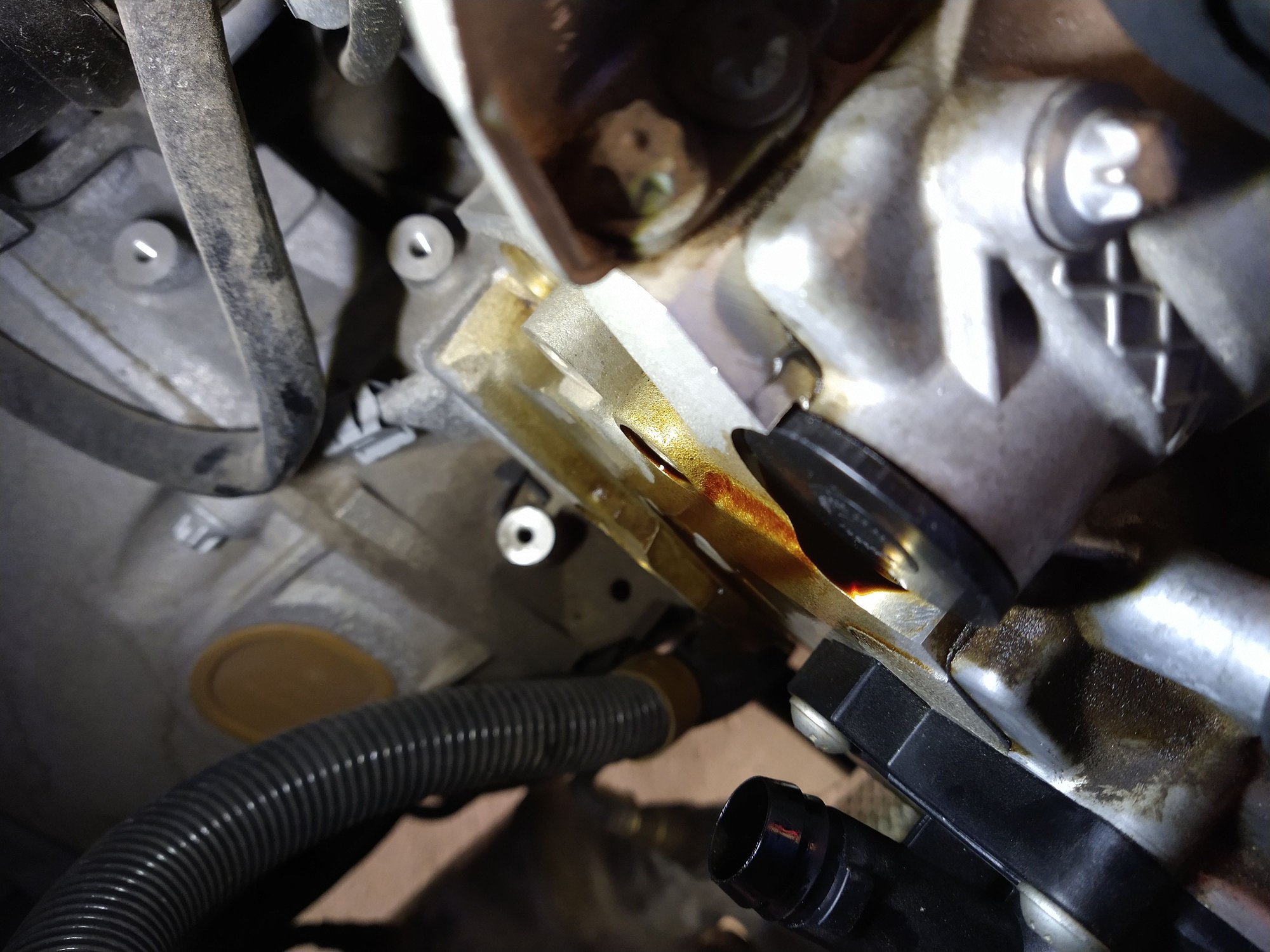

I have replaced the oil separator cover 3 times now and the oil separator. For the 3rd time (in two months) I spent extra and ordered genuine MB parts, it didn't help. I still have an oil leak. What else could be causing this? I am not consuming oil, tail pipe is as clean, no CEL, no driving issues. Is there some other PCV issue I am missing? Also I found this connector unplugged not sure what it does either or if it is related. Any help is appreciated...
Replaced this and the oil separator, still leaks... What am I missing?
Still leaking under these

Centrifuge look OK, bolts torqued correctly.

Yes, all torqued correctly, I mistakenly called the centrifuge the separator. It was replaced with genuine MB this third round of troubleshooting. Today I found a hairline crack in the oil filler cap. Wondering if that affects the crankcase pressure and somehow contributes to this stubborn leak. Replacement oil filler cap on order.

What does the mating surface of the centrifuge cover look like? Is a gasket or sealant required? It looks like not properly torqued (you ruled that out), missing gasket or sealant, or possibly cracked casting (seems unlikely).
Is the leak coming from above the centrifuge and dripping onto the centrifuge? Are you 100% confident in the source of the leak?

I am confident it is related to this oil separator cover as I've been inspecting it and after I replace it the oil leak doesn't show up for a while. I don't think I'm over torquing or under torquing the bolts.
Other pertinent facts with this issue
1) Engine oil level is appropriate2) I purchased the vehicle in August, it had the leak when I bought it. Unsure if the previous owner wrenched on it to repair and or cause harm.
3) I use blue threadlocker on the bolts. They felt good going in and out, do not think I over torqued, cracking the cover and or head.
4) I cleaned the mating surface of the head before installing the cover. Also cleaned engine bay under the leak, just using Windex and blue paper shop towels.

Is sealant or a gasket required per WIS?

The cover has an integrated gasket

After scrubbing and cleaning the engine mating surface really well and replacing a third time the leak has stopped. 6 months inspection, tiny leak, from the hose this time. Added a hose clamp, should be good to go. Lesson learned clean mating surface makes all the difference, make sure the mating surface is clean clean clean before install.

On my whirlwind maintenance tour when I first bought the car I did this job. Always inspect with a mirror (or directly when possible) ALL of the gasket perimeter. You must have had some goober on the head that you was not getting wiped but a mirror inspection should have revealed it. I'll have to make sure mine is not leaking....I don't think it is.
