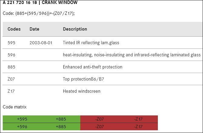

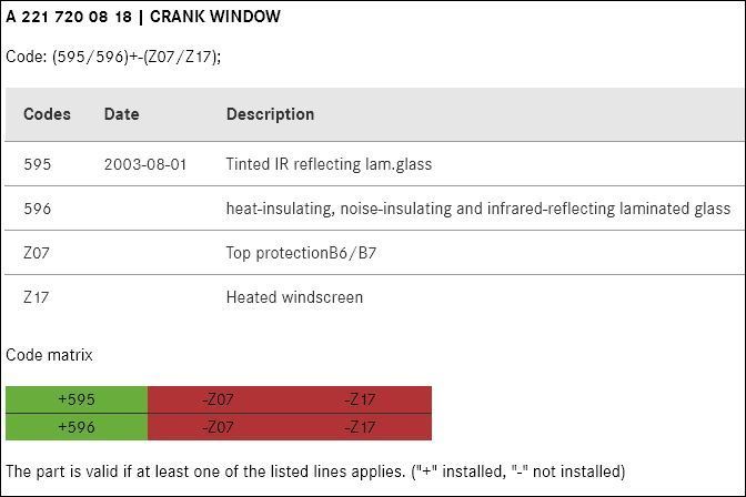

Help urgently needed. Right front door window. My Gardner have just destroyed the right front door window glass. And I'm now struggling to get a new on. As far I can understand there are several different types of the glass, with different numbers. Also different numbers for the same type double glass. Who to find out the right type?
There are obviously minimum two different types/numbers A2217201618 and A2217200818 both double layer of glass, what's the difference besides the numbers ?
According to the win number this is the glass fixed in my car; 596 HEAT INSULATING+IR REFLECTG.SAFETY GLASS ALL-ROUND

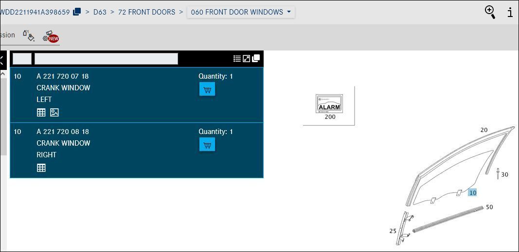

File Type: pdf
File Type: pdf

Thanks for your reply. I have found a new Used window, right front door, double layer but the number are A2217201618 - can I use that or just forget everything about it. Good day.
Shows compatible 885 enhanced security is roof mounted motion sensor should not matter.
Thanks for your help. So can I use the window I've found in my car ?
