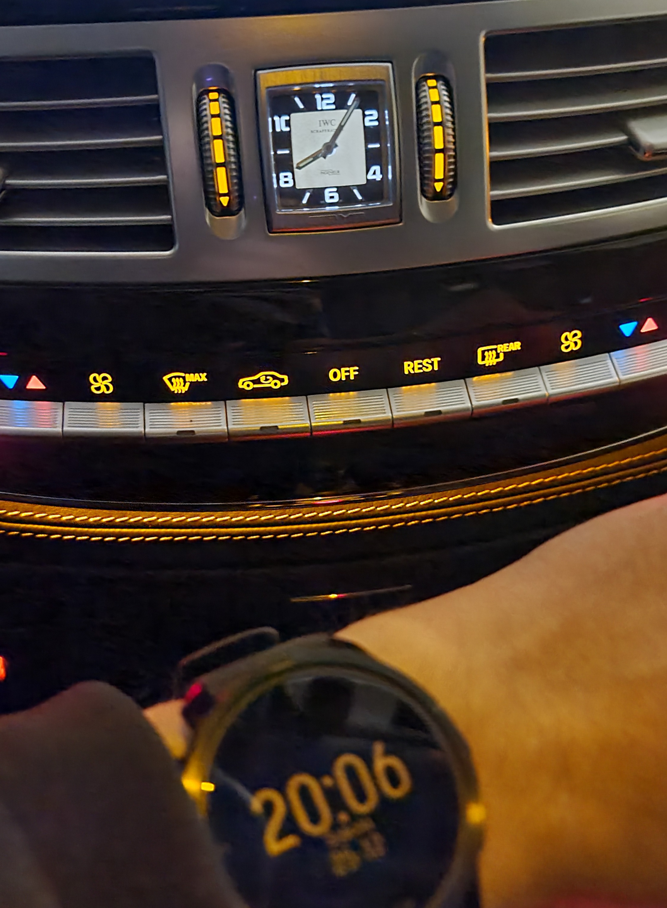

UPDATE:
The basement fix works. Disconnect the blue GPS plug from the rear of the Command unit, then disconnect batt at 1159 and reconnect close to 1200.
The clock “resets” itself once the power comes on again, and your dashboard clock is now good to go….
Thanks Gents,
VetteBK - we can’t use the Command menu to set the time, because the option doesn’t appear in a Jap spec car that is being used outside of Japan.
The other issue is that no one has yet found a way to get into Engineer Mode, in these cars, so we can’t try to use Polar Bear’s fix.
( On other threads in this forum, it has been suggested that the PB fix, may also not work on a JapSpec unit due to their different setup)
I am away on holiday at the moment, but when i get back home, I will try the basement fix to see if my clock changes time, once I am out in the open.
I will then try the 12 noon battery fix to work out if 12 noon in Abu Dhabi does the trick, or whether I have to disconnect and re-connect at 0700 Abu Dhabi
time, which is noon in Japan ???
I will post when I have some answers.

Thank you for all the help and support. Since I got my S600 I have not been without GPS signal. Will try a trick with garage first. In my car the date option is indeed unavailable. Also after dealer updated the engine software which I guess has nothing to do with comand. After that will try what happens if I disconnect GPS cable from comand. But have no idea what will the clock do without GPS signal.

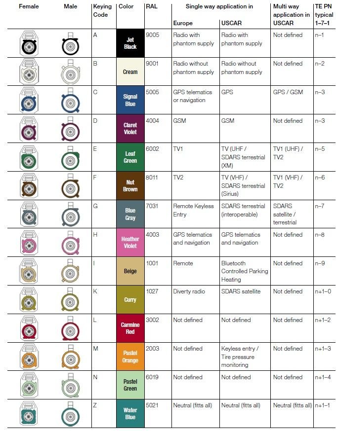

Thank you a lot BOTUS!🤗Will try and share the feedback. Just for clarity as I am a learner only: the GPS disconnection takes place at back of the comand. Correct? As per photo in a thread. I hope the photo depicts the NTG3 version that I have. Then the battery: my car has 3 batteries. One next to engine, one big behind the rear seat and a mini one under the dashboard. I guess I should disconnect the big one. Correct? When I got a car the big one needed replacement and I did it by removing the back seat cover from the trunck. But it was very difficult to put it back. Is there an easier way to disconnect this battery? Oooh, I see that you already described the location. I will check if I can locate the exact spot.

GPS is about the only plug all manu manage to use the correct colour for... blue is GPS - last link in my first post shows the back of both units

This fix worked for me, with my Jap Spec S500. It now shows the ‘correct’ time in Abu Dhabi after I pulled the GPS plug and then disconnected the battery at 1159 and then plugged it back in again. Of course, If the battery ever goes flat, or is disconnected for service, I will have to reset it all, but it is a quick and simple fix now…. Good luck
