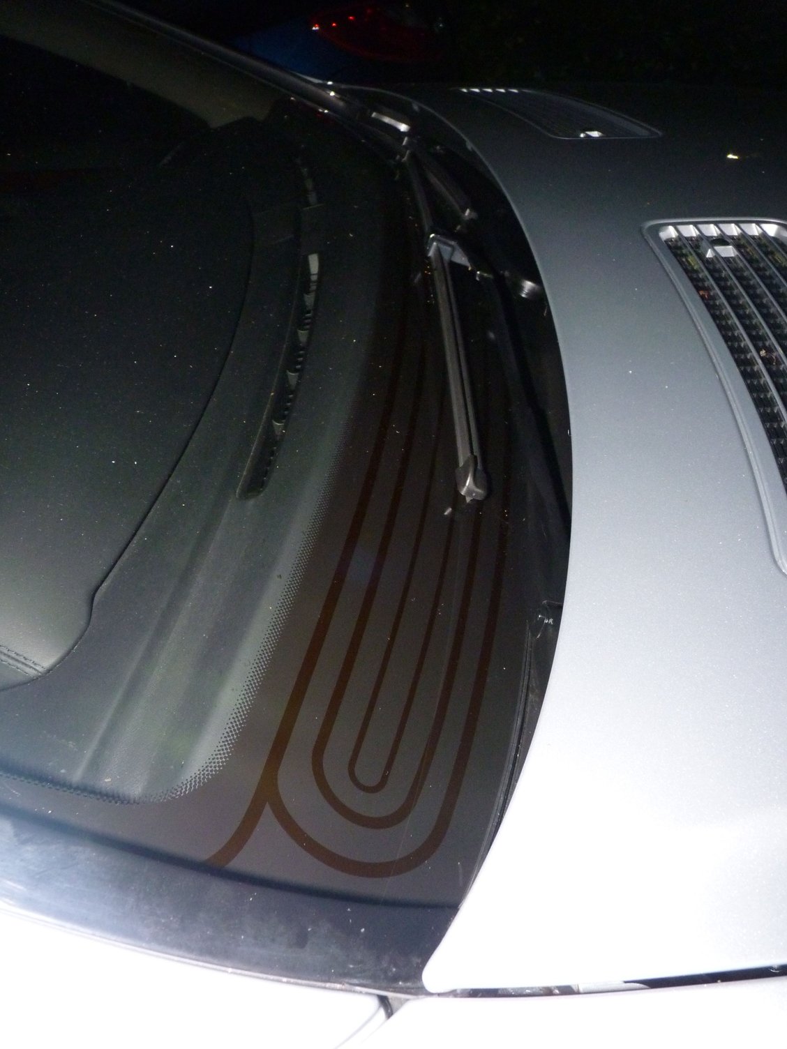

Mine has an element that goes all the way around the edge of the front screen with lots around the wipe blades in their parked position and then around the rain light sensor - on mine if the front screen was iced up, at engine start up I always noticed the element heat up fast way before the engine coolant heater had a chance to do anything - I NEVER use the front demist button.... (so I doubt it can be this that switches it and when I try it doesn't work)

not confident its STD - where fitted the OEM screen has the lines you just can't see them - until its frosty and working - the photo is off a replacement Pilkington JOKE - elements where its meant to have cut out to allow road toll thingy and a sat nav to get a signal bottom middle of the screen were not noticed when these global muppets copied it

you can see on the std one once you know where to look - but its far harder to see than the replacement one I used in the photo - not sure if its std on mine coz of night vision... these have a heater element to stop it misting up where the camera is. the big lines run around entire screen edge with lots where the wipers are (as you can see on mine)

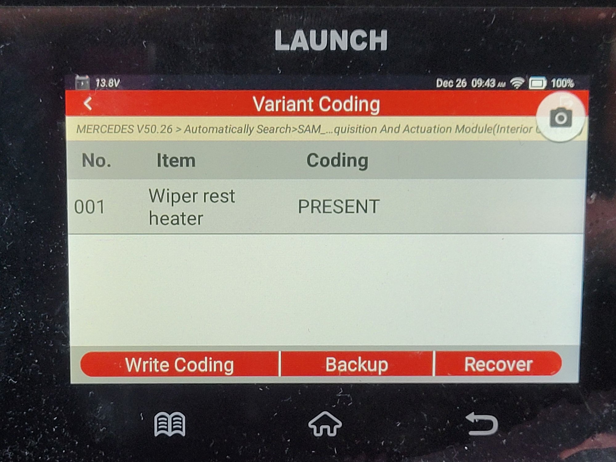

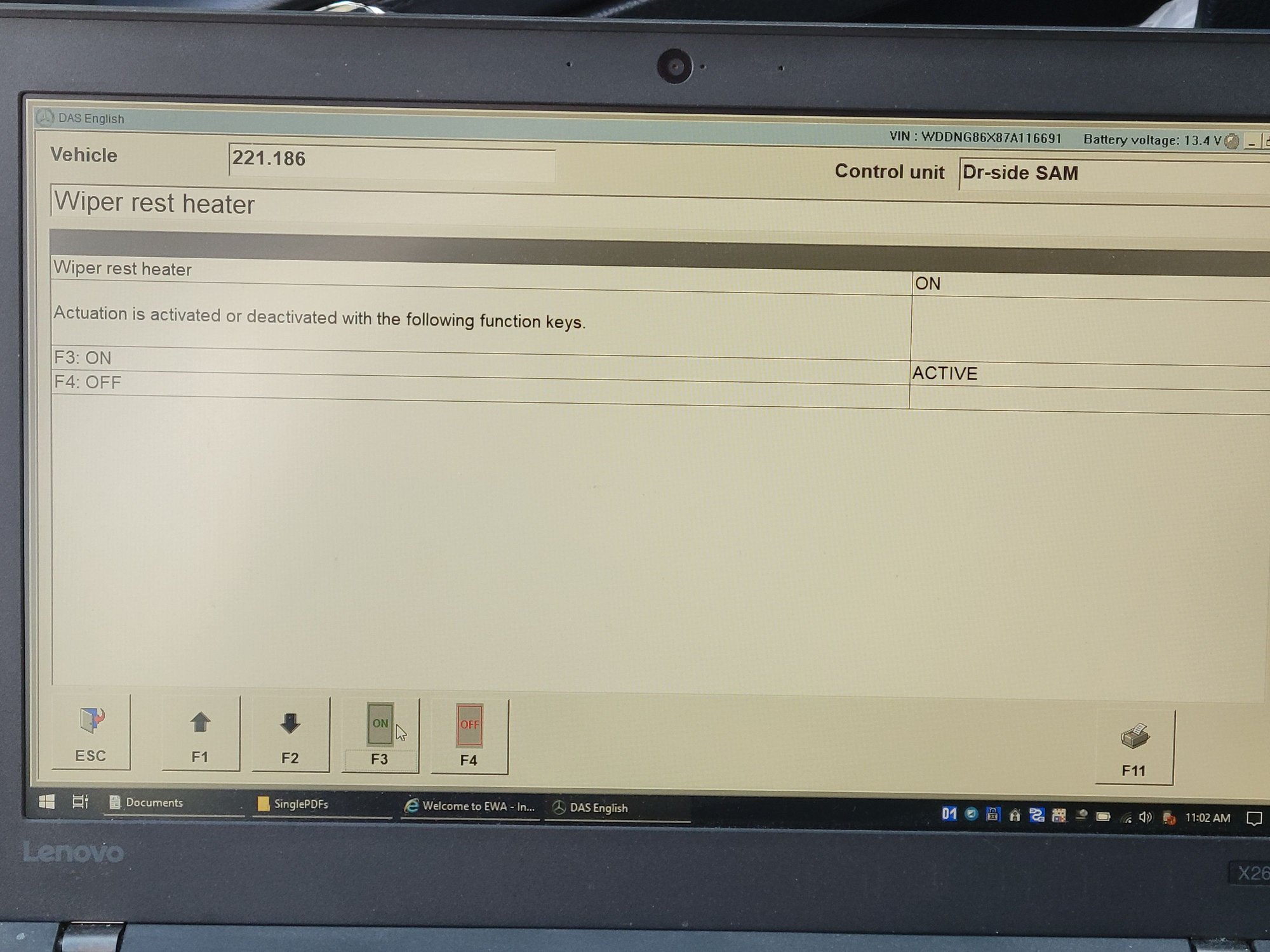

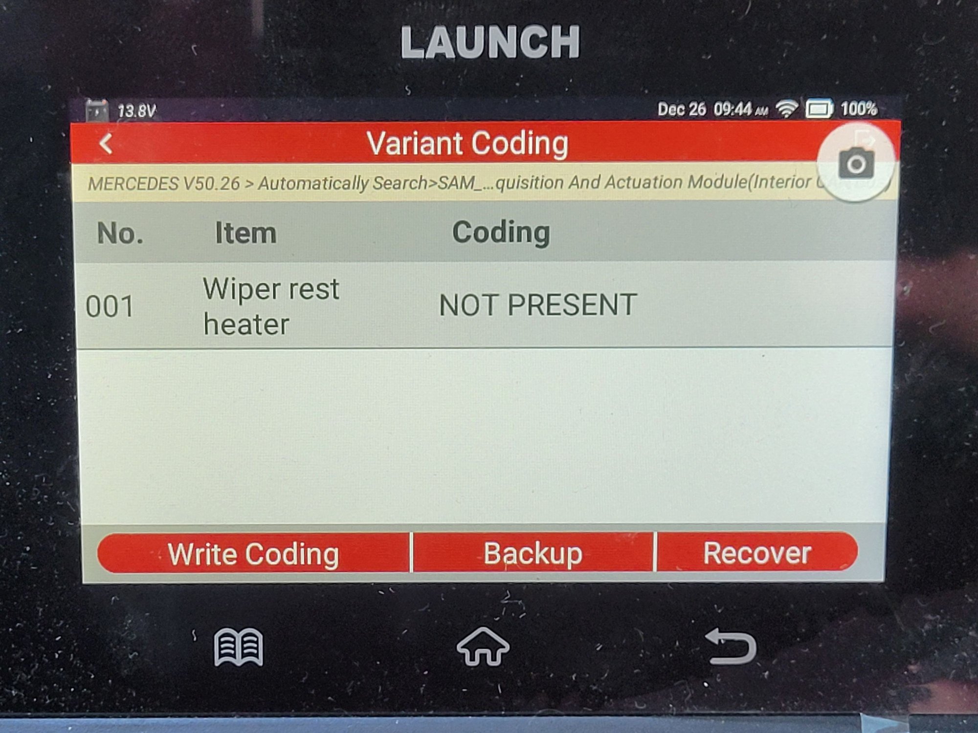

I coded it off with the Launch x431 Benz easily and verified via DAS that it is actually disabled. The Launch was not able to show the status of the coding for whatever reason. But I agree it looks possible to code via DAS.
