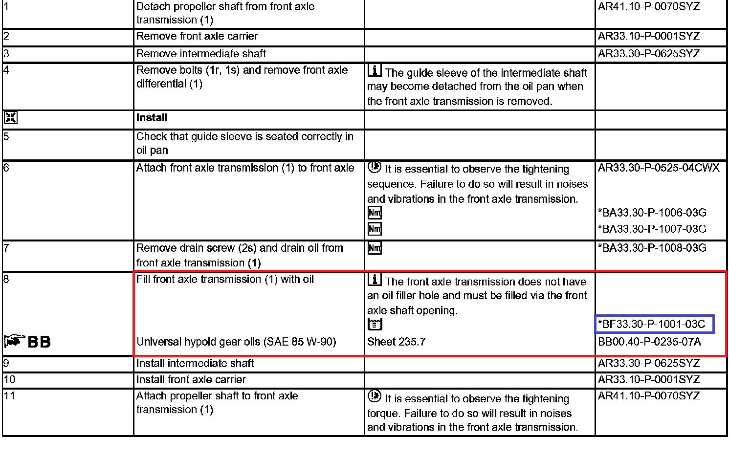

Im thinking even if there were a fill plug on the side of the differential there is really no way to even access it easily with the subframe in the way. Would have to drop the subframe to get to it, and the cv axle has to be removed to drop the subframe so why not just delete the fill plug and Mercedes says to fill thru the cv axle? The W221 and the W204 are very similar to each other, they share the same cv axles. The W204 parts diagrams do not show the separate part numbers for the boots so I got them directly from the W221 diagrams instead.
In the repair manuals they have procedures for checking/refilling the rear differential fluid but I cannot find one for the front differential. The rear differential is wide open and easy to work on.
The only notes im finding that mention filling the front differential are in the procedures for axle or for the pinion gear below:

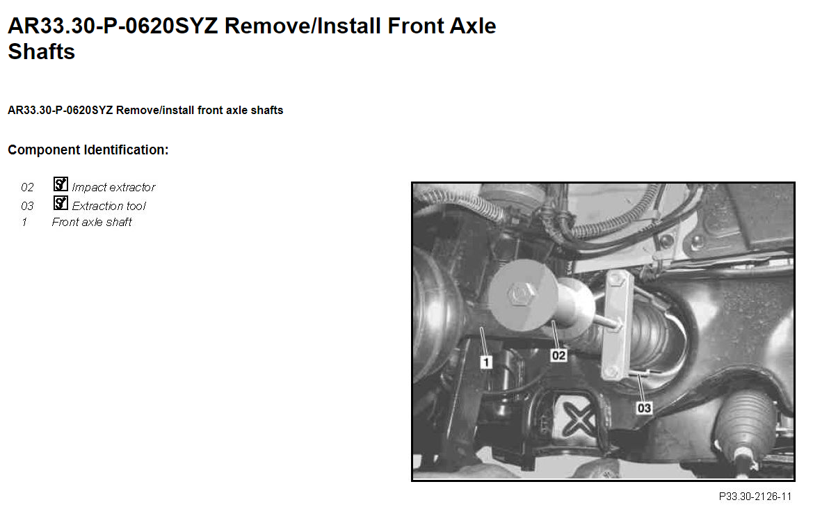

Heres a diagram/photo showing the differential with the subframe removed. I think that is the engine mount hanging above.
Now heres a diagram/photo showing removal of the passenger cv axle. The subframe is completely in the way of the diff.
If the goal is to just replace the front differential fluid i think draining then pumping in the new fluid is to best option. From searching around it looks like the fill capacity is 0.6l. The very odd thing is in my Operators manual it says the front differential capacity is 1.1l, which I think is totally wrong. When I drained my front differential I measured .7l of old fluid. I could not see any signs of leaks at all. So I measured out 0.7l and then pumped in a little more to compensate for anything that dripped out trying to screw the drain plug back on. The cheap fluid pump I used is pretty good, it sucks up all the fluid and will pump it all in, then will keep pumping in air. There is supposed to be some type of vent at the top of the differential so I wasnt worried about it.
When i did mine I used quick connects on the hose, disconnect it when done pumping to keep the fluid from draining back out. I have since bought a few inexpensive 1/4" barbed shutoffs which work great. Used one when I serviced the transmission.

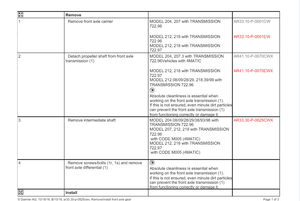

One of the reasons I like coming on here is to try and figure out the issues other people are having in case I ever have to deal with it. Most things ive never dealt with or even heard of before. So i just search around.
Here is a link to 2008 S550 4matic repair manuals I look at: https://charm.li/Mercedes%20Benz/200...%28273.968%29/

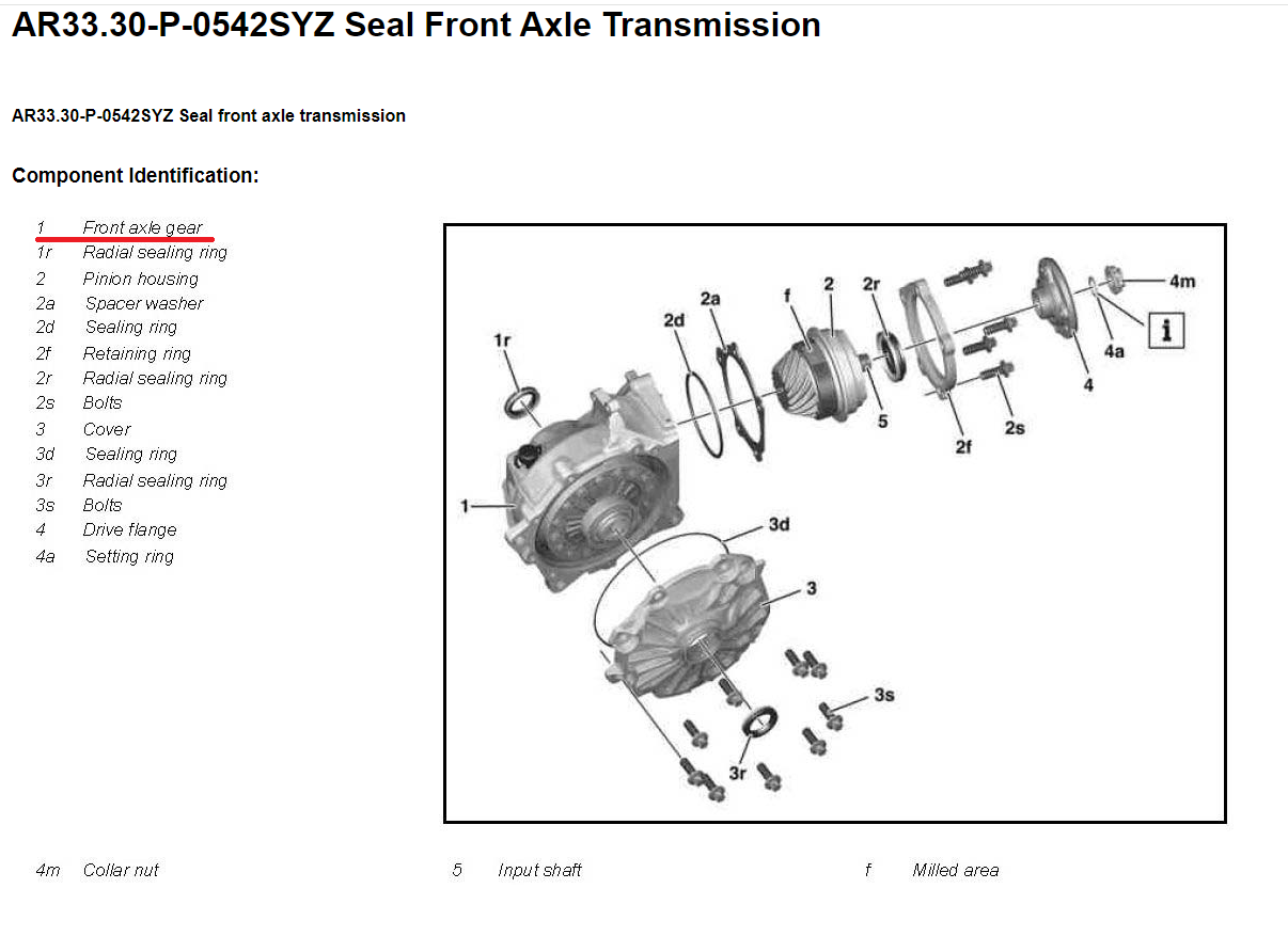

It looks like in order to open up the differential it has to be removed. Have to drop the subframe to access the bolts to remove it from the side of the engine. Its only held on by 3 bolts, just cant get to them with the subframe in the way. Looks like Mercedes calls the front differential the Front Axle Gear.
Even if you could access the 3 bolts to remove them the differential still wont drop out since the subframe is in the way. Guess the engine could be pulled but that is probably much more work involved.
I had to search around online for removing the axle gear AR33.30-P-0525CWX
I dont have much experience with transmissions and differentials but im thinking the condition of the old fluid would give a good indication if something was wrong, metal in it. i recently replaced the fluid in my transmission and it looked good to me, i even took apart the filter to inspect it and while it was dirty i didnt see any obvious signs of metal.
