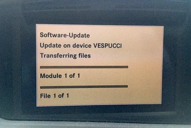

what you say almost doesn't make sense - till I figured you may not have Sat Nav on this car. If you have Sat Nav you shouldn't be able to set the time or date....
Re. your concern about "missing" updates - nope its far more likely it never had it - so long as the battery had never been off the car the year was remembered
1) did you actually go back and see if the date you set worked... you can play but it should never accept the change...
2) the clock can play games and sometimes seems to work - usually getting more confusing if your area uses daylight saving and you are in saving period
please check if the date you believed you set actually happened (I expect not) if it did do you have Sat Nav on this car?
another bit of fun was the car outside when you were working on the car ? (if in a deep well constructed underground car park you'll sometimes temporarily get get other results...)
All this fun came in April 2019 when a WNRO event came about and the satellites that provide the cars time and date info went round a 19 year silly cycle - ever since the car misinterprets the info the satellites are now giving - but it can be fixed !
que lots of fun where you don't have the kit on any PC in the house - the dvd drive is worn out on the car - or you don't make the update Cd correctly
a small patch to update the comand unit (in a 8 minute fix) was made by a forum member Polar Bear... then I fixed a small bug stopping a number of mid 2008 comand units updating, in a later Cd
read posts from the following link
#135 - making a Cd
#264 - all the info and the later .ISO file to download
https://mbworld.org/forums/s-class-w...ml#post8468441
ENG Menus
get in the car and turn on the key (it can ALL be done with it running - they flatten batteries in seconds on these cars otherwise)...
move the comand cursor (which Icon is highlighted) on the top menu bar that reads Navi, Audio, Telephone, Video, Vehicle,
use the control wheel to select Vehicle. Then pull the control wheel to the bottom menu and highlight System Settings
now these four all have to be done together
o Press and hold the “*” button, which is referred to as the “Favorite” button and typically actuates the rear sunshade.
o While holding “*”, press the Control Dial to the Right without pressing it down or turning it.
o While the “*” is pressed and the Control Dial is held to the right, press the Seat Massage button to the right of the Hazard switch and hold it.
o While holding the “*” button, the Control Dial to the Right, and the Seat Massage button, press the Mute button, which is the button located below the VOL dial and has an icon of a speaker with a slash.
 When this combination is performed successfully, you will have reached the Engineering Menu.
change NOTHING other than instigating update if you have fitted the right clock fix CD in the drive - but you can safely scroll round to look at everything
the back arrow key (one of the buttons around the comand knob switch panel), or key on off, will take you out of the ENG menus

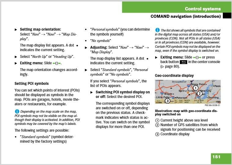

..that question likely comes round to are you running NTG3.0 on last software for the comand, or the later NTG3.5 - July 2009 build cars moved to the later better lookalike comand system...
if the earlier NTG3.0 system - of the selectable options when using Navi (along the bottom of the screen) - one is to show the number of satellites available (picture below shows 10 visible, I usually see 7 in S-East UK) - whether this option exists on the early iterations of scrambled jokeware the car was sold with I don't know.
Certainly if you go to map views and see if it displays "Bird's eye" view option, aka leant over proper 3D display - showing sky at the top of the screen. Then its running the last comand update - then you definitely get "show the number of satellites available" or "GPS coordinates" or the useful "time of arrival" (plus that update that gives tweaks to, or in USA turns on, delayed traffic info services.
see section bottom right (point 2)
