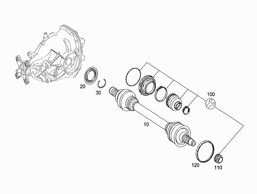

Originally Posted by kn51
In DAS there is a procedure to click on to reset the damn thing. Forget what it is called, "recalibration" or something similar. It is about the only way.
When replacing the abs sensors, hose down the hole with brake cleaner...also cleans the sensor ring of crap.
nope, sadly not - its magnetic gunk and can only come off wiping thoroughly - which means its got to be stripped down
rear - impulse ring part 120 - on an early 221 071
120 IMPULSE RING LEFT 001 A 23 035 701 82 - $10.82
120 IMPULSE RING RIGHT 001 A 23 035 701 82 - $10.82

Originally Posted by BOTUS
of course - I mentioned this in my first reply, the second and the third - the correct inner wheel bearing seal IS THE RELUCTOR that triggers the HALL effect in the IPC Amplifier at the end of the ABS sensor
BOTUS thank you for clarifying!
You very well may have said this before but I’m far from clever enough to keep up with the charming British banter and end up missing the info all together🤣
The link you provided for the parts led to a random page for a parts dealer but the part# don’t correspond to any MB genuine part #
If possible can you provide a genuine mb part # for the front abs reluctor rings?
I messaged Konigstiger but haven’t heard back yet (he’s the man when it comes to parts)
