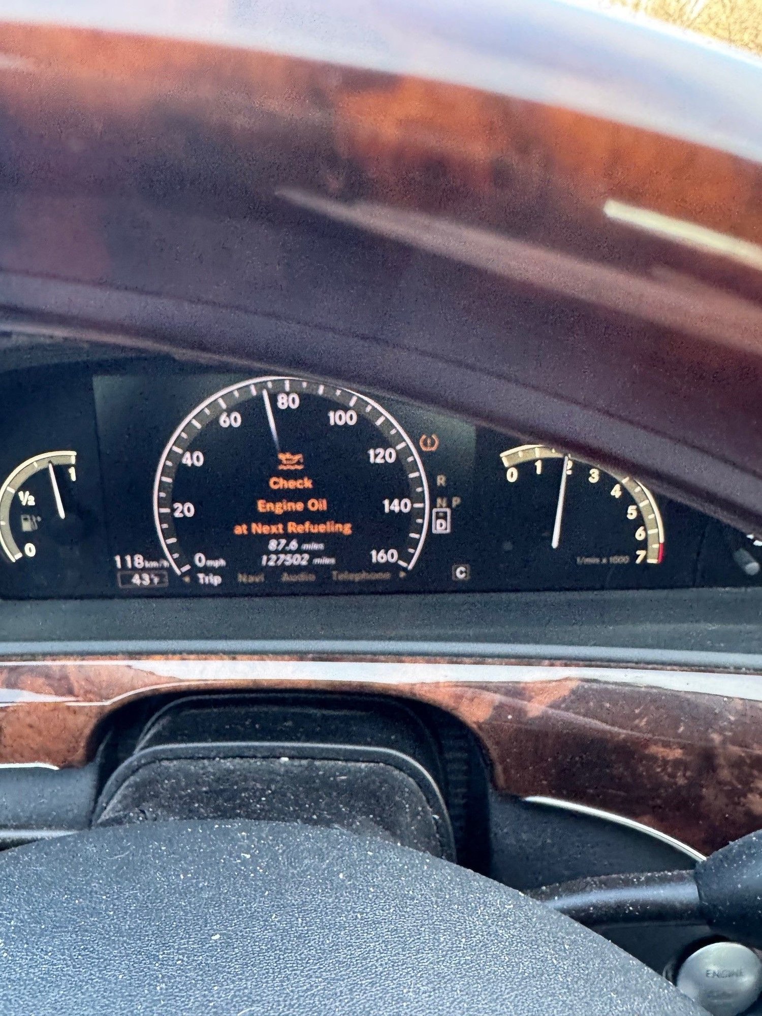

just got the message "Check engine oil at next refueling"
Oil level is fine after one year and 8K miles. Is this message on the dash based on the time since the last oil change reset? Gotta be that or I have a bad oil level sensor.

nope - it means it used a bit - and is saying top it up half a litre - main reason it does it the need to drive it harder (once warm) to get the rings to do their job
could check / play with the engine breather - but that only works too hard with bore damage or a lack of exersize

that’s exactly what it does - driven appropriately an engine in good condition doesn't use oil
as the oil ages in these engines I find a small quantity starts to escape past the rings and of the 12k mile 2 years recco interval all 272 V8s owners manual states - and the service reminder runs on (when using the better synthetic Merc 229.51 spec oils) - they can start to nag, give me 1/2 a litre after the 8k mile mark now and then - before that why waste an owners time saying oil fine - oil fine - oil fine - every drive?
in 35k miles and 9 years I've had to add in total 1.5 litres outside std 12k oil changes (and never had the nag come up before 8k miles - usually its after 11k)

So for the last two months while in Florida, I did my daily early morning oil check at ambient temp of 72 degrees F. It takes about 45 seconds using the dash selections. If the car is level, it gave me a good reading.
In the past when I have checked oil post engine warm up using the dash selections, it frequently gave me a needs oil indication on the dash. I thought maybe the indy shorted me on the fill. But no, it just takes some time for the oil to drain back down to the bottom end of the engine.
I also had some minor problems with the car not being perfectly flat. Just a small tilt gave me a low reading warning. If I moved the car to a different part of the tarmac that was truly level and flat, the engine oil read OK.
The M275 holds 9 liters of oil. Even two liters low still leaves enough oil in the engine in a pinch to operate safely. There is no dip stick. You can purchase one at FCP Euro but I just use the dash selection.

On the dash at the bottom of the speedometer large dial are selections: Trip Navi Audio Telephone. If you use the left steering wheel buttons for left and right arrow, the next set of selections are: Service Vehicle Settings. Select Service by using the OK button on the right side of the steering wheel, and use down arrow on the left steering wheel button to select Check Engine Oil. The dash will give you instructions to either wait (ostensibly if the car is not at operating temperature) or it will check the oil and say Engine Oil OK or Add XX.X liters at the next fuel stop. Other choices in Service include ServiceAssist which tells you the next service (A,B, C,D.E) is due in XXX days.

I also received this message yesterday on a 250-mile trip. Every time I turned off the engine and started it, it appeared after a few miles.
I don't know/am not familiar with how to access the oil pressure display check mentioned above, and what was my surprise when, after I opened the hood, I didn't see anywhere a dipstick for manual checking...?! After a quick look on the internet, I saw that the place to check is located at the back of the left side of the engine, and there I found that there is a plug in the pipe and it is pushed in, so it cannot be removed with fingers/hand in any way.
Oil and filters were changed 2200 miles ago...

No dipstick for oil. You have to use the menu in the Service tab of the instrument panel.
I think you found the dipstick for the auto transmission fluid. If it has a red locking tab, that is transmission not engine oil.
