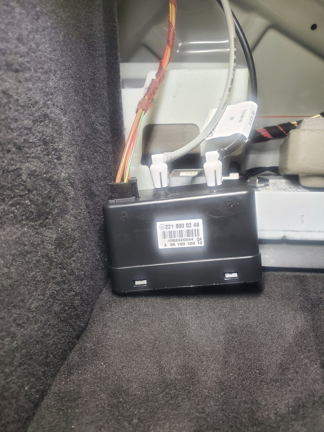

Hello all, after searching the forum regarding why my lumbar support and headrest retract button does not work, I fixed three broken air lines I found (two at the back of the front seats and one under the driver's seat). That did not fix the problem. I decided to check the pressure from the lumbar pump. The air pressure coming from the right connector was very faint, hardly enough to move a piece of paper. Is this normal, or is my pump defective? Thanks for the help.

open the black box - its a little pump that might be serviceable - check ebay for parts
those crazy white connectors pop off - but you need more than two hands - lever up / apart each finger

I took your advice and opened the black box, cleaned up internals and retested. It now appears to rotate at a higher RPM with a slight pressure output improvement. This did not fix my issues.

might be serviceable - didn't say try and clean it
you need to change bits like this https://www.ebay.com/itm/196068592236?
