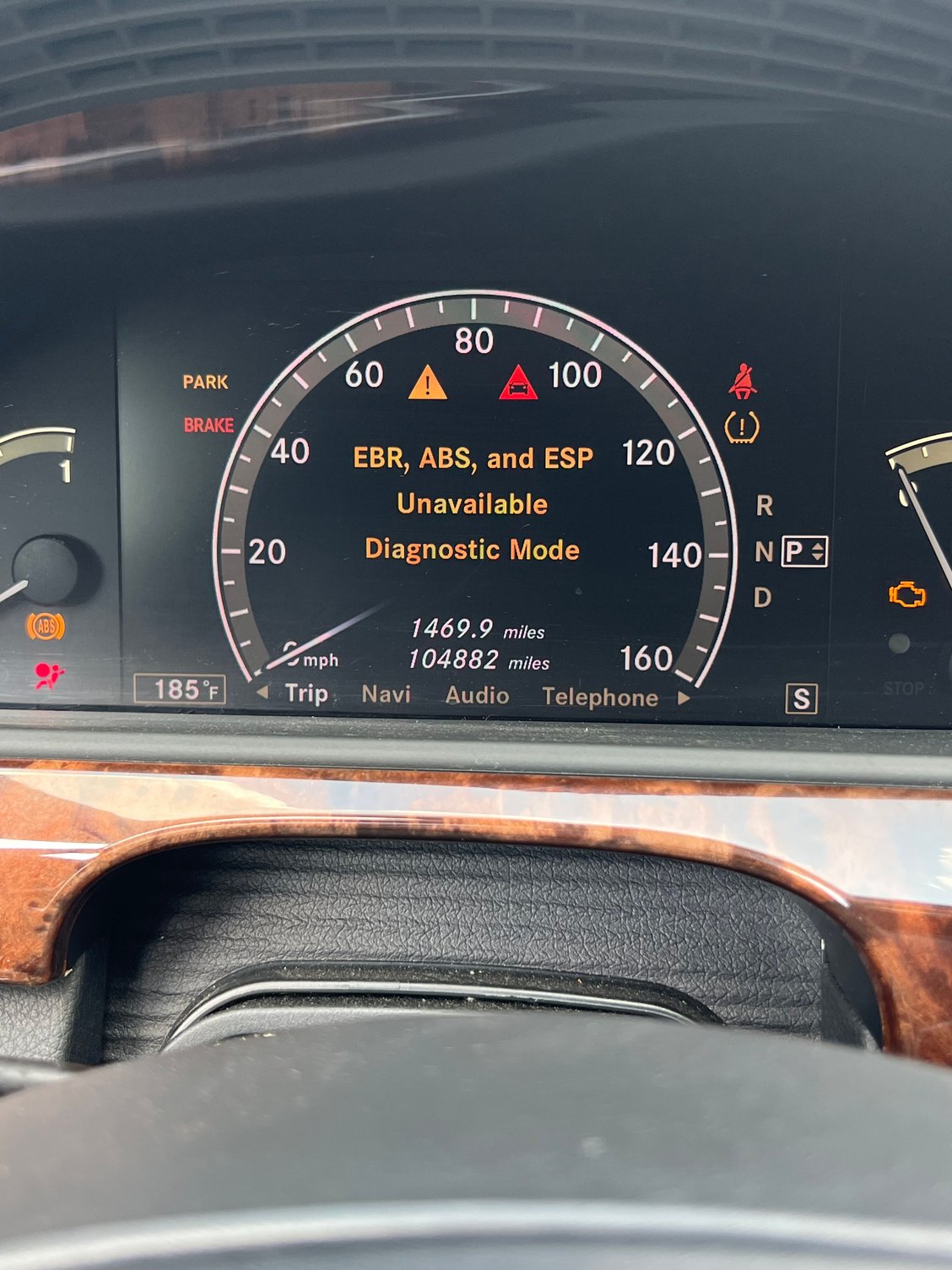

I own a 2008 S550. After accidentally jumping it with the key on, I'm experiencing no crank and no start. Both batteries have been replaced, the starter is functioning properly, but there's no communication from SAM. SAM, which is new from Mercedes-Benz, has power but isn't communicating with anything.
HELP!!!!! I’m thinking I need to get ecm reprogrammed?
