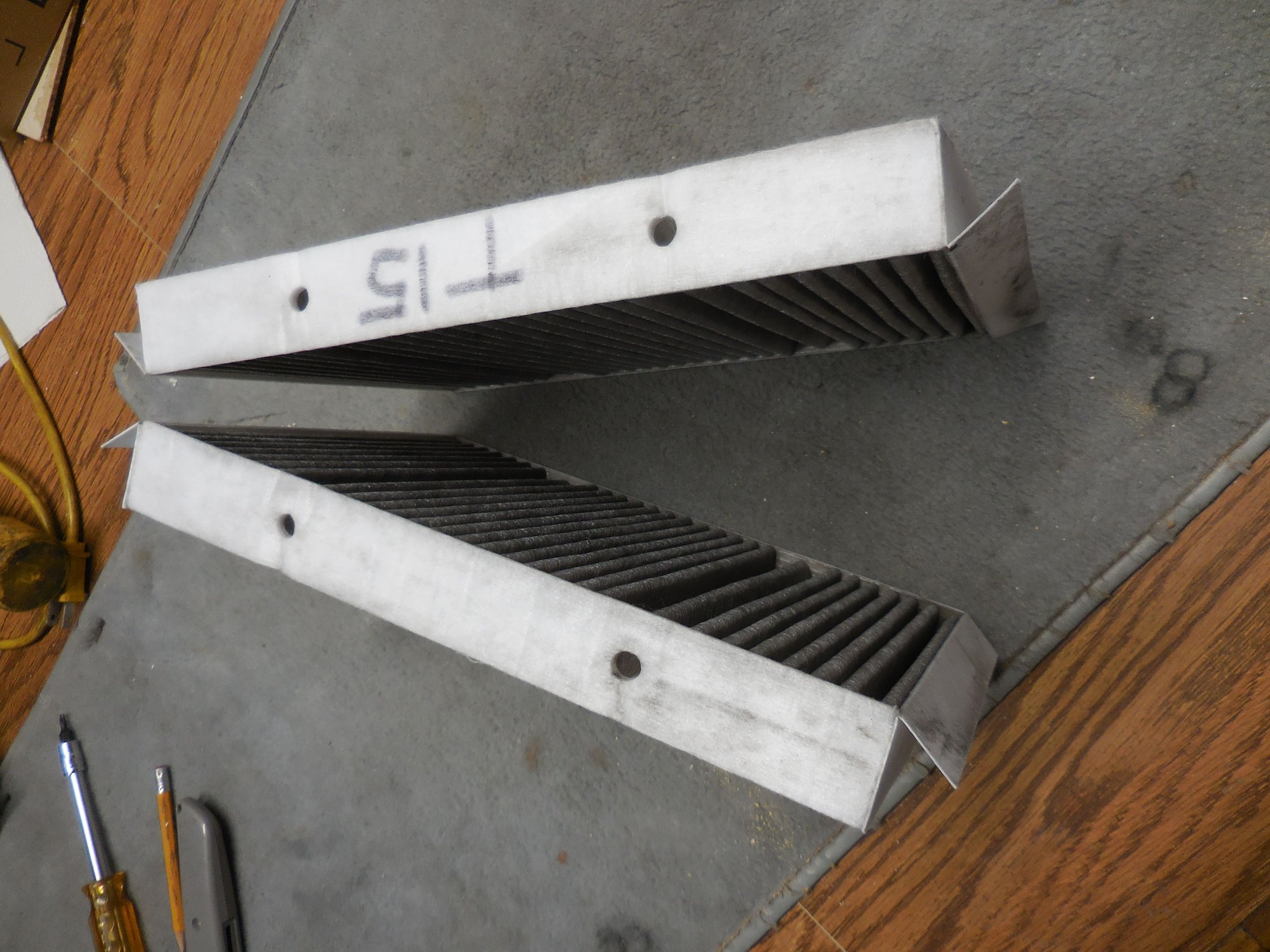

Ok, I've been working on taxes all morning, so my brain is mostly mush ... are the flaps in this picture in the correct alignment, relative to the "V"?
The PDF helpfully posted above says the arrows (and my aftermarket filters have arrows!) should point toward the blower, but where the hell is that ????
