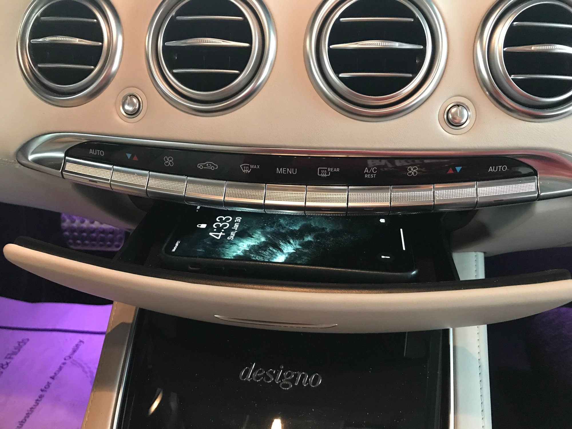

I just put in a wireless charging tray in my ashtray location
I don't think many people know this but you could have ordered your car with an ashtray or with a stowage tray. I bought from Mercedes for 68.00, a stowage tray and then a rubber cover mat for $23. I then ordered off Amazon for $13, a flat USB charging mat and a $5, 12V to 7W USB converter. I removed the cover in the bottom on the new tray, cut out the hole for the size of the charging mat, wired them into the OEM plug, where the lighter used to go, (without cutting into the factory harness). Now, I have a place to finally put my iPhone Pro Max and you can't even tell it wasn't from the factory. best 115.00. I've ever spent.

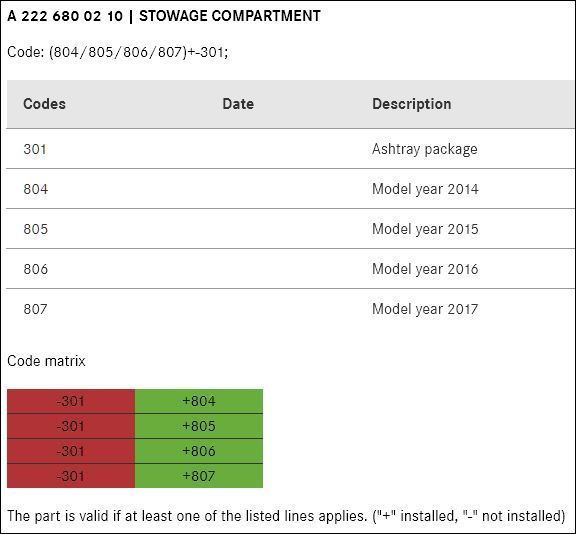

Some cursory Googling shows A2226800210 as the part number. Awesome idea!

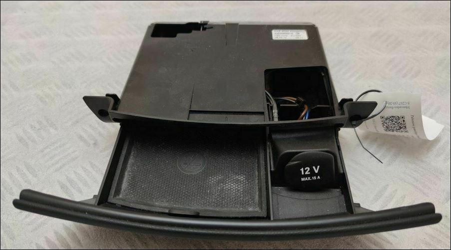

OP, how does the ashtray actually come out of the dash? Any fasteners to remove?

Two torque screws, one on each side of the unit.

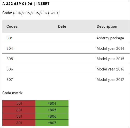

Stowage compartment without ashtray is part # 2226800210, rubber mat 2226890196.
Do you know if these parts also work for the C217 S550 Coupe?
Old Jan 29, 2022 | 02:18 PM
konigstiger's Avatar
Posts: 15,901
Likes: 4,630
From: North Scottsdale, AZ
'71 Pinto
Yes.

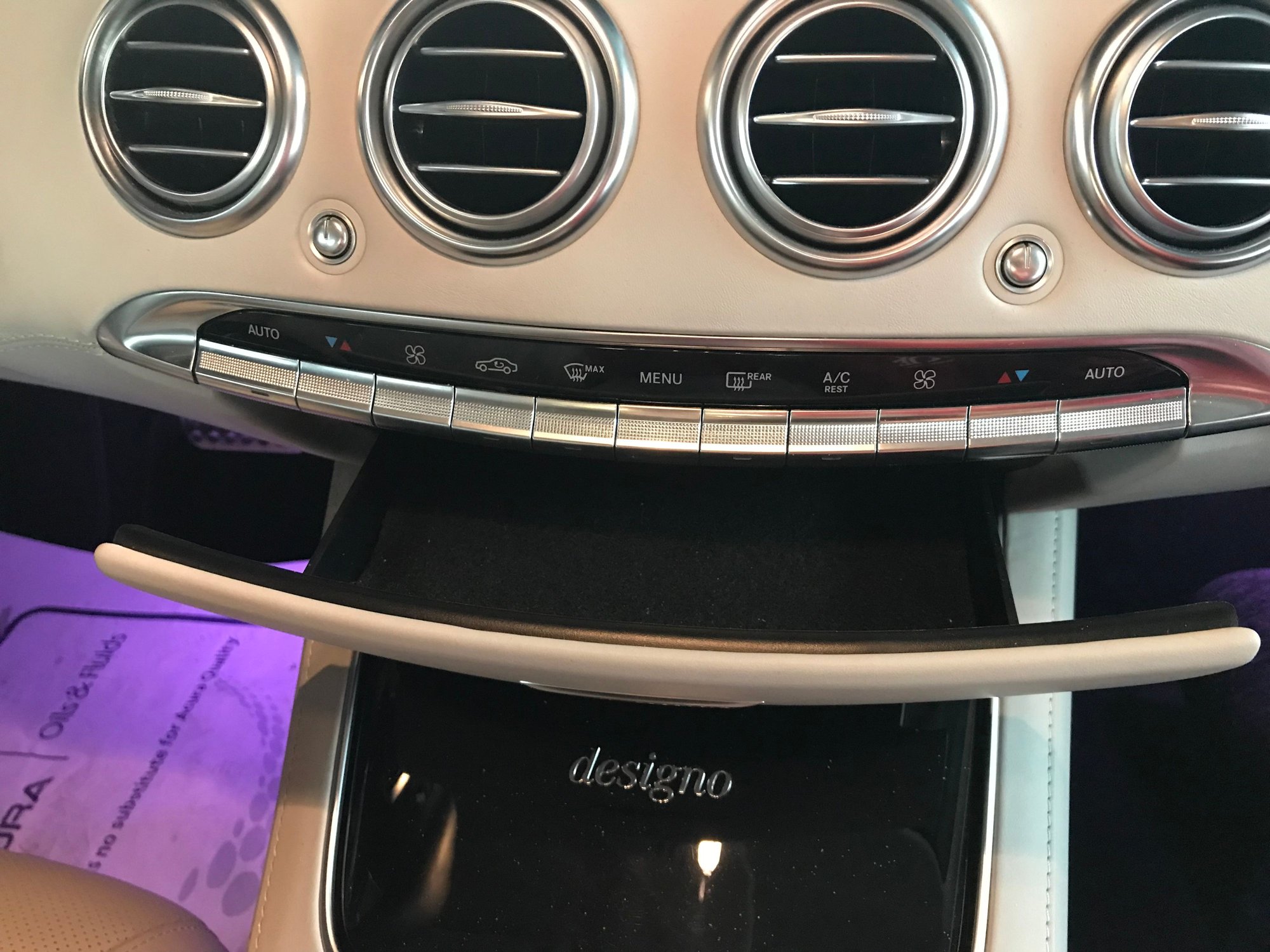

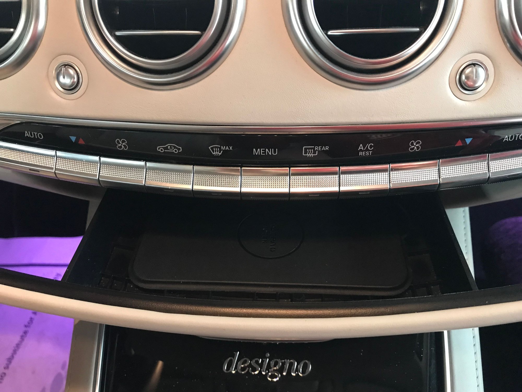

Here are three pictures. One with the phone, one without the phone and one without the carpet showing the charger pad. I didn’t go through the guy in EU. This part had been discontinued, which is against the law. Manufacturers are by law supposed to supply all parts for every car for 7 years, from the date it became obsolete. How Mercedes is able to get around this law is beyond me. It’s held in with 2 screws.
