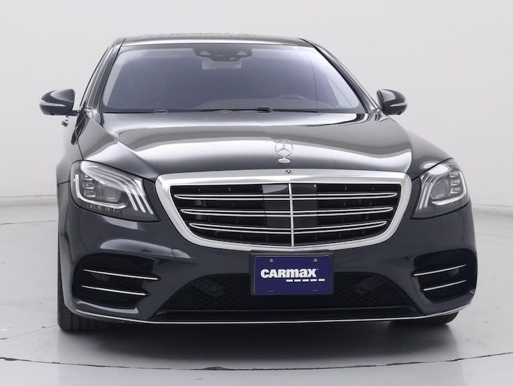

Having still never come across a MBC car for sale anywhere, I asked ChatGPT about additional differentiators.
The windshield camera dome would be the easiest tell from online photos. Can MBC owners confirm or deny that the sensor array is different from the non-MBC example in the photo below?
(of course it's also code 487)
Edit: it looks no different from this MBC example: https://thembmarket.com/2015-mercedes-benz-s550-1
Old Jul 11, 2025 | 03:02 PM
VII's Avatar
VII
Joined: May 2011
Posts: 975
Likes: 270
From: Fort Worth TX
2020 S560, 2014 SLK55 (Prev. 2016 S65, 2013 SLK350, 2008 CLS63, 2006 E350, 2006 CLS500, 2005 C230K)
ChatGPT....
You'd be better served asking an 8 ball.
And yes it's incorrect.
